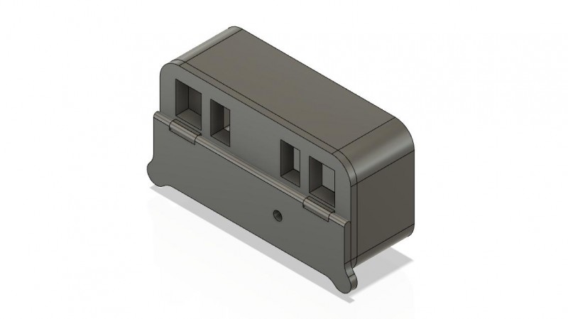

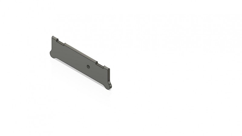

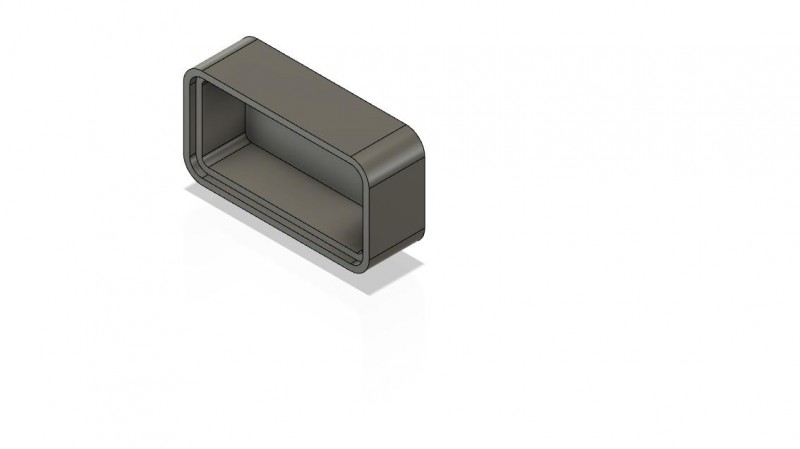

Re: Notek Light
Decided to attempt doing a simple representation of the rear Notek light. Some details like for example the four clips have been omitted but the user can choose to add them using a metal strip. The size of the unit including the face of the Notek light is 30mm long, 16mm wide and 10mm deep. I am not sure that this is a correct size for 1/6th scale as I could not find any info on the internet.
There is a choice of two faces. The functional face can be used if a light source is provided but the user has to provide his own coloured lenses. The non functional face can be used if no light source is going to be used. In this case the cutouts can be hand painted accordingly.
The flap is non functional. It will not swing up or down. The user will choose in which position to bond it to the face.

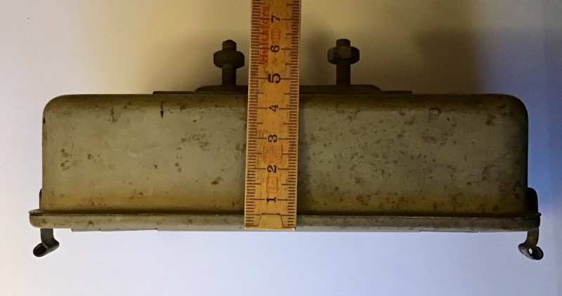

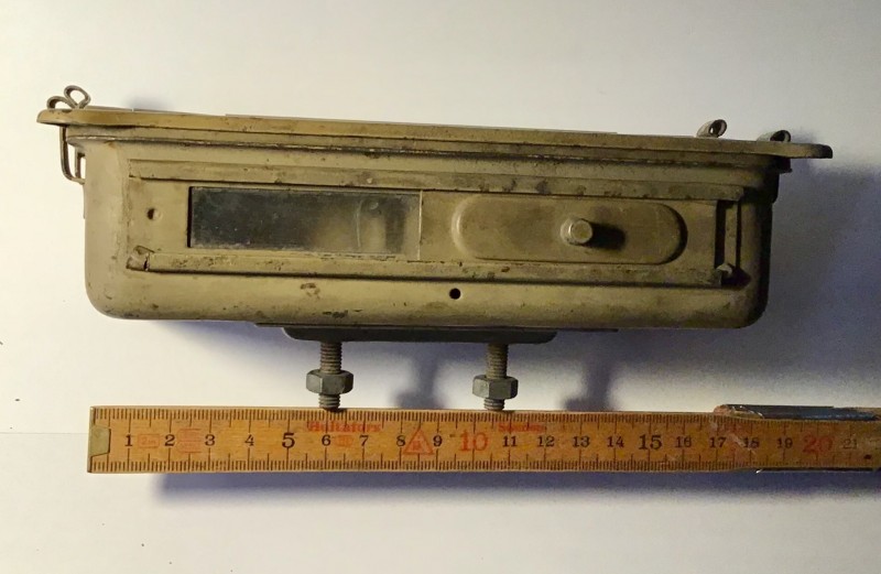

Re: Notek Light
Hi Vince,
I have a real Notek convoy lamp and here are some pics of it.
Hope they might be useful for you.
Kind regards
Kent
Kind regards
Kent
