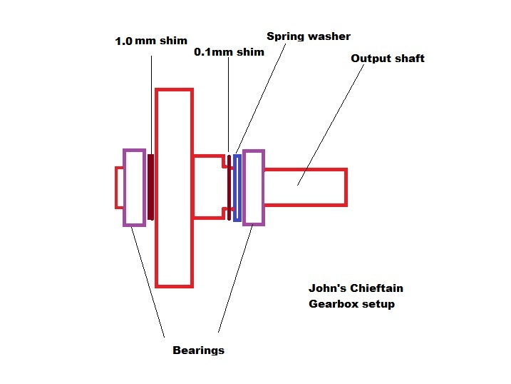

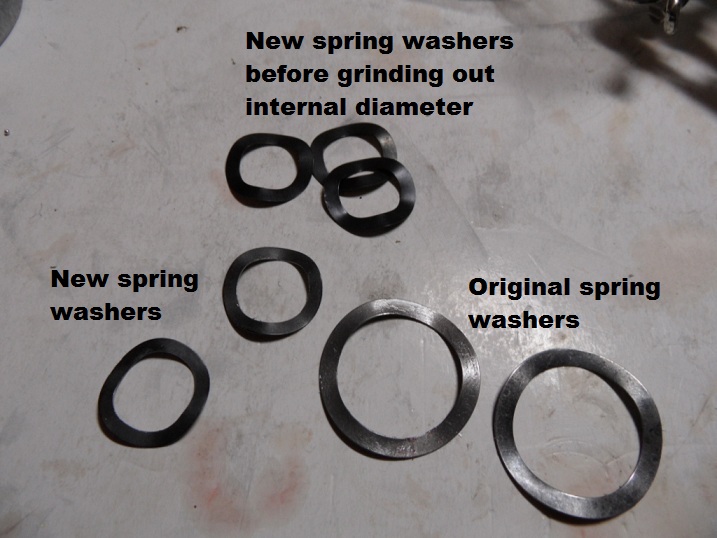

The Spring washers turned up the other day, so I've had a play around with the shims today, now I can fit the new spring washer in the place I'd rather have them.
I couldn't get the spring washers I wanted, 22mm id x 15mm od x 0.3mm became unavailable, so had to make do with 21mm od x 14mm id x 0.3mm, having to grind out a little off the id. Took about two minutes with a Dremel type hand grinder, genitally taking a little off the internal diameter at a time.
The dynamic has changed a little, measuring up the crown gear a little more accurately, finding it closer to 1.5mm tooth depth. Thoroughly cleaning the old grease out of the gearbox, it was important to make sure the bearings were seated properly, since small differences could cause an inaccurate setup.
During setup I ran the motors on 6 volts to makes sure the high voltage didn't obscure gearbox noise. I'm sticking with the 1mm shim previously used with a 0.1mm shim in front of the spring washer. See picture.
All seems well now and feel that they are both gearboxes are as good as each other, after packing with grease I measured a tooth mesh depth came out at around 1.25mm to 1.30mm. Both gearboxes are smooth and quiet in forward drive a little noisier in reverse but not much.
The benefits are that the spring now spins with the shaft, bearing and gear, The bearings are now fixed in position and I think I've maximized the potential of the gearbox.

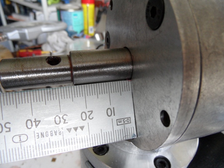

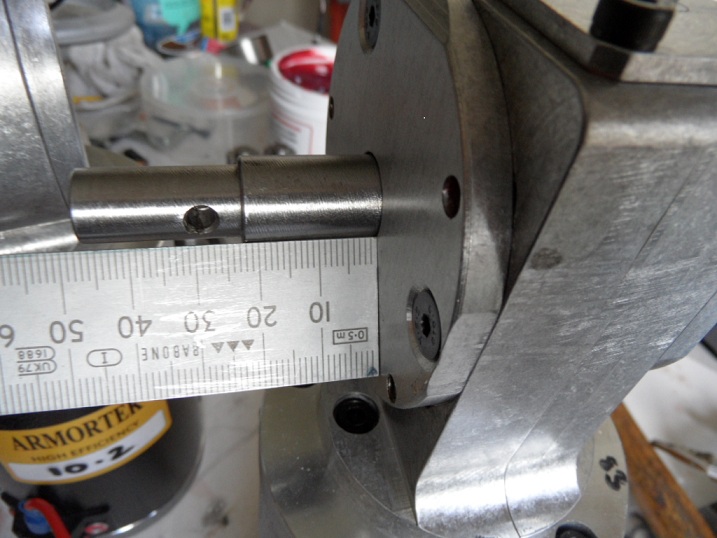

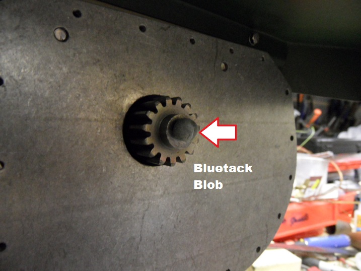

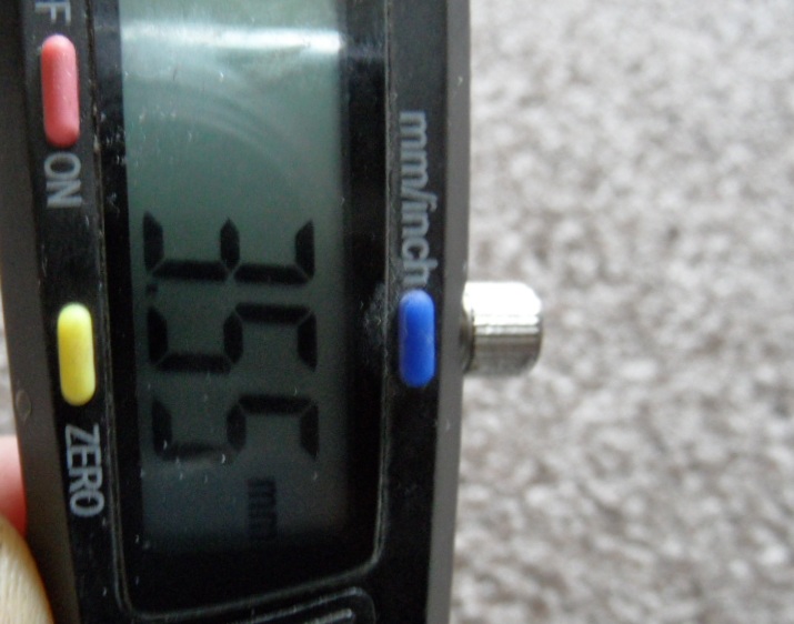

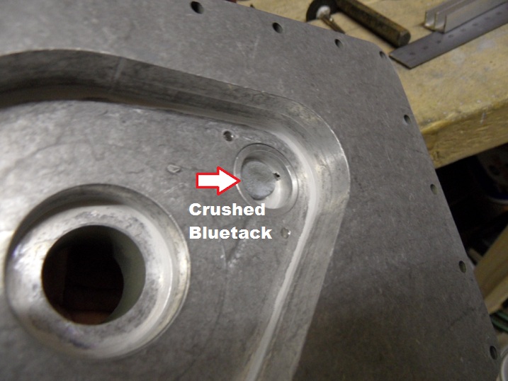

Time to squeeze some bluetack, as described earlier I want to find out how much of the extended pinon shaft sits in the outboard 5mm deep bushed gearbox housing.
So I've used this simple test, shown in pictures below.
The first Gearbox is the left hand side, where the shaft was shimmed outwards by 1mm.
Squeeze
Originally the extended pinon would have been sitting in the bush about 2.5mm deep, with the shim fitted in the gearbox I now have 3.5mm of the shaft into the bush. I want more.
I'll machine at least 0.5 mm off the motor gearbox mounting spacer so that I'll have at least 4mm of pinon shaft into the bush.
The right hand motor gearbox should be more fun, the shimming on that gearbox moved the shaft in the opposite direction.

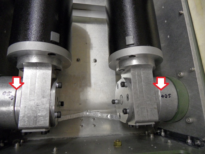

I must say after shimming the gearboxes I will need the use of a lathe, to make sure both output shafts are the same length when they are present in the models outboard gearboxes.
I'll be removing a little off the motor gearbox spacers, 0.5mm off one and 2.5mm off the other. That will give me at least 4mm of pinion shaft penetration into the 5mm bush as previously described, that's important to me here. :wink:

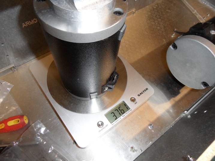

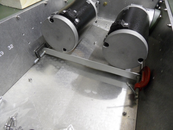

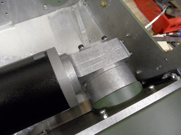

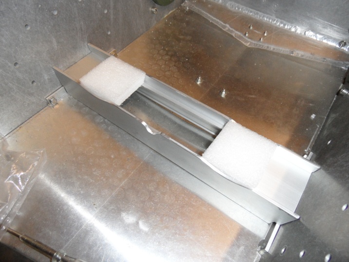

I've begun to work on the X plan, each motor gearbox weighs just under 4 kg, this weight is supported by three mounting M5 bolts at the gearbox end. Rotational movement will put stress on these support bolts, this rotational force is going to be balanced with a simple light weight bracket.
It would be a lot easier with a flat belly plate though. :roll: :roll:

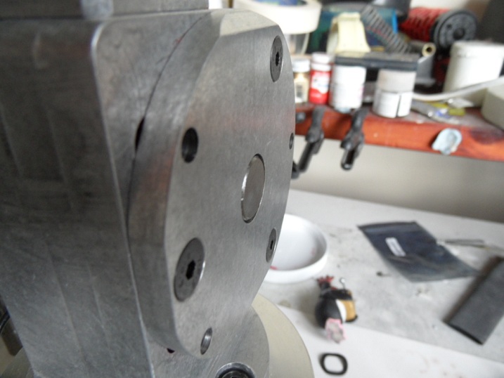

Well pilgrims the spacers have been machined, the space, gaps and alignment all seems Apple pie 8)
I wasn't happy with first motor support bracket, So I've made another which is far more supportive.
The problem with the support bracket is that it restricts space around the terminations underneath the motors.

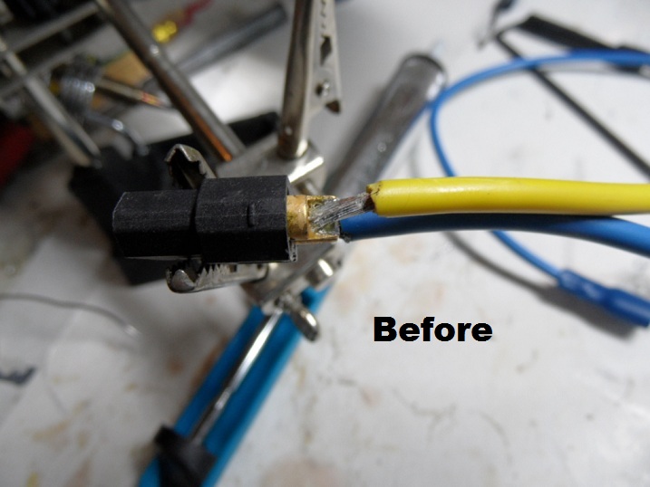

So the motors have to be connected up before fitting, thought it prudent to check the terminations :cry: because I've had a few problems.
Easy repairs though :D I'm doing this with every soldered joint as part of my reliability program.
The wires were de-soldered from the plugs then re-tinned and re-soldered and new insulation shrunk on.

I struggled to find M15 ID wave washers. I did have some ordered from the USA, but they canceled.
So I brought 10 x M14 for just over £1.00. Guessing there'd be a little bit of clearance on M14, gently grinding out enough material with a dremel type tool to clear 15mm.
