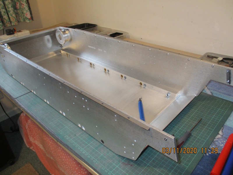

Hello Phil and StuG builders' everywhere, thank you all for the welcome. Made a start over the weekend, here in wet and windy Wales we have been in 'lockdown' 'firewall' etc,.for a week.
Still trying to work out what this term means. I heard this on a local news broadcast, .....'lampshade'.
Anyway, cleaned the hull parts, this will be a 'slow as you go' build. There is a need to spread it over the Winter, I'm running out of dosh. My Haynes book arrived this morning from the Tank Museum. I like the alternative Zimmerit, waffle pattern....tasty....Mick

Good morning everyone, hull parts are a nice clean fit, enjoying this....Mick

Good evening everyone, StuG production line moving steadily along. As soon as we are out of lockdown on Monday, I will stock up on Upol and primer. Just on the issue raised by Steen, holding the lower hull plate and suspension bars in line until ready to fit the suspension I used a spare M6 x 35 CSK with nut, in the opposite Fixed End CL0222 position.....remove when ready...Mick

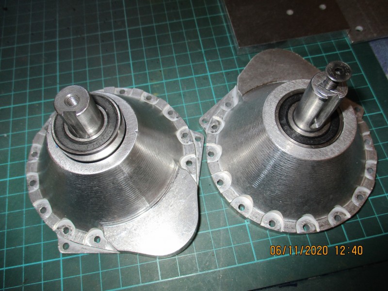

Hello John and good morning, you are so right....Phil and others are masters of the art, well worth following. Now you brain boxes :) I have a small issue, never before encountered on previous builds.
Reference the gear case CL0114, the driven gear CL0115 and the 6002 2RS bearings. I assembled one of the drive cases...no problem, smooth as a whatsit.
There are two bearings in the gear case...now, with gear case number two, the driven gear is clearly out of line when it reaches the second bearing and immediately binds, unlike the first gear case. I tapped the driven gear ( gently ) with my trusty lump hammer...which made the 'pick up' worse. Slight exaggeration here :roll: Should the bearings have enough 'give' to allow some out of alinement between the bearings. Just to add, The bearing fits easily into the gear case, the problem is the driven gear tightens on the inner bearing face until it locks and will no linger turn. I had used low strength loctite and was able to remove the bearings. My working life in the Ambulance Service has been no use whatsoever in this respect...
Answers on a postcard, etc,. etc,...Mick
The bearing on the left is about a mm out of line
Last edited by michael hilton on Fri Nov 06, 2020 2:02 pm, edited 1 time in total.

Thanks Steen...my first gear case aligned perfectly...it's number two gear case that's the problem :roll: mick

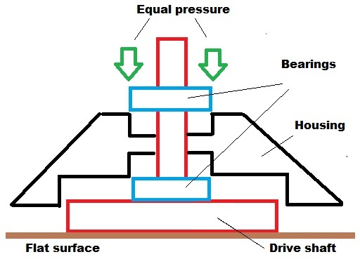

Posts: 1693
Been liked: 1842 times
Re: Mick's StuG 111
Hi Mick,
Tricky not seeing it in the flesh, but I can only think the bearing already fitted in the housing is slightly off line.
Remove the bearing from the housing, clean up both bearings and recesses.
Try putting the inner bearing on the drive shaft first (No loctite at the moment)
Then put the drive shaft through the housing without pressing the bearing into the recess.
Then put the outboard bearing onto the drive shaft and try and squeeze both bearings into their recesses using the drive shaft to align the bearings into both bearing housings.
You should be able push the bearings evenly into the housings against flat surface, while doing so, spin the shaft to make sure it does not lockup between the bearings. If it does remove bearings and start again.
If you have a 1/2 inch socket set, you can usually find a socket that you could use to tap the outboard bearing outer edge evenly and gently home. Remove the drive shaft and gently tap the bearing home, keep checking the bearings are aligned with the drive shaft.
Hope it helps.
If you ever have to wallop bearings in there is a problem
