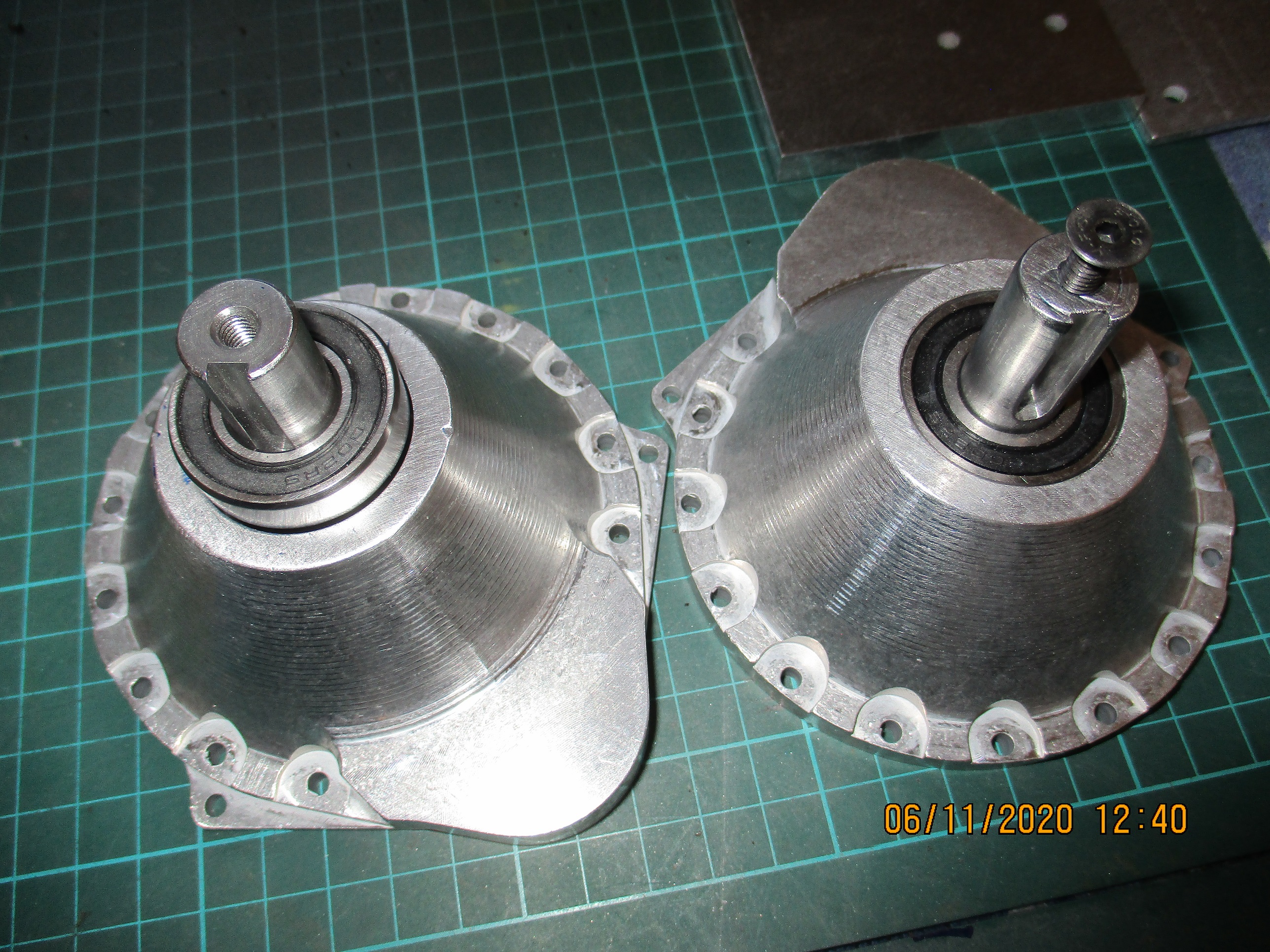

Re: Mick's StuG 111
Hello John and good morning, you are so right....Phil and others are masters of the art, well worth following. Now you brain boxes
I have a small issue, never before encountered on previous builds.
Reference the gear case CL0114, the driven gear CL0115 and the 6002 2RS bearings. I assembled one of the drive cases...no problem, smooth as a whatsit.
There are two bearings in the gear case...now, with gear case number two, the driven gear is clearly out of line when it reaches the second bearing and immediately binds, unlike the first gear case. I tapped the driven gear ( gently ) with my trusty lump hammer...which made the 'pick up' worse. Slight exaggeration here
Should the bearings have enough 'give' to allow some out of alinement between the bearings. Just to add, The bearing fits easily into the gear case, the problem is the driven gear tightens on the inner bearing face until it locks and will no linger turn. I had used low strength loctite and was able to remove the bearings. My working life in the Ambulance Service has been no use whatsoever in this respect...
Answers on a postcard, etc,. etc,...Mick

Re: Mick's StuG 111
Hi Mick
I do not have any issues with my parts. Everything is aligned perfectly

Re: Mick's StuG 111
Thanks Steen...my first gear case aligned perfectly...it's number two gear case that's the problem

Re: Mick's StuG 111
Hi Mick,
Tricky not seeing it in the flesh, but I can only think the bearing already fitted in the housing is slightly off line.
Remove the bearing from the housing, clean up both bearings and recesses.
Try putting the inner bearing on the drive shaft first (No loctite at the moment)
Then put the drive shaft through the housing without pressing the bearing into the recess.
Then put the outboard bearing onto the drive shaft and try and squeeze both bearings into their recesses using the drive shaft to align the bearings into both bearing housings.
You should be able push the bearings evenly into the housings against flat surface, while doing so, spin the shaft to make sure it does not lockup between the bearings. If it does remove bearings and start again.
If you have a 1/2 inch socket set, you can usually find a socket that you could use to tap the outboard bearing outer edge evenly and gently home. Remove the drive shaft and gently tap the bearing home, keep checking the bearings are aligned with the drive shaft.
Hope it helps.
If you ever have to wallop bearings in there is a problem
Hope it helps.
