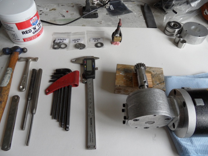

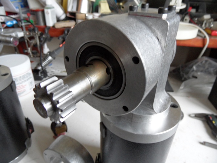

Operation time, I'm going to open up the patients, examine, measure, make a change if I feel I need to.
First, I wondered how much the gear teeth actual mesh together. Using allen keys, I'll released the rear cover until the gears fail to mesh and measure.
Wow 0.5mm.
Exciting.

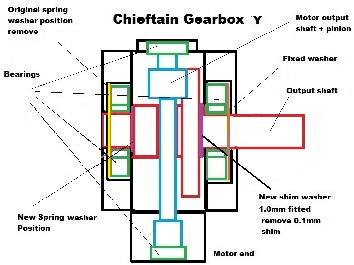

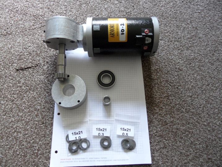

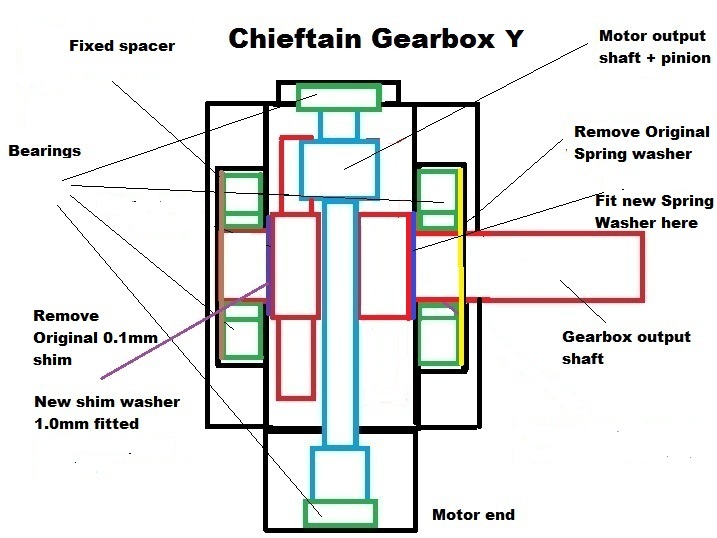

With the dissection complete, I see a simple amazingly small gearbox with some very nice components. 8)
I do see a couple of strange occurrences though. :?
First, on my gearboxes I seem to have a lot of end float. Through a process of elimination with various shims I found by removing the original 0.1mm shim washer and replaced with a 1.0mm shim washer, I now have the teeth meshing at around 1.5mm with a float of around 0.2mm.
Second, on my gearboxes I found that the large 0.3mm thick spring washer was set behind the output shaft bearing. This means the whole bearing has to float in it's housing to work properly, it could jam. I'll upgrade this part with a smaller spring washer same thickness in front of the bearing. This way the main bearing can be secured in the bearing housing with the full support of the cover plate and the smaller spring washer will spin freely with the output shaft and still do it's job.
Here's a simple rudimentary basic picture including my proposed changes, although both gear boxes share the same components they are not identical.
Actual chieftan gearbox2.jpg (91.09 KiB) Viewed 8483 times

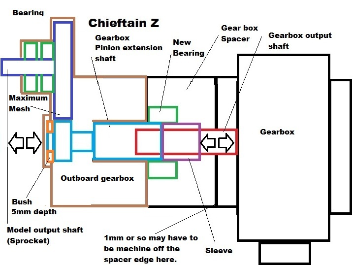

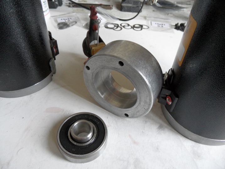

Onto plan Z upgrade, Tricky one this, If you don't have access to a lathe then this one could be a no show. It may be possible to get a local engineering company to do the job, machining and make up the sleeves for you. I've done this in the past when I wanted some key ways cut on another model.
Simply put, I'm going to add another bearing to add a bit more support and help alignment to Motor gearbox output shaft using the motor gearbox spacer. Parts required, Two modified Gearbox spacers,Two 6204 2RS bearings and two machined sleeves.
First, Machine the gearbox spacers to accept the 6204 2RS bearings, they should be slightly recessed ensure a good fit when it all goes back together.
The sleeves, the new bearing itself needs extra support as the bearing inner race spans two different sized shafts, 15mm gearbox output shaft and the pinion extension shaft 20 mm.
Once put together I had some concern over fitting the motor gearbox assembly, the spacer is physically fixed to the pinon extension shaft and cannot be removed without stripping down. But I can always release the inner "model" gearbox housing for wiggle room.
The new assembly all lines up and runs nice,
Unfortunately I won't get round to the X plan for a few of months.
But it's always nice t have a plan.(says the evil penguin)

The shaft end float appears to stop when spring washer is fully compressed behind the bearing. (This is as long as the bearing moves freely in it's housing/cover plate) if the beginning of the end float travel starts too early (ie the tooth mesh is 0.5 mm like mine were) then the end float appears to travel along way.
With the new shim I fitted, I think the end float on my gearboxes is now set to an optimum 0.2 mm ish because the gear teeth are already 1.5 mm in mesh before the end floats starts. When the new smaller spring washer Is fitted (on order) the end float will not have to rely on the bearing having to move. Well that's the plan.
I'll need to fit the new smaller spring washers when they turn up first before completely buttoning up the gearboxes.(15 mm dia spring washers are hard to find). :|
This type of gearbox can generate some noise in reverse, spiral gears do, think car differential, some what noisier in reverse. Forward should be reasonably quiet.
With the extra weight on Chieftains drive train, I think it will be essential for me get it spot on. It will be some time before my gearboxes are fitted and running, but they do now have tiny rotational backlash on the gearboxes you describe at the end of your post.

This last entry for a while hopefully shows the how the opposite gearbox differs from the gearbox already described and the changes on the motor gearbox output shaft lengths after re-shimming.
From what I've seen, and again we're depending on the build, the average depth of the pinon output shaft into the bush is around 3mm.
(The bush total depth being 5mm). giving a clearance depth of 2mm to the blind end.
If the re-shimming is around 1mm in each motor gearbox, there'll be +1mm added on to one shaft into the bush giving a 1mm clearance at the blind end, which is ok in my book. But -1mm taken from the other motor gearbox shaft depth, not ok, only 2mm depth into the bush. (3mm clearance to the blind end).
So I'm going to probably have to machine 2mm off one of gearbox spacer width to even up the pinion shaft depth into the bush on both sides.
Before all this happens, I'm going to have to prove depth of the pinion shaft into the bush. Using the old Bluetack blob trick.
Put a small blob of blue tack into bush recess on the blind end, offered shaft up in position and squeeze, remove the shaft and measure the thickness of the Bluetack blob, and proceed from there.
I must add, I'll be mounting the motor and gearboxes in the tank first, offering up the outboard gearbox to the motor gearbox pinon shaft. This way I won't have to worry about getting the alignment right with the heavy motor and pinon gear impeding the fit.
If all has gone to plan when the mods complete, the squeezed blob should measure 1mm approx, giving plenty of end shaft end clearance.
The more pinon shaft in the bush, the more pinon tooth area on the out board final drive gear.
I think I may have made it sound all a bit complicated, it's not for everyone, but step by step, it's straight forward stuff.
