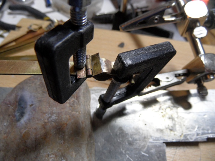

Re: white metal
Yves, if you're careful, you can successfully solder white metal. Use a low temperature solder, plenty of flux and an iron set to below 200 deg C. Don't hold the iron on the metal for too long or you can melt the whole thing. If you can, use a heat sink such as a G clamp to protect the part you don't want heated.
