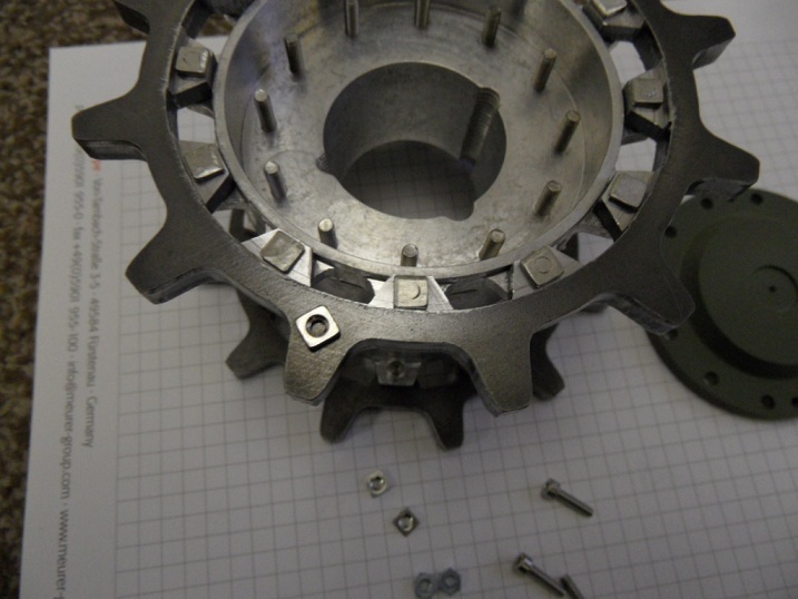

Drive Sprocket Bolts - has anyone come up with a nice square headed bolt or nut soultion for these do we know ?
They still need to be High Tensile Bolts so limited options for these but i feel they need to have a Flat head which could be Chamfered off a bit ?
be good to know what you guys might be thinking of for these
Andy
Has liked: 1491 times
Been liked: 1699 times
Re: Chieftain No 26 By Andy Musgrove
I'm going to replace mine with M2.5 CSK HT bolts and 3D print the bevelled square covers for them.

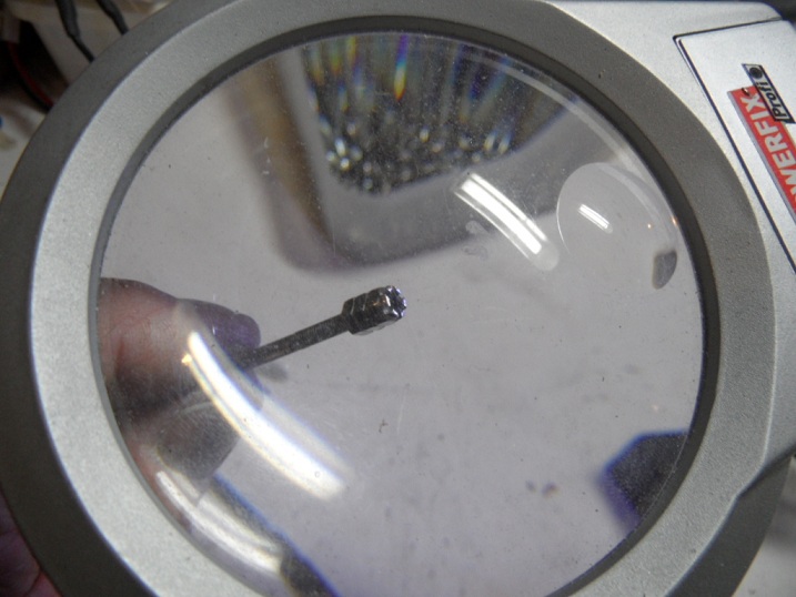

Thanks for the heads up on the BA bolts Andy I'll give them a go. 8)

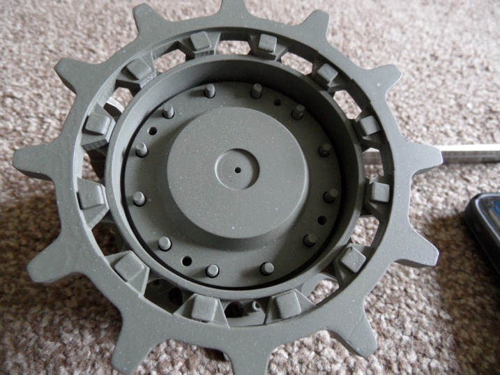

Square Stainless steel nuts can be purchased off ebay with a bit of work they don't look too bad. Richard G went the whole hog and did both sides of each sprocket. I chickened out and did only the outer side.
I did'nt bevel the nuts as I did'nt want to weaken them, with the stresses of the high track tension there's very little metal there to play with in the first place.
Don't forget to chisel out some M3 castle nuts,add studs, the wear dimple and not forgetting the grease nipple, so much joy with these sprockets I could hardly contain myself. :lol:
Nice idea John and very much looks the part, I’m with you on doing both sides at the moment but I’ll see how the 3d printed cover nuts look, or I might use a dome head With 3d printed bolt head on top as per Adrian’s idea on the outside with the square nut inside 🧐. Thinking out loud here, I need to get in the shed with some bolts and a rule 🤪

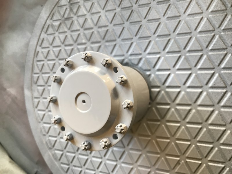

Ok onto the sprocket hub cap. I’ve not done much on it yet but I’m going down the road that Phil Wollard laid with the bolts.
Ok ok and so I also cheated on the castle nuts too. But hey I get little enough time as it is and my 👀 ain’t that good 🤓.
I’ll have to admit it I’ve not even thought about grease nipples yet- now there’s a thought 🤪
andymusgrove
Posts: 158
Location: Pease Pottage
Has liked: 198 times
Been liked: 89 times
Post by andymusgrove »
First of the Sprocket hub caps with bolts. Nearly ready.
M3 x 8 bolts and Castle nuts.

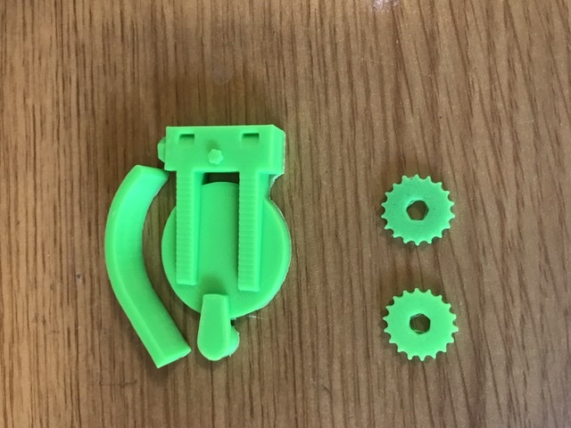

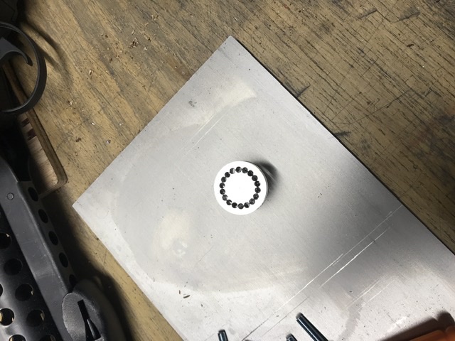

Moving to the rear now and the final drive housing has a small gear that must be some sort of adjuster for the final drive
but anyhow, I searched for a gear that might do the job but nothing came to hand, so I thought I’d have a go at making one.
So out came the old school books - now called google and sussed out the required dims.
Scrap piece of ally turned down oversize by 4mm to allow the holes to be drilled into solid ally. Rather than trying to drill half a hole. So into the rotary table on the mill and drilled the holes.
andymusgrove
Posts: 158
Yep looked lovely and once turned down.

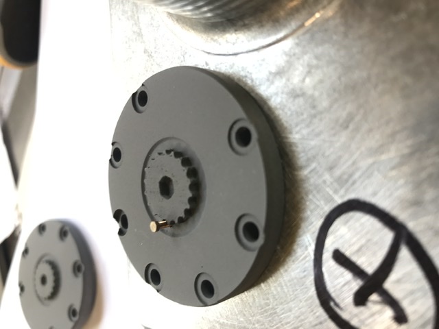

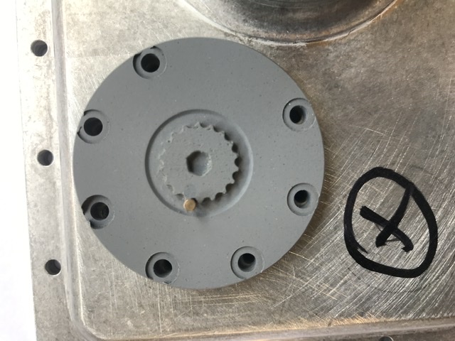

Yep looks ok but the points are all too thin and curled over a bit from the turning operation. So in the end I ask a friend to 3d print some.
And also can be seen is a 3d printed waste hatch, drawings are from Vince Cutajar who very kindly let me have a copy of the .stl file. 👍 thank you Vince - much appreciated. I think they will look a whole heap better when painted 👍 but beggars can’t be choosers. 😀
andymusgrove
Posts: 158

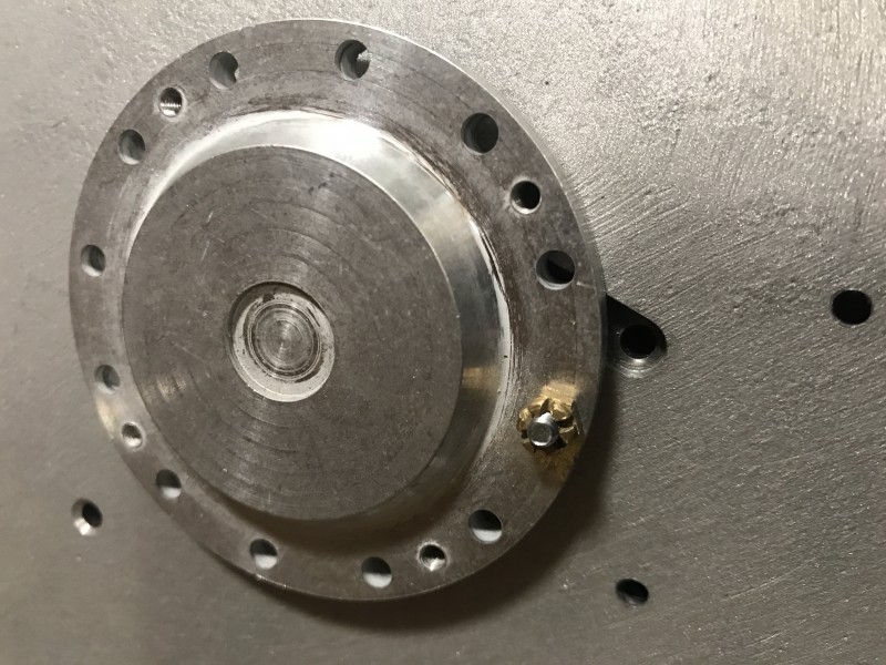

And here they are fitted to the final drive housing cover
And now awaiting Mr postman who is bringing some M1.4 nuts To complete the look.

Andy, I liked the original quill end cap in metal, a clever way to do it. I modified a metal gear from the spares box, countersunk set screw for the hex center.
It's a personal choice for me to use metal parts where ever I can, (I leave the extra fine bits to Dave Dibbs which I just can't do), it's time consuming, baffling and certainly frustrating trying to keep to scale, difficult without drawings or a local vehicle. I find myself measuring off the PC screen how stupid is that :lol:
