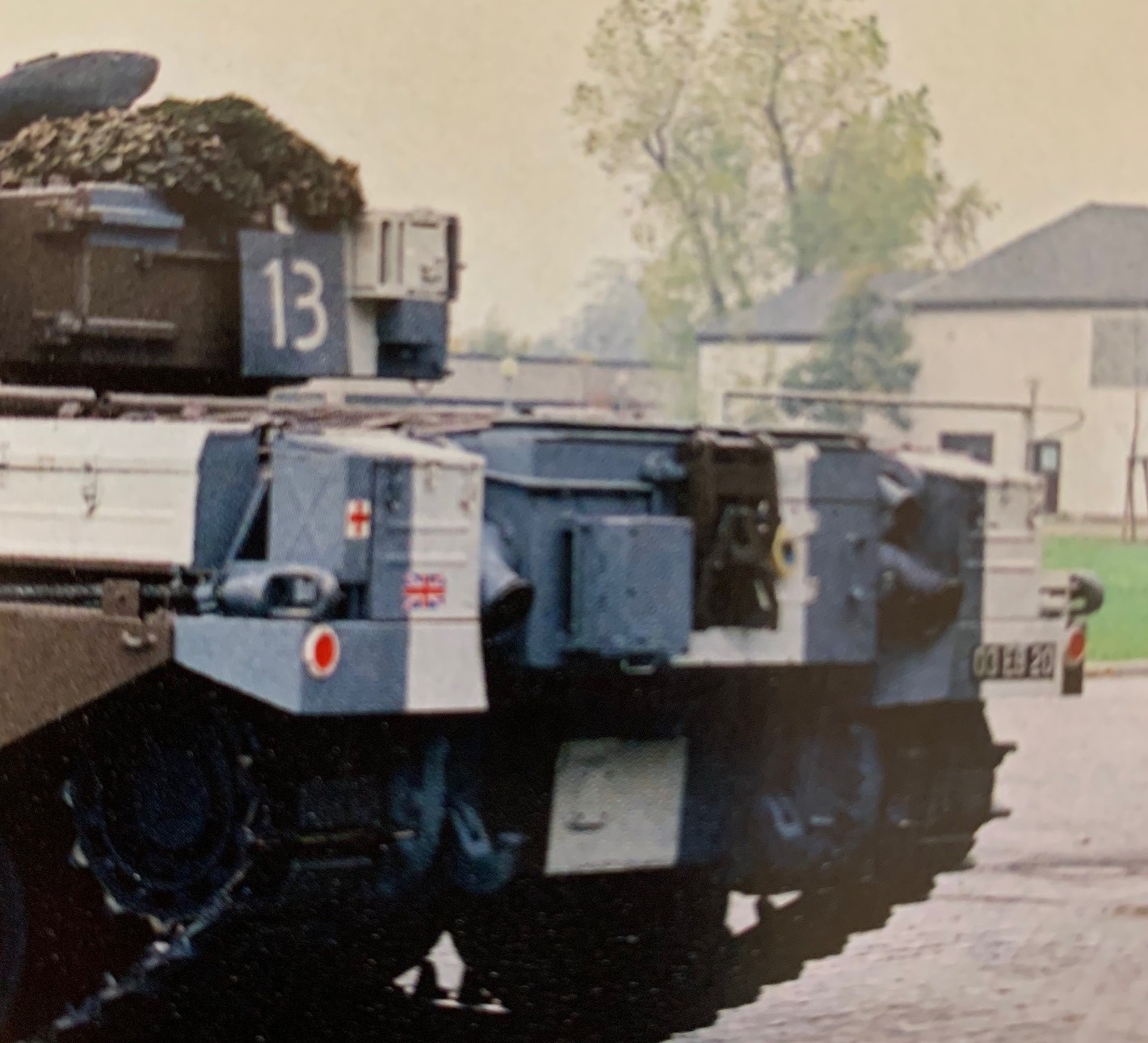

Stephen,
VMT for the extra information....all very useful stuff.
Ignoring the fact that the bins look like they have been biffed, the box still looks like its leaning backwards at the top. Now if you look at 03 EB 20 below, that is clearly is sitting upright.
I do however agree with you that it would need more evidence to substantiate what could be two differing build standards.
