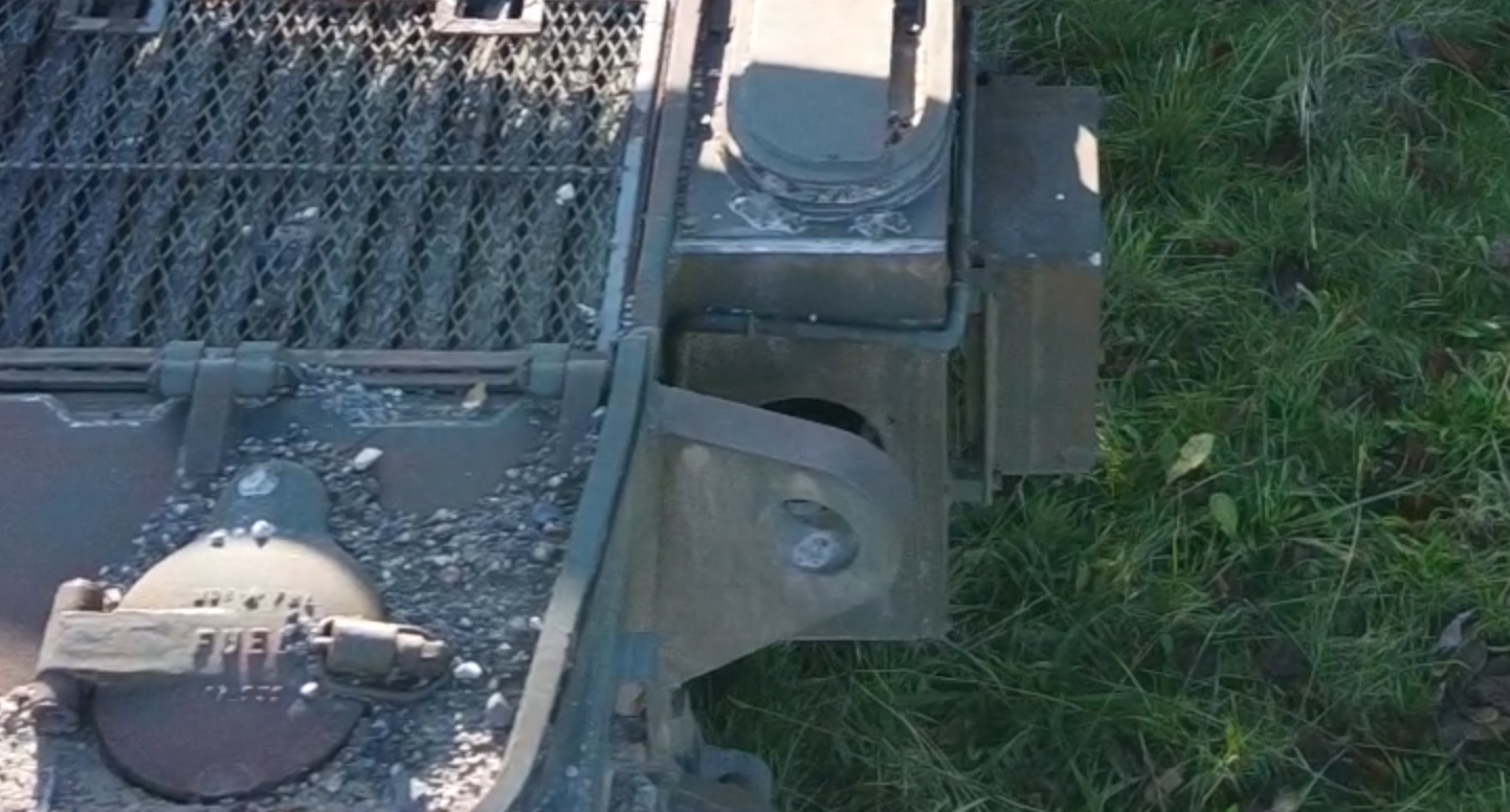

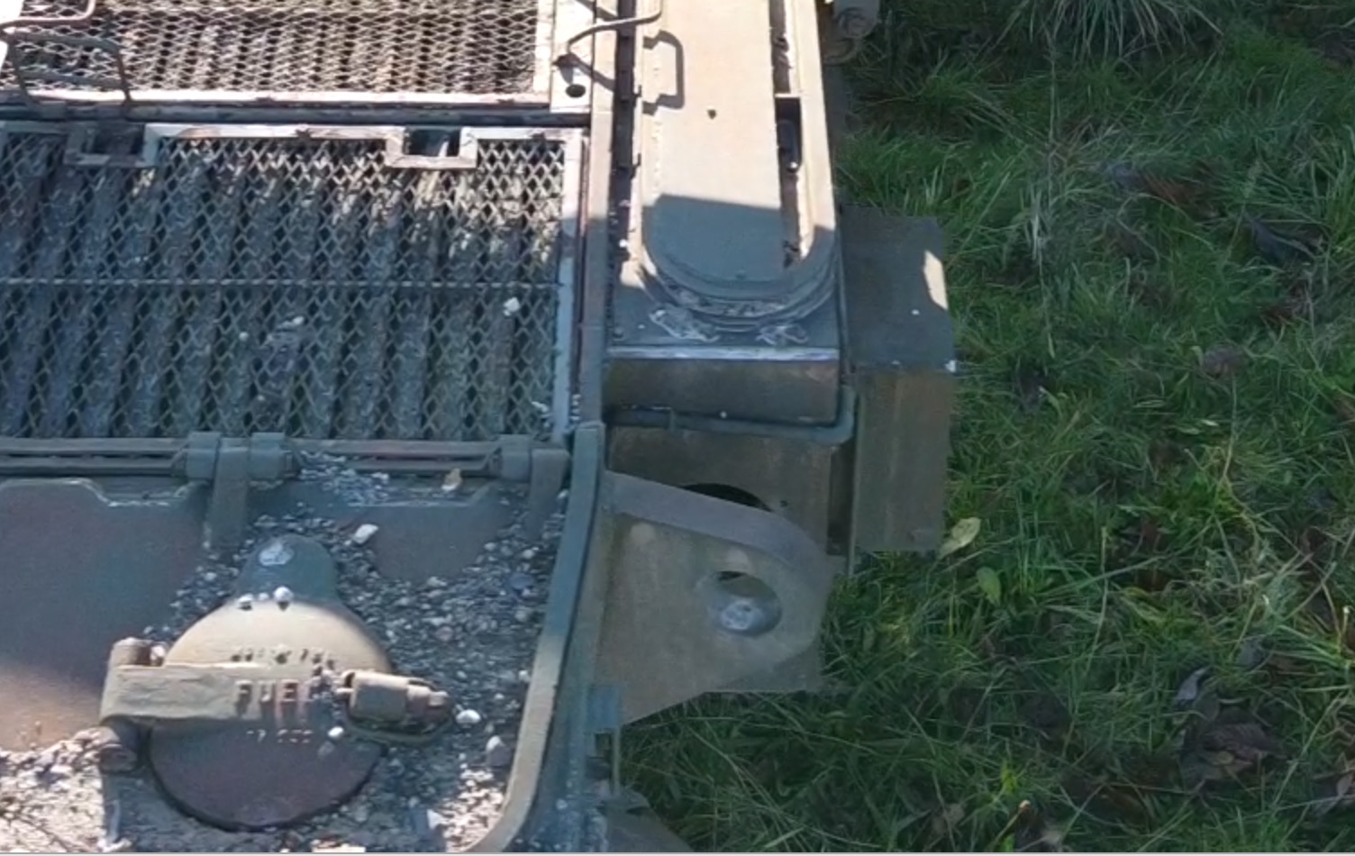

When you look at the above picture, the two boxes either side of the exhaust box look like they are upright whilst the exhaust box appears angled in comparison.As for the drawing, I'm sure it is original but is it the latest drawing?
- Has liked: 1040 times
Re: Exhaust box
Richard, you can’t go by the position of the rear bIn. In this case, the mudguard it sits on has had a biff which has forced it upwards. The one on t(e other side looks less disturbed but either way, they moved in service and we’re all too easily damaged. The Leyland drawing is for the Mk 5, which was the final production version. All later marks were conversions. The exhaust system was modified during the SUNDANCE programme, to the standard shown in the drawing. If the box was subsequently modified as you suggest, it would have required a major base workshops programme and a redesign of the internal exhaust box and pipes, which would have had major costs. I’ve never come across any records to that effect. We’d need more evidence to show there was a mod in later service. Interesting thought though and it would make life easier if it were substantiated.

It's easy to be mislead by perspective in photos, which is why original drawings and measurements sometimes reveal unexpected results. These two pictures are the best I can find in my database for illustrating that the side plates of the exhaust box were trapezoidal not rectangular, consistent with the drawings.
These drone shots may also help:
