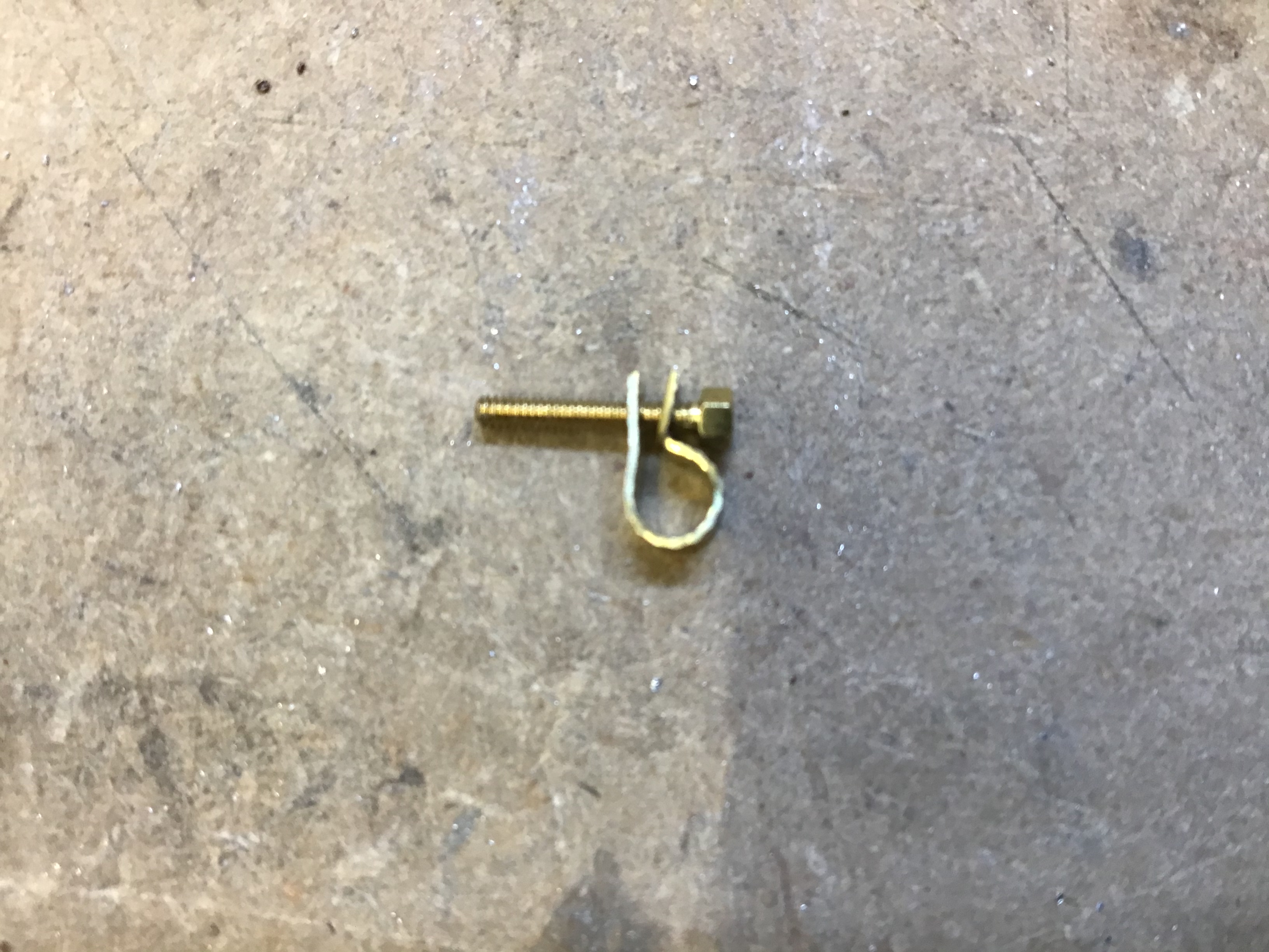

I used .5 mm brass cut into strips and formed around the pipe. Leave plenty of excess length as you will need this to hold when drilling. I drilled mine 1/16 inch dia (a new drill really helps hear). Once drilled I cut off the excess length.
It may take a bit of practice but once you get good results it becomes quite easy.
This is one I did
This is one I did

What method do you use to cut the brass?
Greg

Hi Greg
I use Gilbow tin snips, easy to use on thin sheet material.
