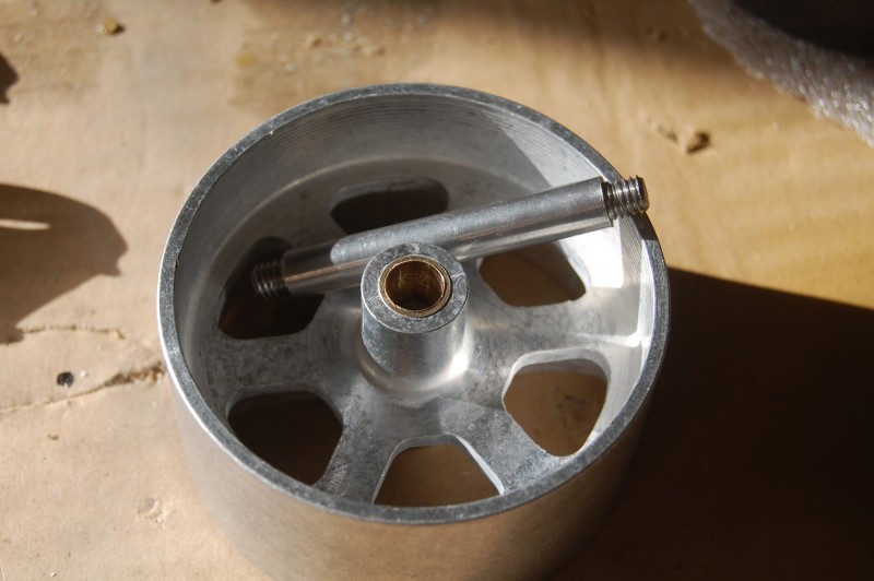

This afternoon while waiting for paint to dry I tried assembling a Road Wheel. A word of caution here chaps.
I put the two bushes, ED0108 in the Hub EN0109 and tried to fit the axle, ED0107. Didn't go in. Ah, I thought burrs. Did a bit of deburring with a file, no joy.
Micrometered the shaft, a tad over 8 mm, so we might have to put an expanding reamer through the bushes to make sure that
A) the axle will go through without binding and
B) that the bushes are lined up,
I find with experience that this is not unusual, although Bar stock is nimolly 8 mm (or whatever) it is often a few thousandth out while the bushes may be made to size.

Did a couple of road wheels as well today. Same problem. But got around it by just putting an 8mm drill bit through the bushes. Did it by hand i.e didn't put the bit in a drill. A couple of minutes a bush and finally alls is well. I seemed to have a bigger problem fitting the bushes in the wheels. The outer bushes go in ok but for some reason I am having trouble with the inners. Almost as thought the wheel centre hole has a taper! A bush that fits the outer side will not fit in the inner.

I found that I had to tap the bushes in with a nylon hammer. The tight fit could be the reason why the axle is stiff to go in, the bore gets squeezed.
I also noticed that there is a variation in finish, some have a lip on the outside, some on the inside. No doubt that this is due to the manufacturing process where the bushes have been machined and cut off. Nothing that a little fettling can't fix.
It why we make models :D
I also ran an 8 mm drill through by hand but although it says '8mm' on the shank it may be under or over depending on the quality and the manufacturer which is why I have ordered an adjustable reamer. I can adjust it from sliding in nicely to shaving off a thou at a time until the axle slides through nicely and the wheel turns.
The other advantage of a reamer is that they cut accurate and parallel holes.

The Reamer I ordered came today.
This is what was removed from the bushes of two road wheels. Just a minor shaving of the insides but enough for the axle to to fit smoothly and allow the wheel to rotate. You also get a parallel hole.
Sorry its a bit out of focus, using a tele lens with a macro function. But is still shows just how much was removed, and no slop either.

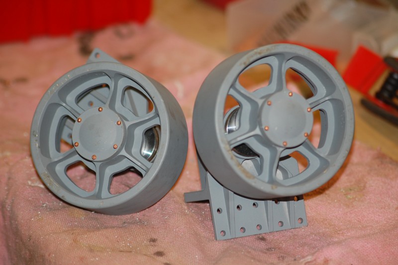

Idlers Done.
Hiccups....None really except for me not noticing that the Bearing Recess is deeper on one side, that is the side that goes on the outside of the tank.
When it cam e to fitting the 1.6mm rivets throught the hub cap ED0212 I took advantage of the rivets being longer than the depth of ED0212, so I drilled 1.5mm through the cap into the Idler, EN0207, and Pushed the rivets through so they were a tight fit.
Only question is, why weren't the holes for the three M3 X 8 Hex tapped instead of having to use Threadlocker to hold them In.......b but 'that's life' :P
'Glued' (i.e. Loctite 6000)the 2.5 rivets into the side frames earlier this afternoon, now waiting for it to set. Next job will be to go back to Step 1 and do the Running Gear but that will have to wait until Friday at the earliest.

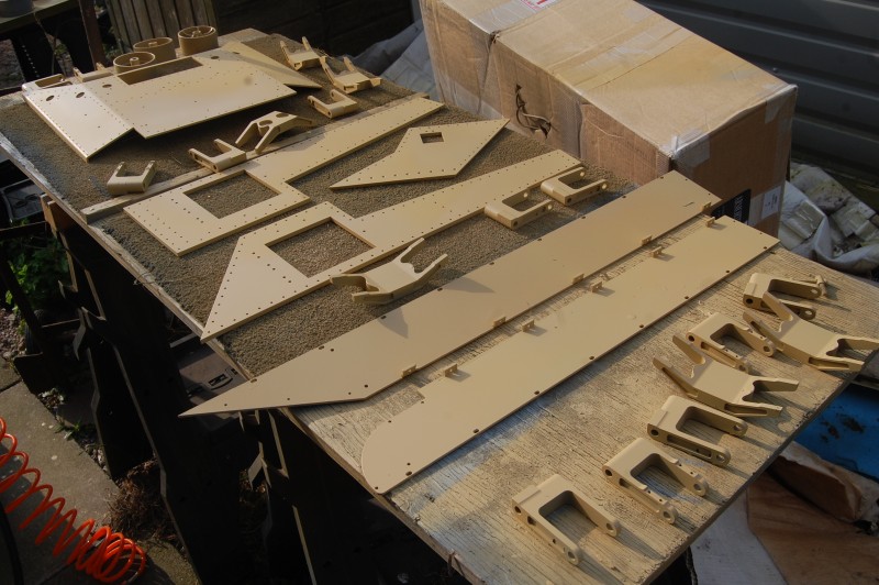

Diff assembly progressed a little more.
Bolts turned round so that nuts face inwards, EN0201 Gear Cases fitted and the whole thing given a light coat of etch primer.
So far I have etch primed all the running gear parts, but before I assemble it all I'm going to start on the Hull. When all is primed I'll give it a coat of BS 381c 361 Light Stone before utting the tyres on and building the road wheel assemblies.
Note that I have swapped the M3 Cap head screws on the Gear Cases for Hex head screws as I think they are more representative of 1942 fasteners than cap heads.

Kian's reply about the cap screws have been duly noted, but I think I'll take the risk and pay the penalty if I'm wrong :) :(
This morning was calm and bright, though a bit on the chilly side, so i tool my bits' and gave them a non biblical 'Light Stone(ing)'. A couple of hours drying and hardening and if the weather is still clement i'll turn the hull and running gear over and do the other sides.
