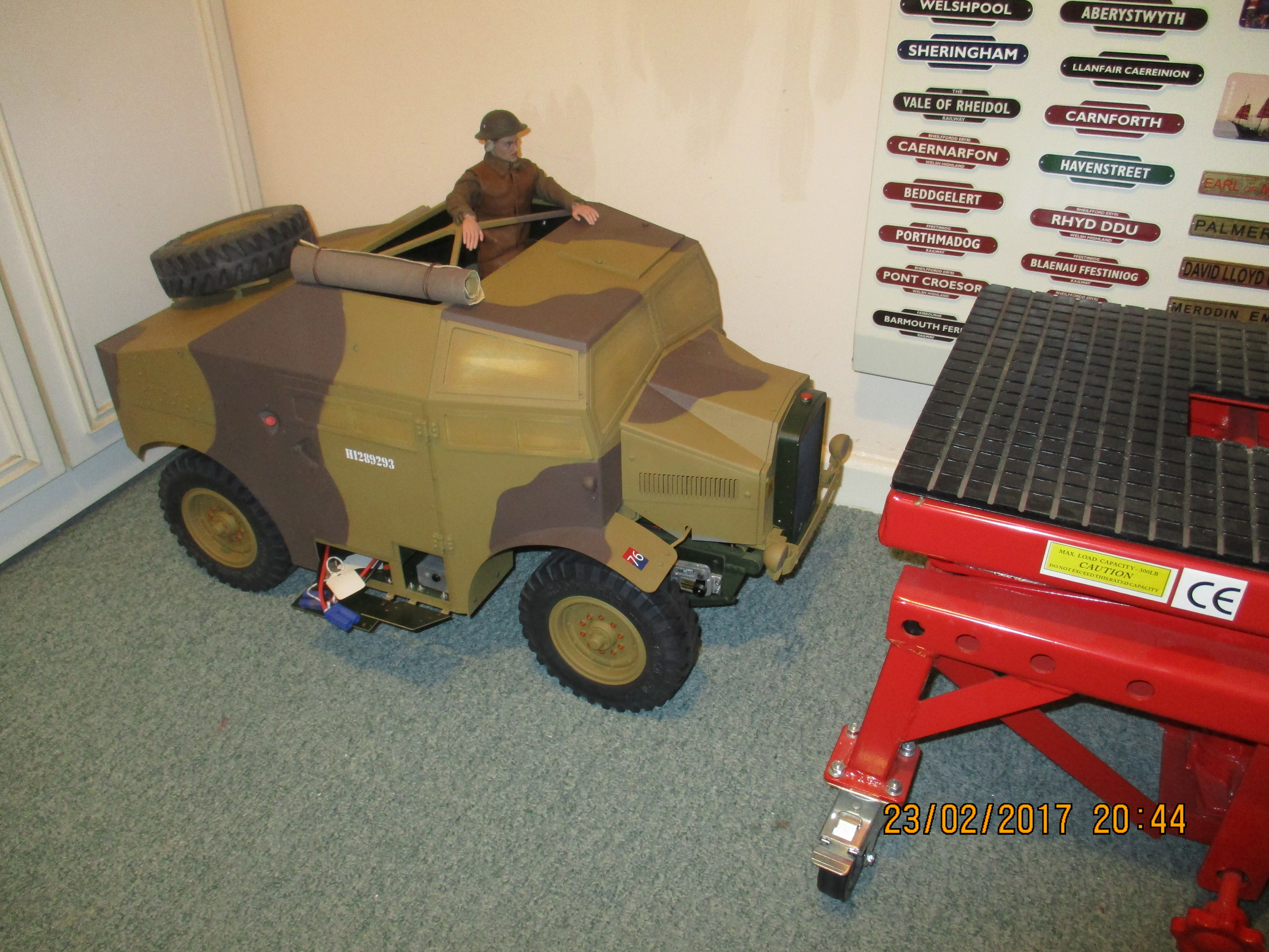

I am looking for a way of being able to have a charging socket on the quad to which I can have access without having to keep removing the top to re charge the batteries. Has anyone been able to do this and if so which socket did they use and where did they place the socket.
- Posts: 1198
- Has liked: 1566 times
- Been liked: 836 times
Re: Charging Lead
Hello Bryan, I have routed the leads down through the hole in the equipment trays. They exit through the side lockers. I then split the main battery lead using a E5 connectors. The batteries can then be isolated and charged. The second side locker holds the stop/start switch. Both sockets and switch are hidden by the locker doors. Unplug the E5 connector then plug your charger into the isolated battery side. I tag all my electrical connections, as I easily forget what goes where
.....Mick.
