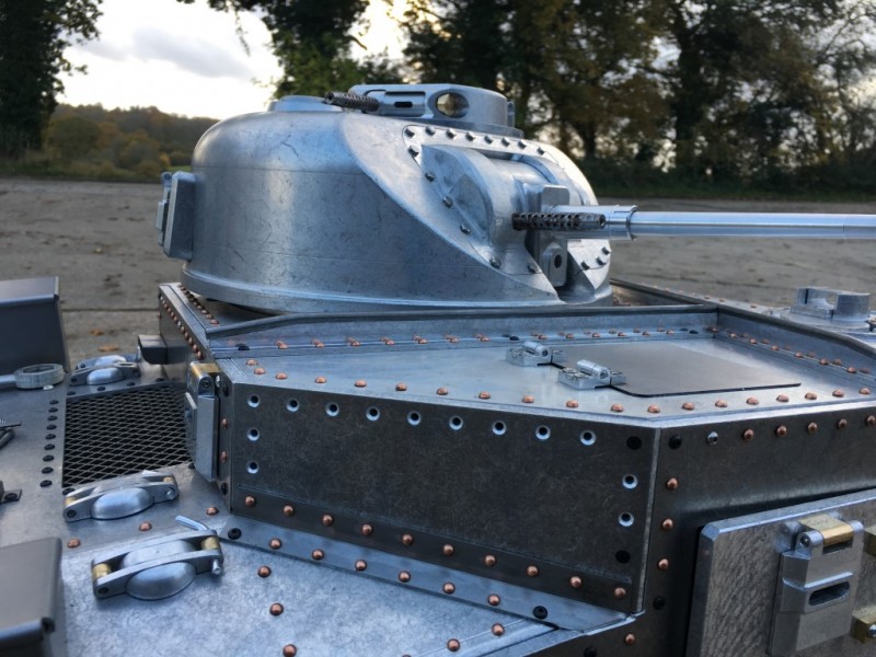

As promised - some video of the prototype M3 Grant getting its first test run - and it ran perfectly.
Photographs to follow.

Wow, what a beautiful model. It really jumps off the screen. I especially like the video with the damp concrete. It looks like a Hollywood movie!

Very interesting model with lots of detail and plenty of opportunity for animation. I didn't know I like these! :D

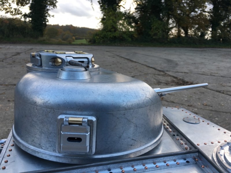

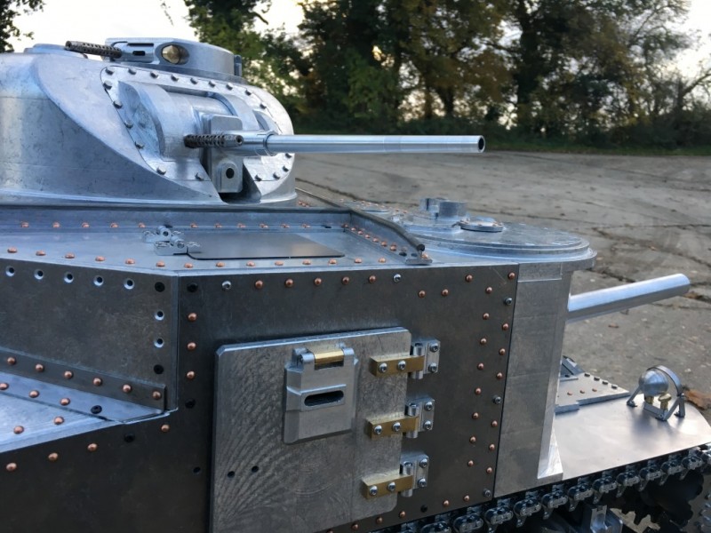

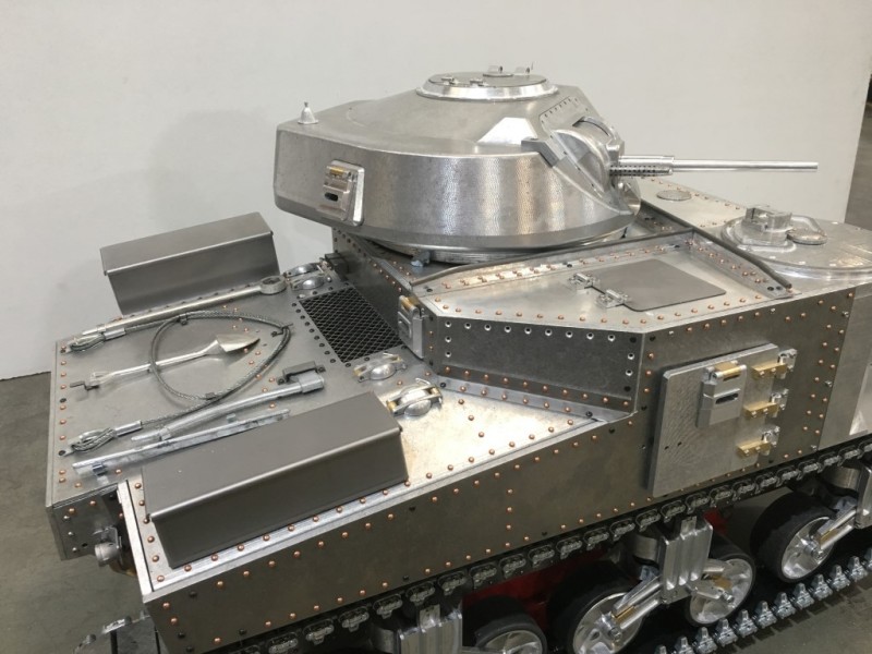

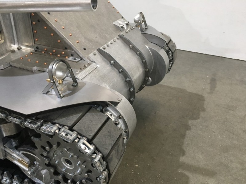

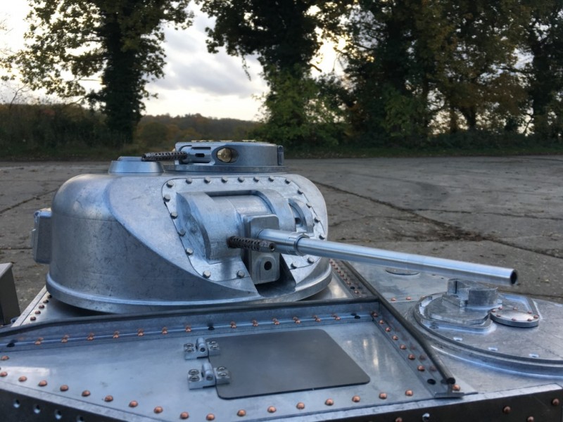

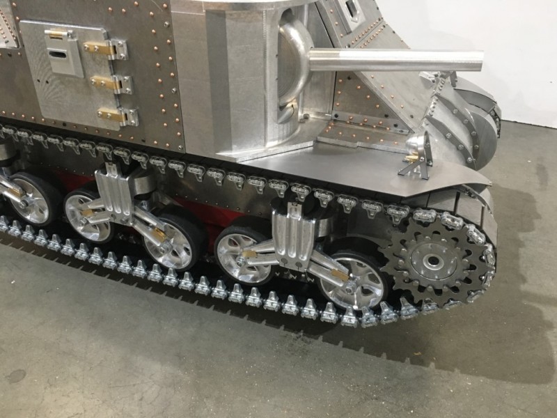

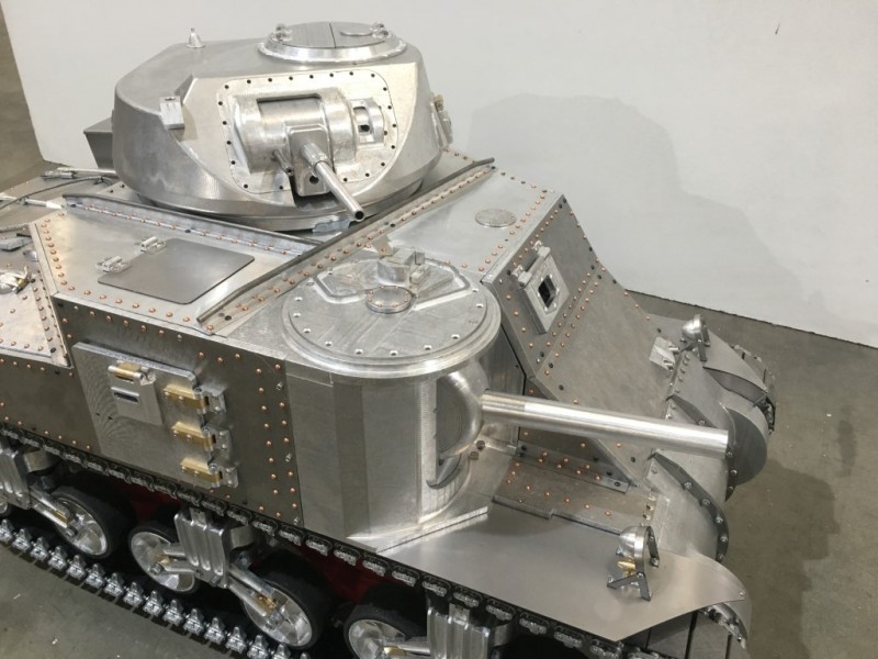

And last but not least we have some pictures of the Lee.
We will get to all the questions that have been asked on this thread in the next day or two .. in the meantime .....

That's my baby ..... but without the silly little m/g turret on top. I'll be hoping that the top hatch from the Grant turret just drops in (that's what the Tank Workshops did).
Pete - there's no question that the M2 gun wasn't as good as the M3 in terms of muzzle velocity. That said, the Lee / Grant was never going to do well in a stand-up anti-tank fight with a Pz III or IV (Kasserine Pass proved that). Given the hull down problem, either gun was much better at firing HE. And both guns survived all the way through WW2. So it just depends on what tank you want to recreate - that's the joy of this build !

That is really something! I never dreamed I'd look on a Lee as a thing of beauty - but it is an amazing model. Well done Armortek. I like the silly little MG turret! As a combat tank the Lee was severely lacking - so the little turret adds to its "Uniqueness". One hardly ever saw even a 1/35 scale model of a Lee, until Takom released one this year. That is what makes this one so special - very unique!

It seems to me that the Lee Commander's cupola is too low profile :?:
The ventilator appears to be a later addition, and I can't believe they would have a close support MG which couldn't sweep past the ventilator :oops:

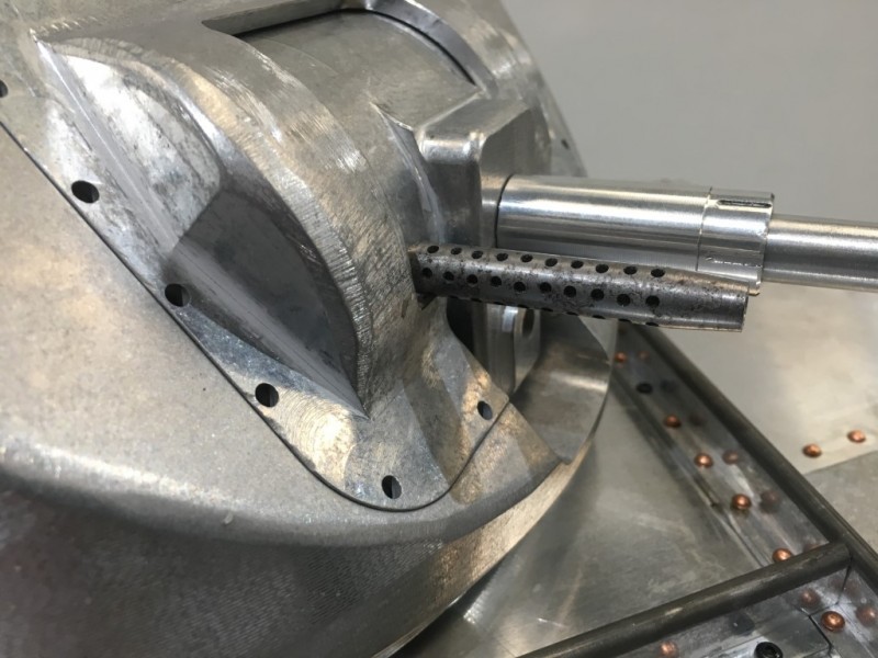

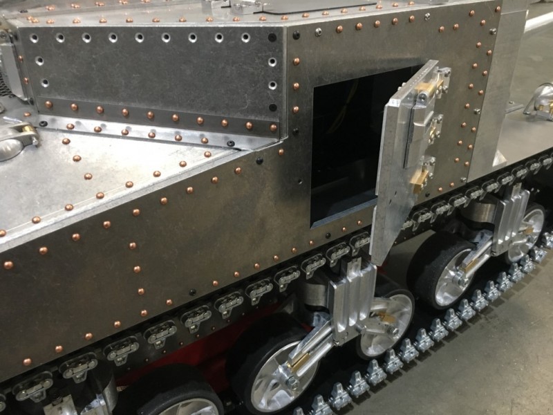

In response to some of the questions that have been posed on this thread (and a couple of other bits of info):

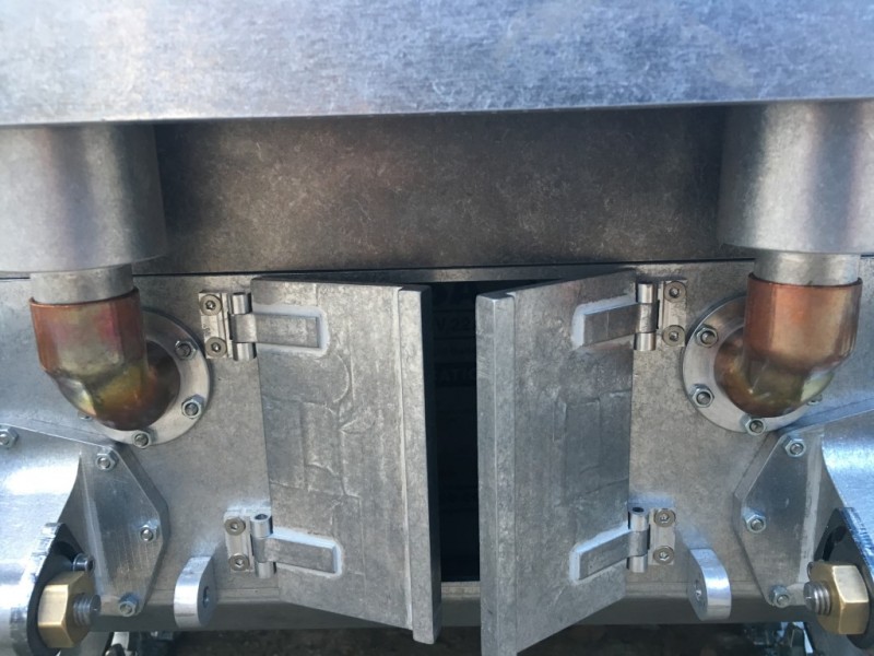

Return Rollers - They will be made of steel on the production version
Axe, towing wire and track spanner will be included in the production version
Final drive case will have rounded inside corners
Rivets - the rivets shown will be the ones supplied. You may have noticed some empty fastener holes, these are for some dome slot head bolts that are being made at the moment - as per the original.
75mm gun - Our plan was to only supply the shorter M2 version, however, for Pete we can look into whether we can supply an extension !
On a side note - the 75mm and 37mm barrels are not fixed in place on the prototype, so you may see them at different lengths depending on the photograph.
2x 30mm m/g on the hull will be more recessed then they are on the prototype
Lee Cupola - The early blueprints that we were working off showed a lower m/g cupola and ventilator as well as a couple of other features. We have already updated the design to change both of these but this is not reflected in the prototype as the metal had already been cut.

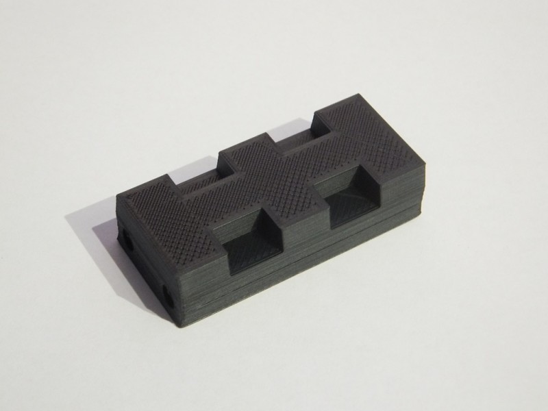

Having seen the prototype in the flesh yesterday, wearing its T41 tracks, I though I'd have a go at drafting and 3D printing a link of the British "Rubber Standard" pattern, usually known as WE210.
I think it looks OK, although my 3D printer doesn't seem to be printing solid layers at the top for some reason :roll:
