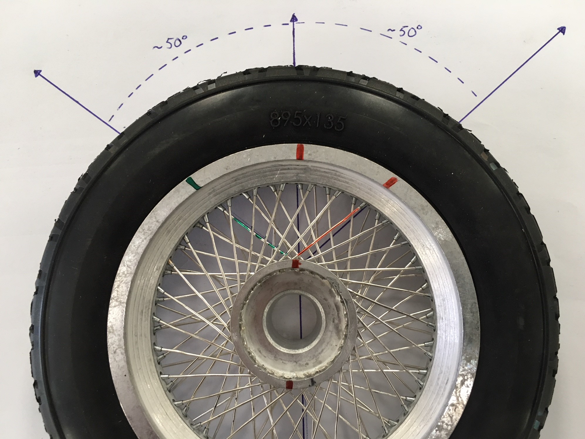

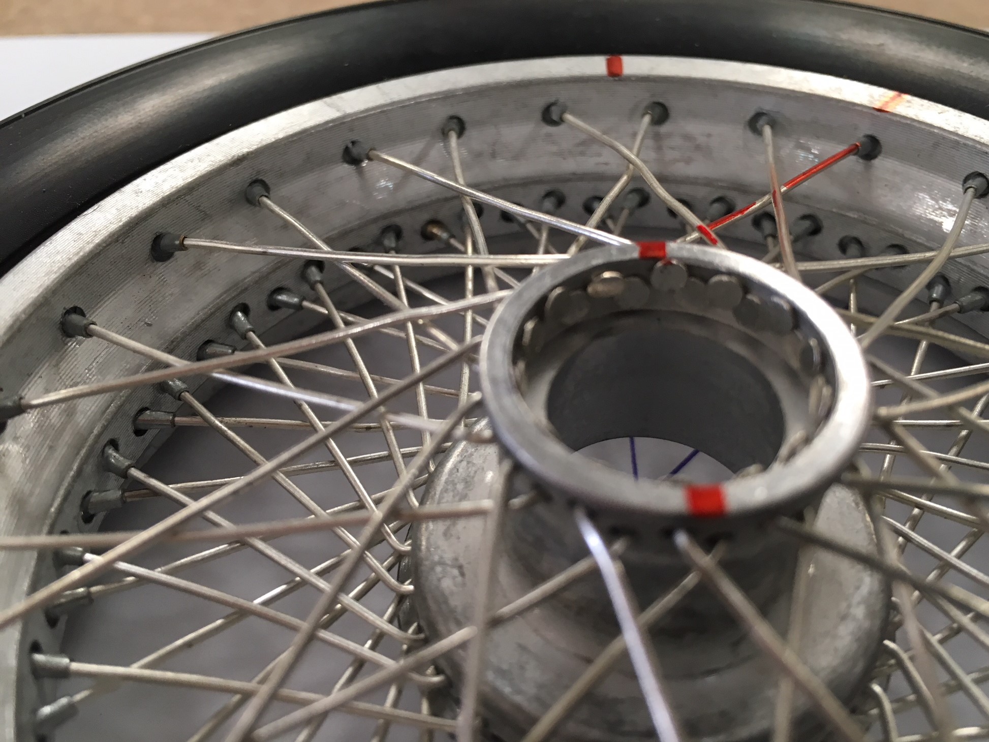

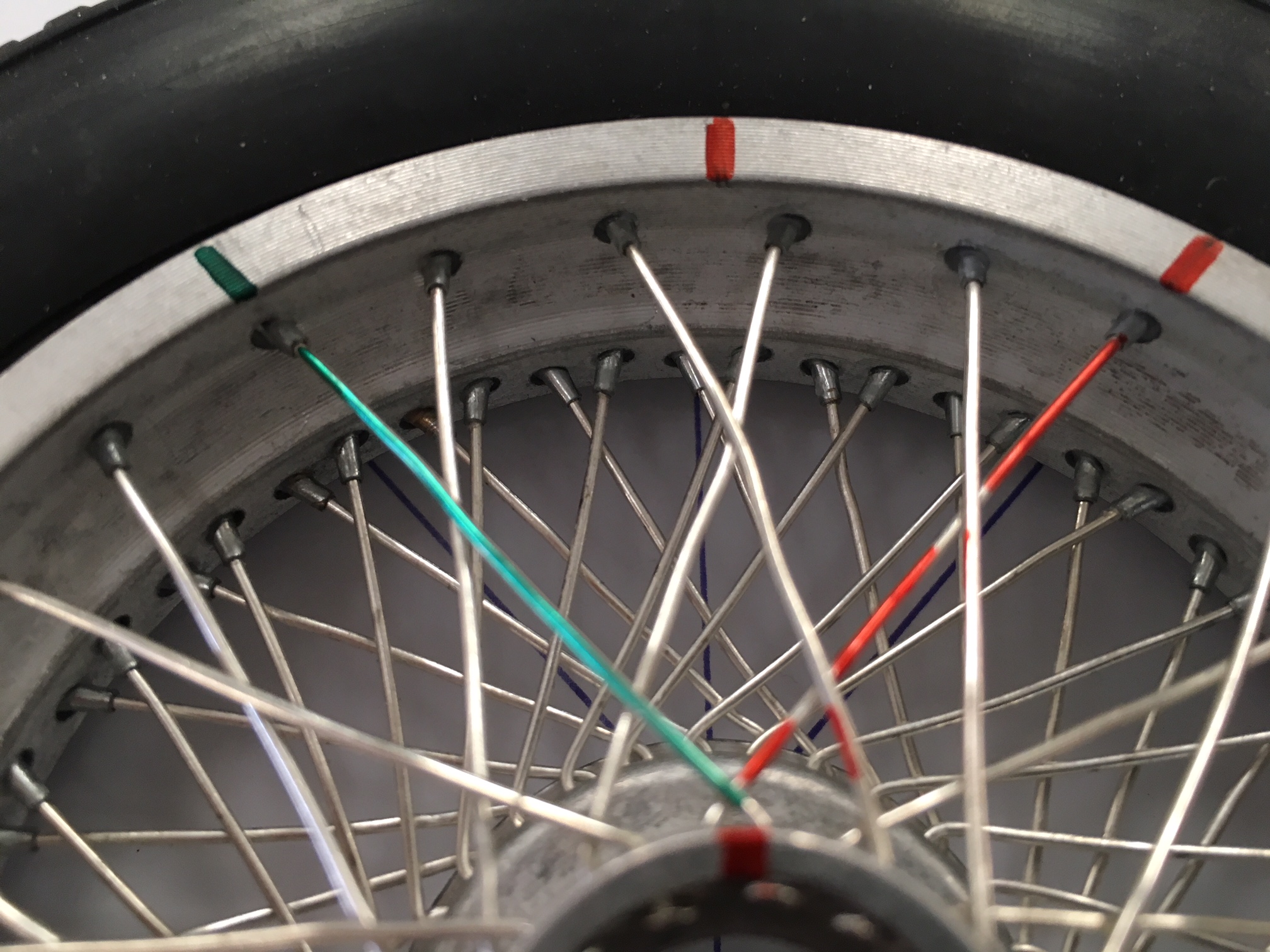

Below are a few photographs of the SINGLE WHEEL to help with the layout of the spokes on the wire wheels.
There should be referenced alongside the Wire Wheel manual that has been provided in the kits.
Note that in the images below, the first steps were started by going ANTICLOCKWISE whilst the manual starts with the first steps going clockwise - you can do either.
STARTING WITH THE INSIDE OF THE WHEEL

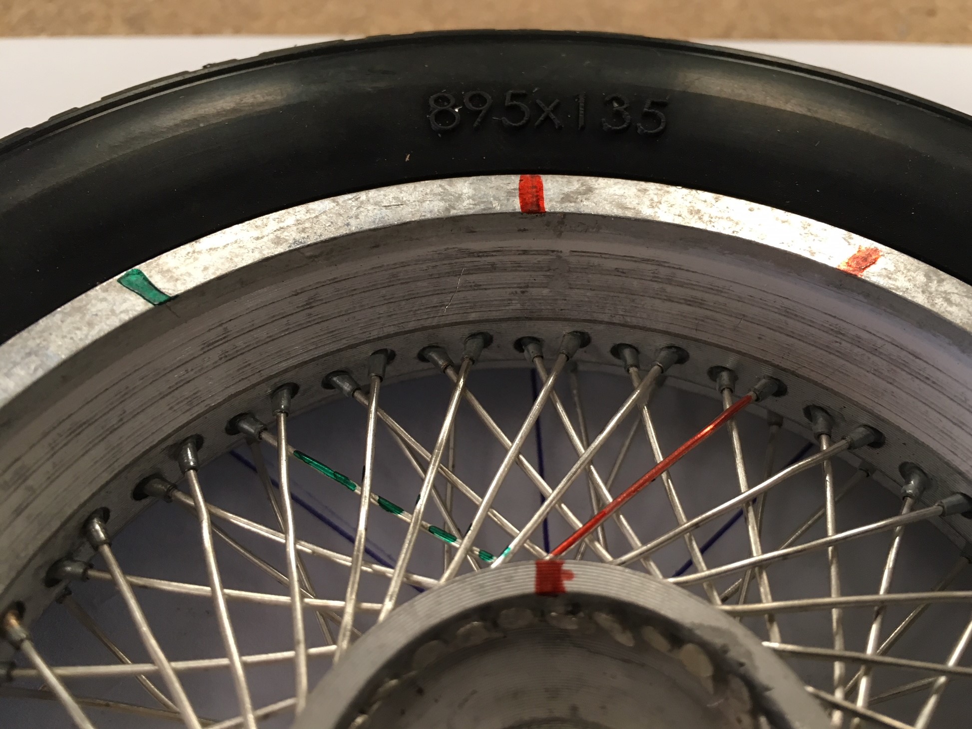

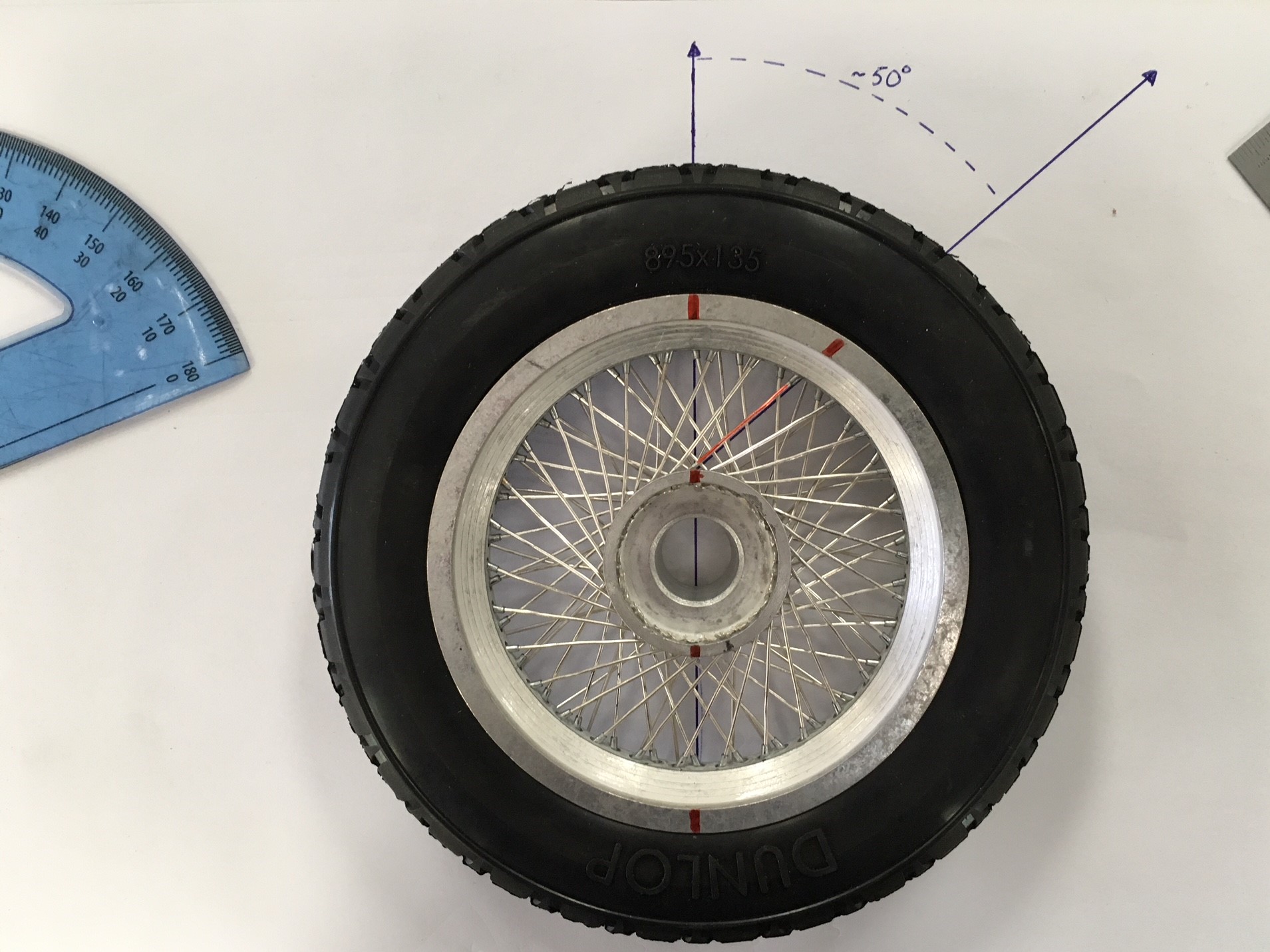

Image above shows the approx angle from the centre line for the first set of spokes (STEP 3 from the manual)

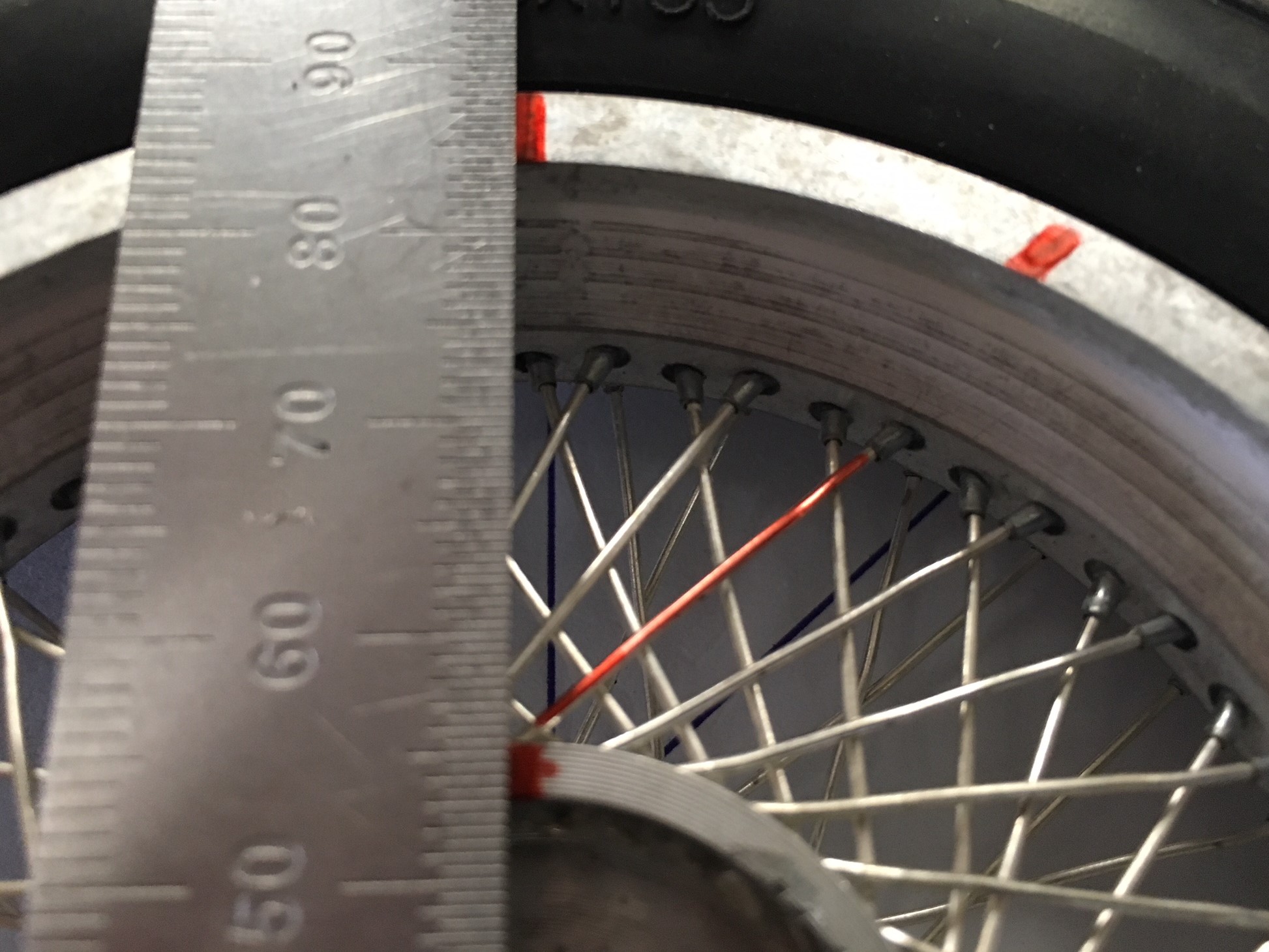

Image above shows the number of holes along from the centre line that you should go.
Also note that the FERRULES (EP0104 should be aligned with the spokes)

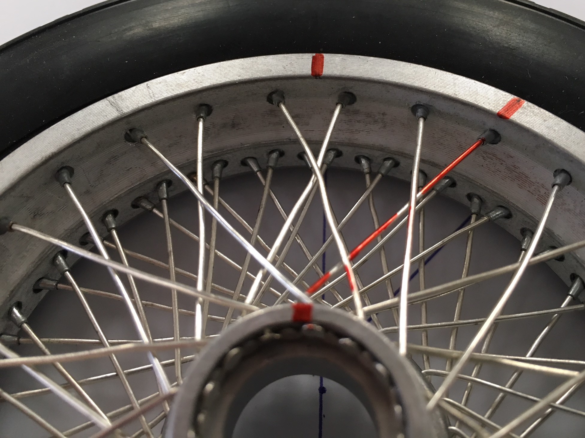

Images above shows the spoke in green being fitted in the anticlockwise direction. Note that the angle of 50 degrees is a approximate as it is difficult to measure the vertex of the angle (STEP 8 from the manual)
Image above shows the positioning of the pin heads once all the spokes are in and fixed.
NOW MOVE TO THE OUTSIDE OF THE WHEEL
Image above shows the other side of the wheel (STEP 11 from the manual)
Image above shows the number of holes to skip from the centre line.
Image above shows the pinheads.
Image above shows the spokes being places in the anticlockwise direction. Again, note that the 40 degree angle measurement is an approximation. (STEP 14 from the manual)
Image above again shows the aligned ferrules and position of the spokes.

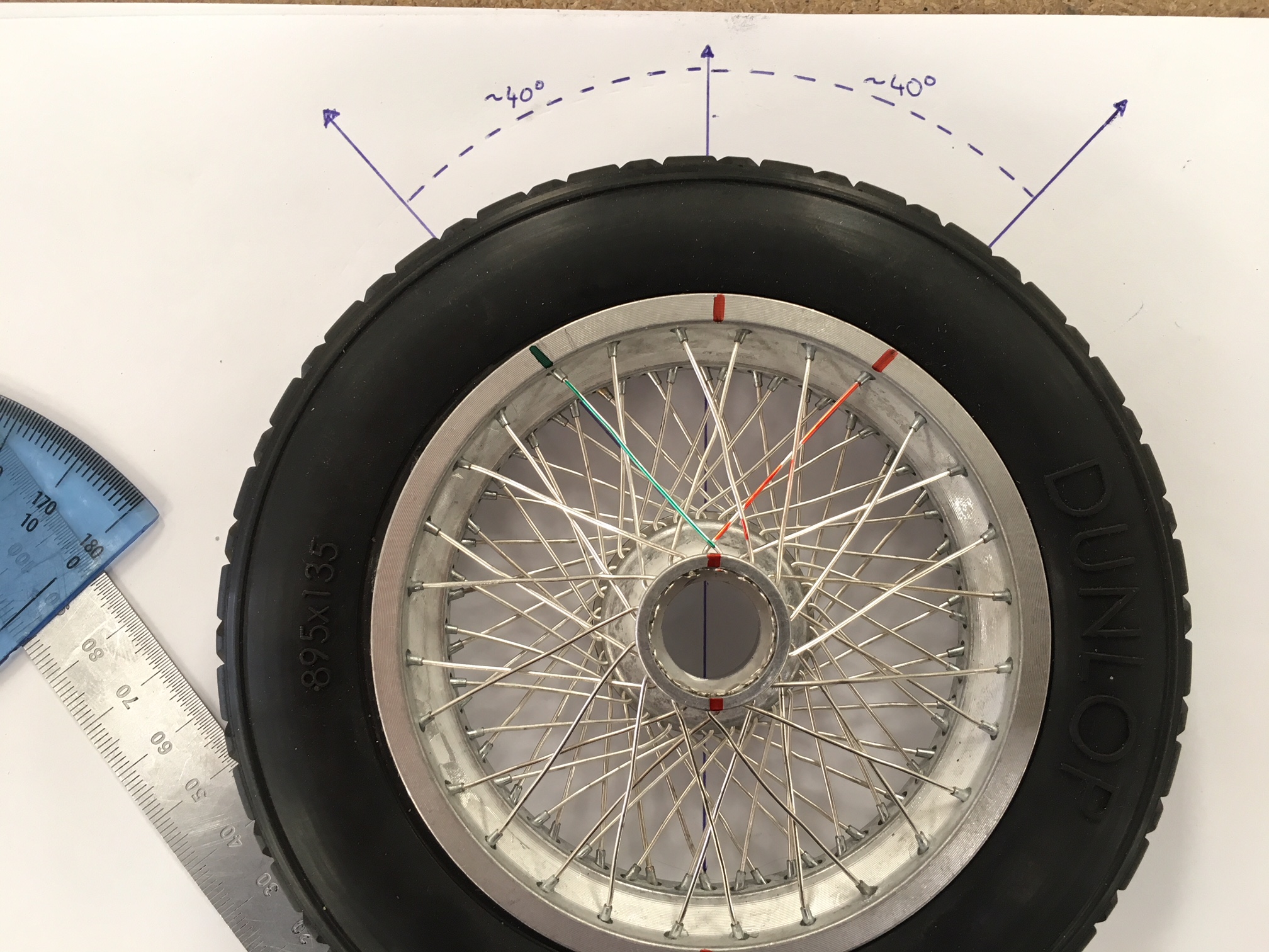

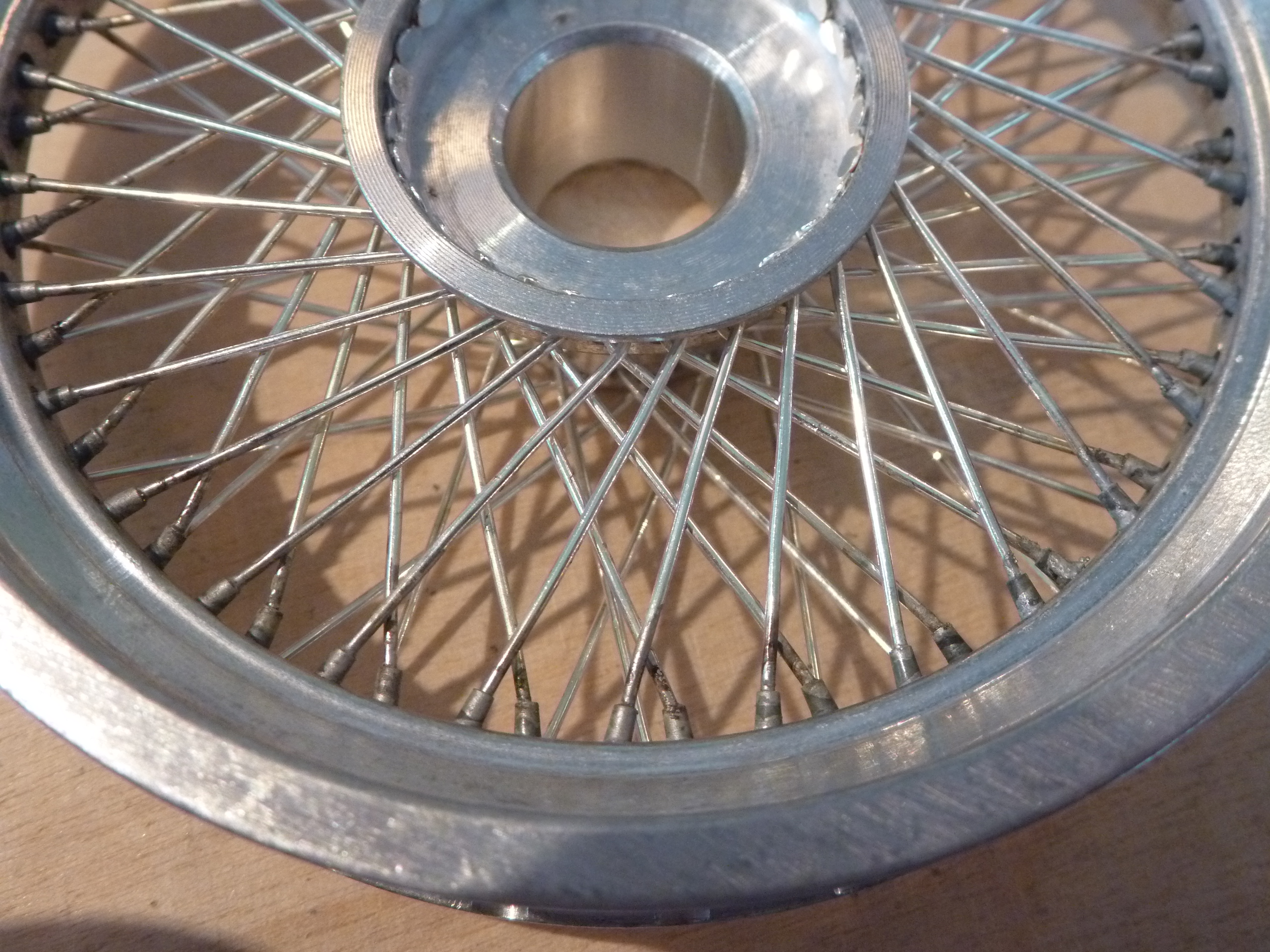

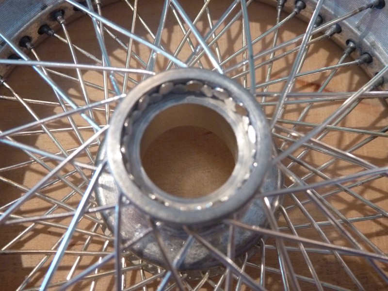

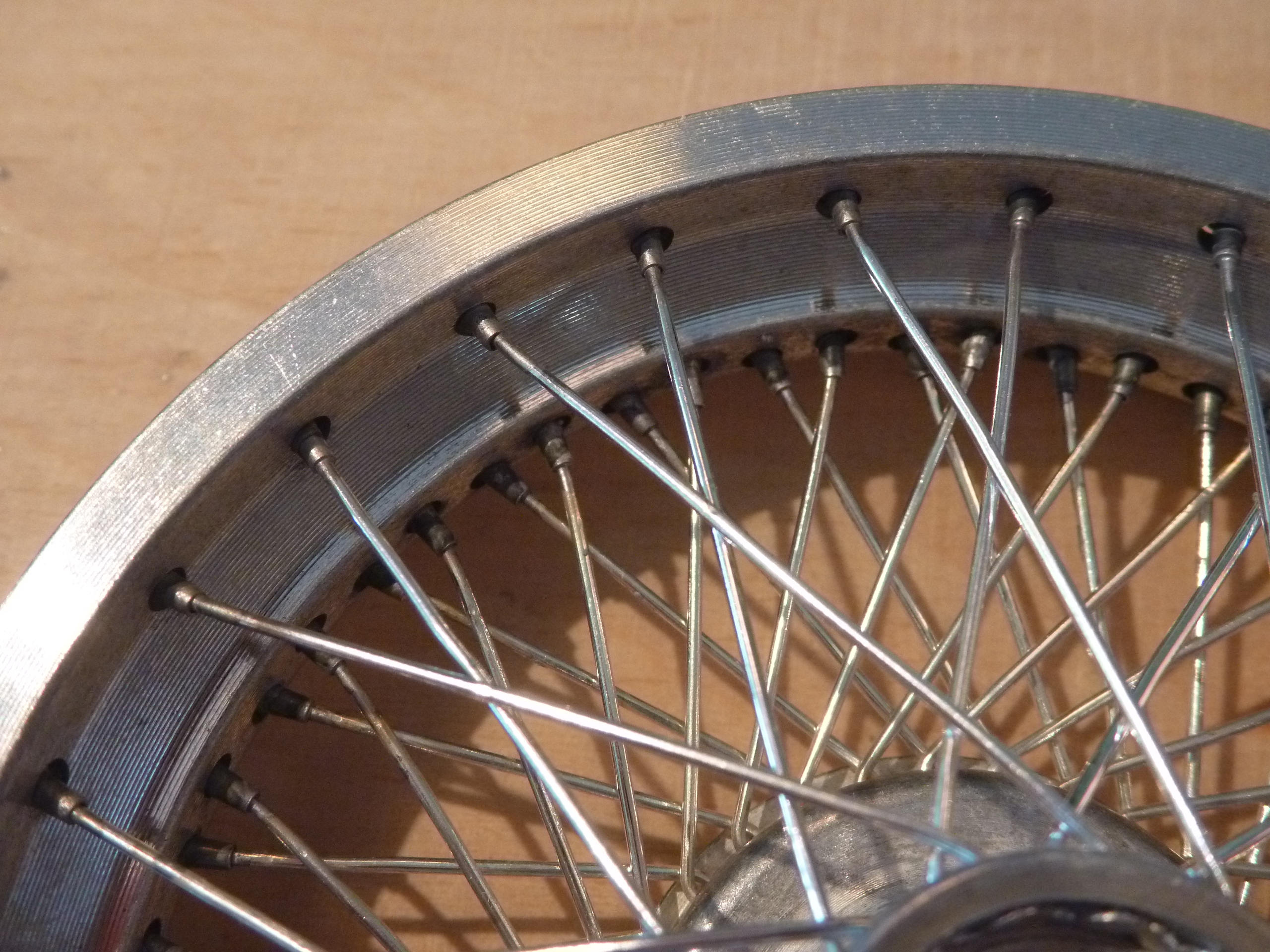

Hello forum,

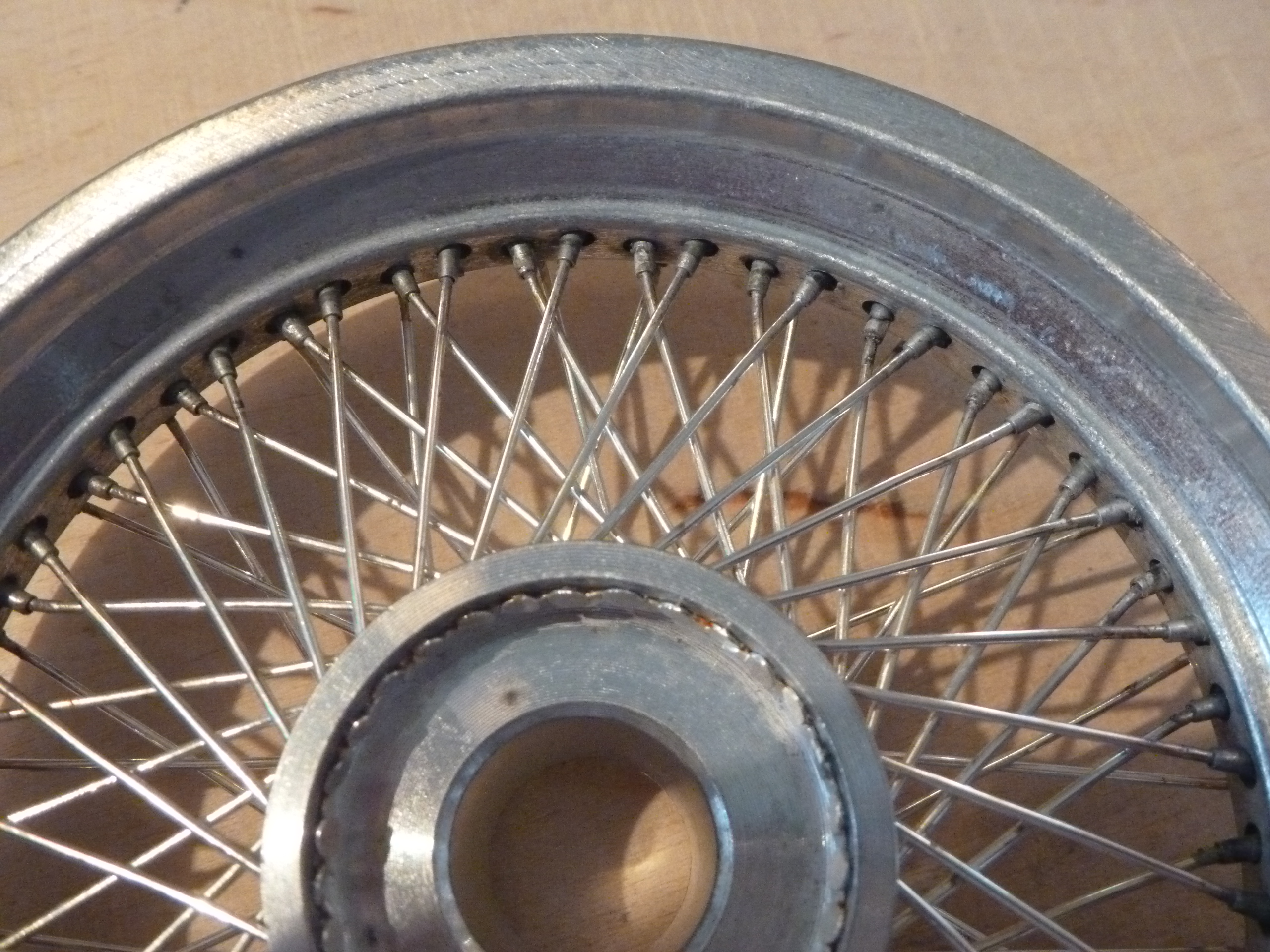

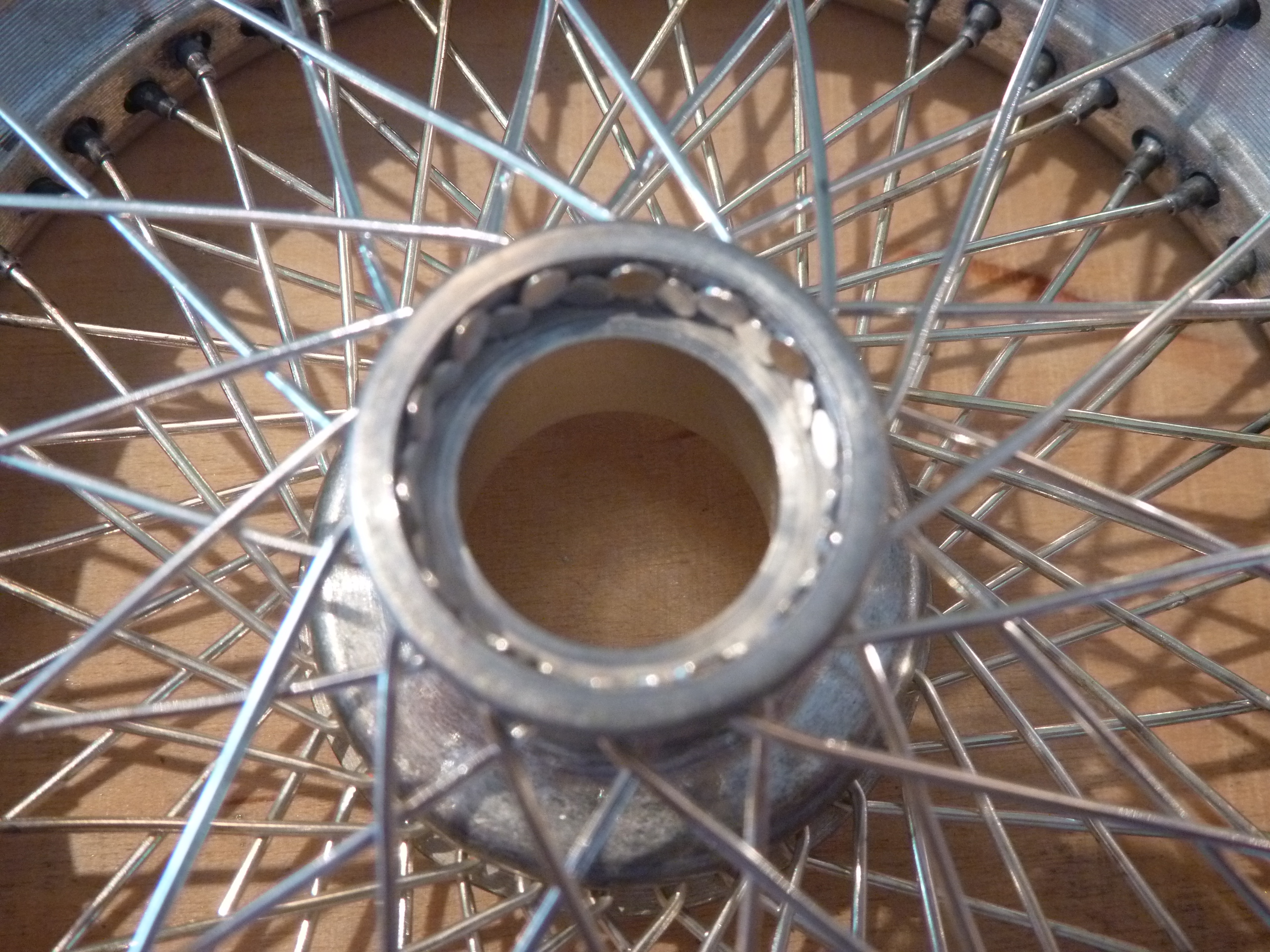

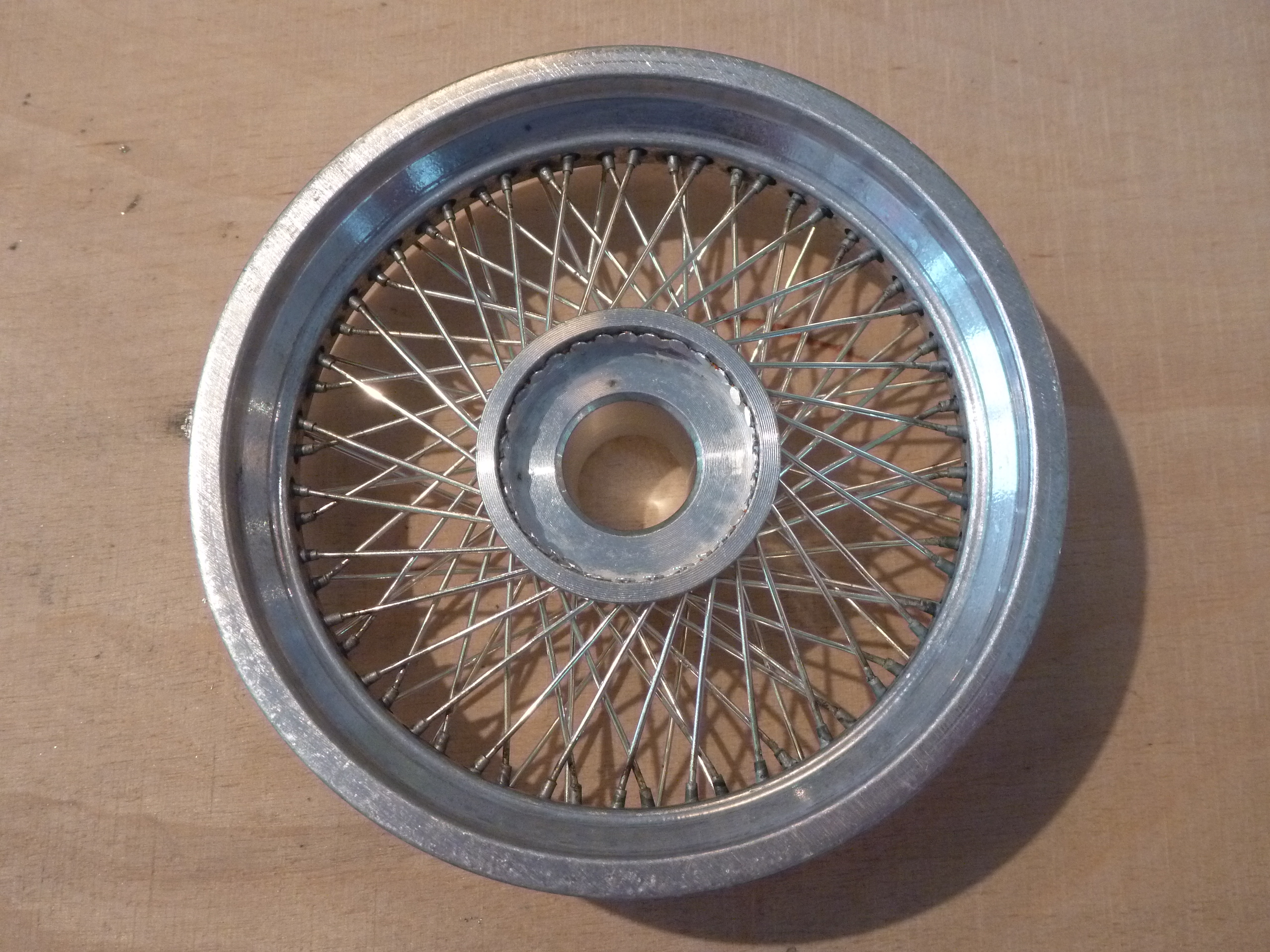

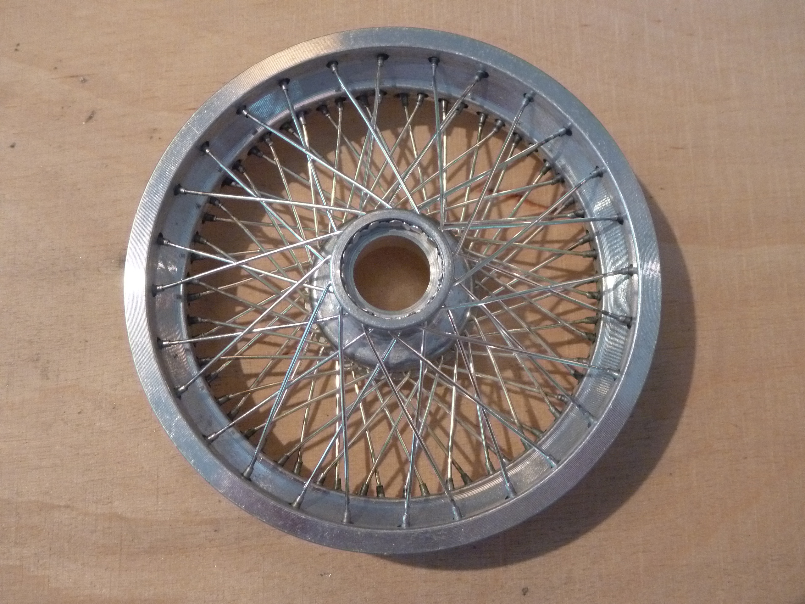

my first wire wheel is finished. A few pictures.
After a period of trials, I did not want to glue the spokes but solder them hard. This holds better and the spokes can be installed so tight. The whole thing is very stable and firm. After some attempts, all spokes are now straight and tight. Now I am satisfied with the result.
My method has a drawback if a spoke does not fit properly on the first try, there is no way to correct it. If it does not fit, the spoke must be removed and a new one in. This has meant that I need more spokes than intended. That's OK, the result counts.
Michael

Very nicely done!
What did you use for solder/flux? Did you tin the end of the spoke first? Iron or flame?
I had actually been wondering if soldering would work and from the looks of your wheel, it works great! Can you post some more detail on the way you went about it!
Outstanding job.
