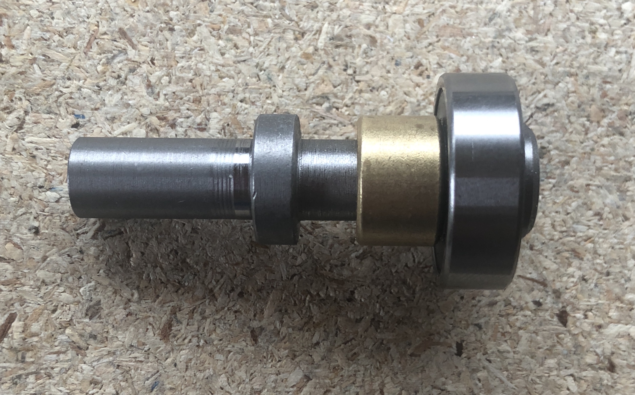

The assembly:
And the instructions:
Having the internal bulkhead as suggested in instructions seems essential to keep the assembly locked laterally.
Did you resolve this Nige?
Any suggestions, or have we missed something here?
Oli

Still a bit of a mystery about this, but in the end I just left it able to slide within housing. Once the rollers and track are on, the track horns hold it all in line fine.
Oli
