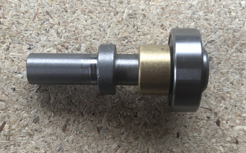

I have just reached this point in assembly and also am not sure how this is intended to work.
The axle and bushing are free to move in and out of the housing by half an inch, only stopped by the bearing.
Here is a video of the issue.
https://youtu.be/0rGrBDrfygc
The assembly:
And the instructions:
Having the internal bulkhead as suggested in instructions seems essential to keep the assembly locked laterally.
Did you resolve this Nige?
Any suggestions, or have we missed something here?
Oli

Apologies to Oli for failing to reply to your question from about a month ago. I'm going to go with the Loctite solution but am waiting until I can put the tracks on to actually fix them, just so I can see how everything lines up.
Nige

I'm building a Panzer III (2018) and I'm running into the same issue.
My roller housings (CL0124) are missing the inside ridge.
I'm thinking the solution is to just glue the bushing in with Loctite 638.
But I'm wondering: Does anyone know why the ridge was removed from the roller housing? What were they trying to enhance/accomplish?
What did you end up doing?

Still a bit of a mystery about this, but in the end I just left it able to slide within housing. Once the rollers and track are on, the track horns hold it all in line fine.
Oli
