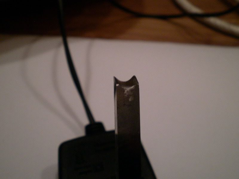

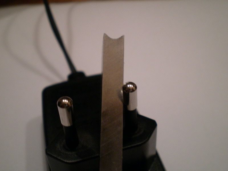

Hi Adrian,
I have made a "profile chizel" to create the desired shape of the wheel. I started from a 6 x 6 mm. tool bit (a special high carbide piece of steel) which I carefully shaped with a rotating grindstone.
This is what it looks like from the top view:
And from the bottom view:
This chizel is positioned square to the face of the wheel.
I hope it makes some sence.
Ad
