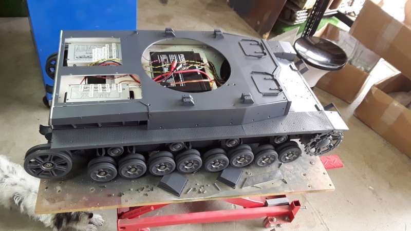

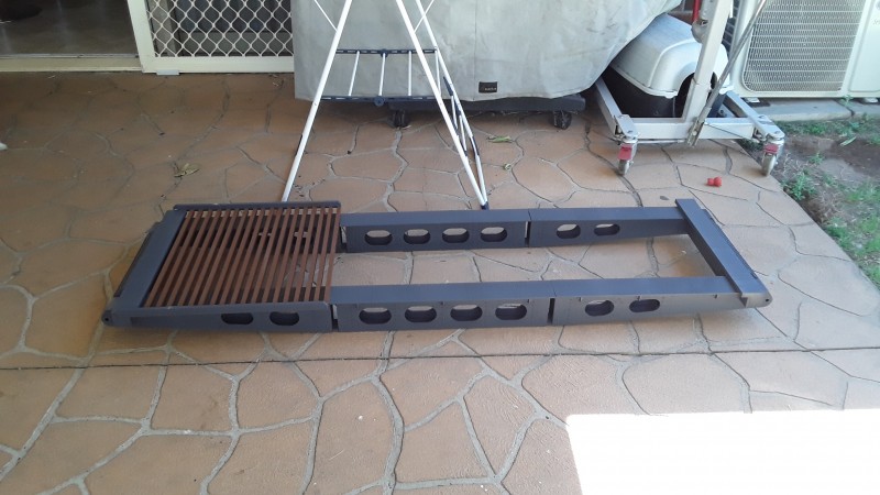

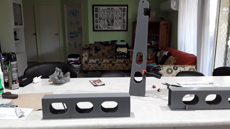

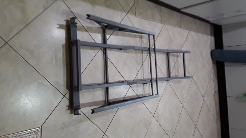

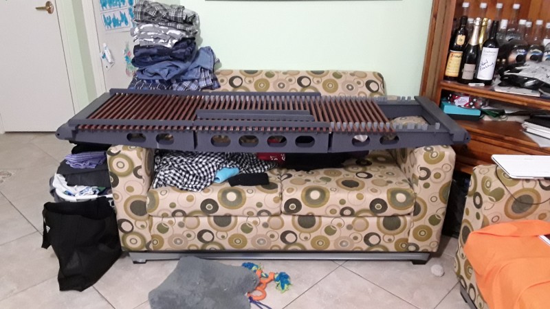

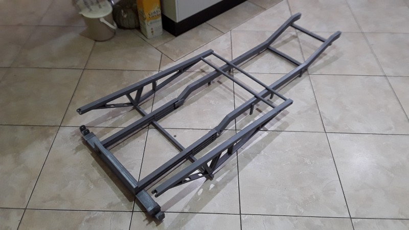

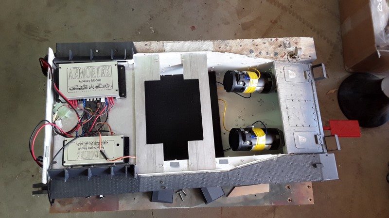

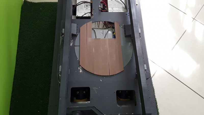

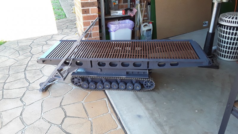

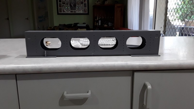

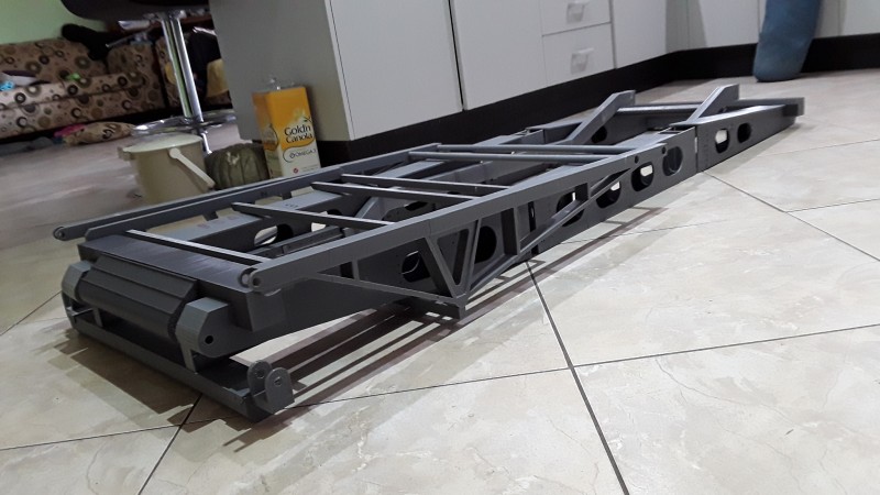

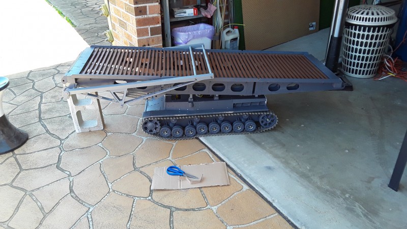

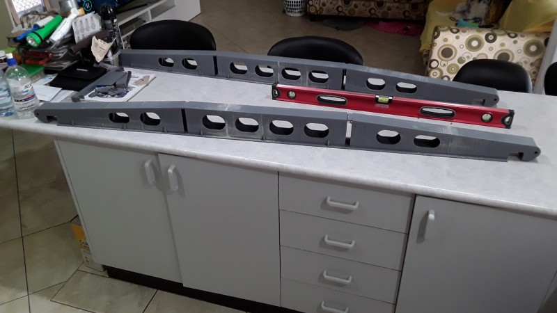

One of many projects running concurrently.
Disclaimer: There is limited info on this vehicle with many obscure photos and 1 not so historically correct Trumpet brand 1/35 model to go off. So due to that and my limited skills, I have been slowly constructing the Bruckenleger with the following results and progress. The Armortek Pz is metal with all bridge parts currently 3d printer prototypes to eventually (no time commitment) be redone in metal. Any verification of correct or incorrect part modeling greatly appreciated. The order of photos unfortunately may not represent the construction time line. As Monty Python used to say, and now for something completely different.
- Posts: 452
- Location: Penrith NSW
- Has liked: 26 times
- Been liked: 103 times
Re: Pz4 Bruckenleger

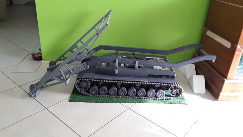

Some modifications have been made since these photos were taken in January this year. As I progress I will add more and also a video with it moving. The large main parts have been printed. Now it's time for the fiddly bits. Cheers.

Hello Ray,
a very nice construction, I'm curious to see the laying process.

Ray,
Excellent and very ambitious project! The printed parts are a good idea to prove out the mechanism and mechanicals.

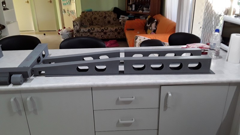

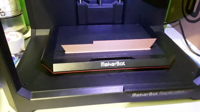

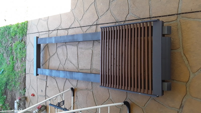

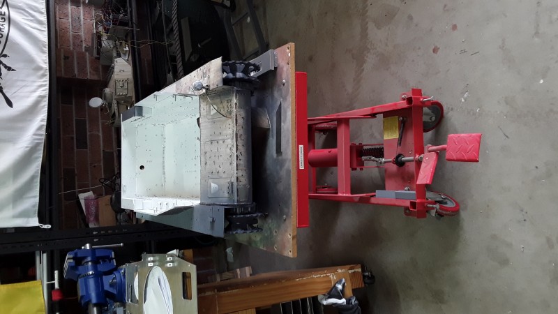

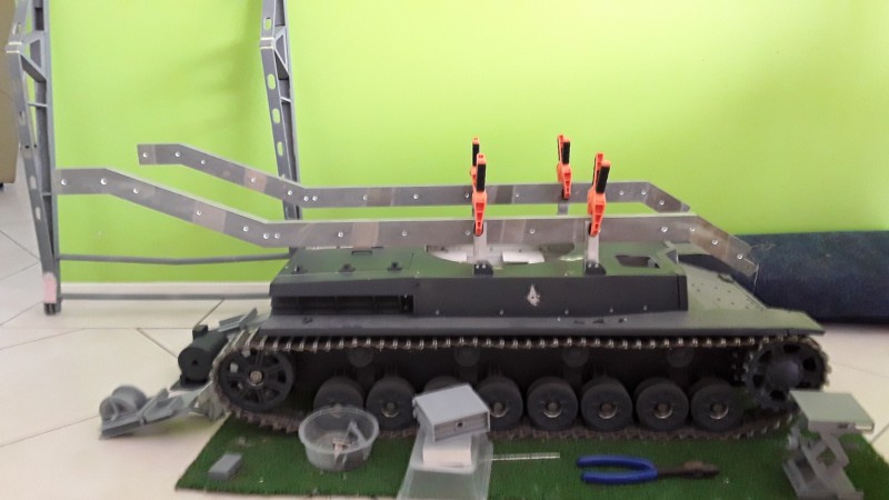

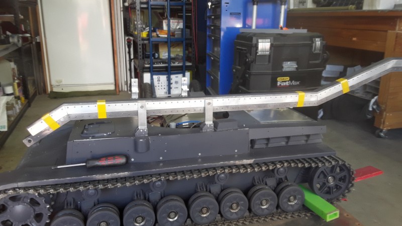

3d printed rear pieces for testing for placement and scaling.
waterjet cut aluminum for the bridge support clamped for alignment before securing with bolts.

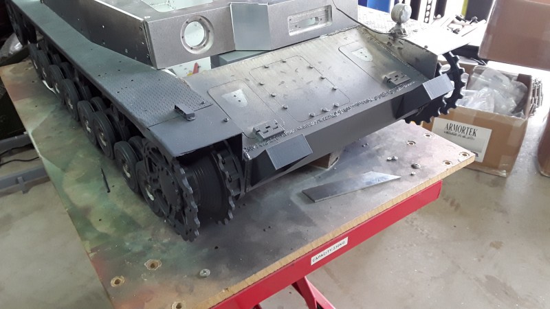

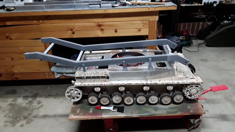

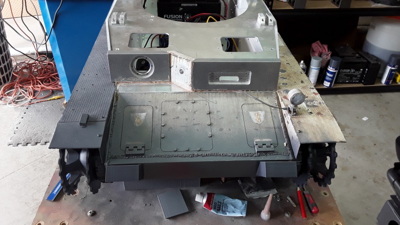

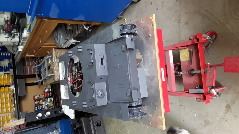

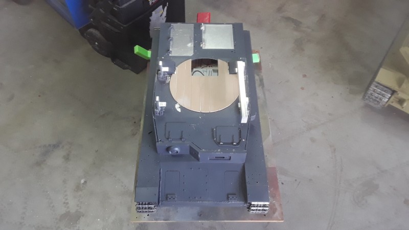

some more pics from the slowest build ever. nearly 900 rivets to be used along with a few 1/16 drill bits.
