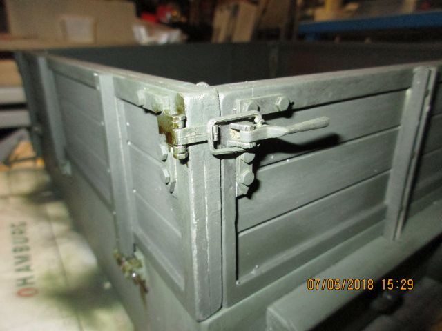

I am currently working on with many small subprojects. So for example the loading wall fasteners of GG cultivated. Very nice small castings made of metal.

I could do with a set of those "loading wall clamps" can you supply a set for me?
Regards Phil.

Please enter a different name for "" loading wall clamps. "" I can not find a translation. "Yes, the winch fits very well.

"Loading wall fasteners" I think you call them. Regards Phil.
These lovely castings of the winch house bolts/fasteners

I got these closures from Günter Gäbelein. Great little cast parts.

Thanks Rolf, do you have a link as I cant find anything on line? Regards Phil.
