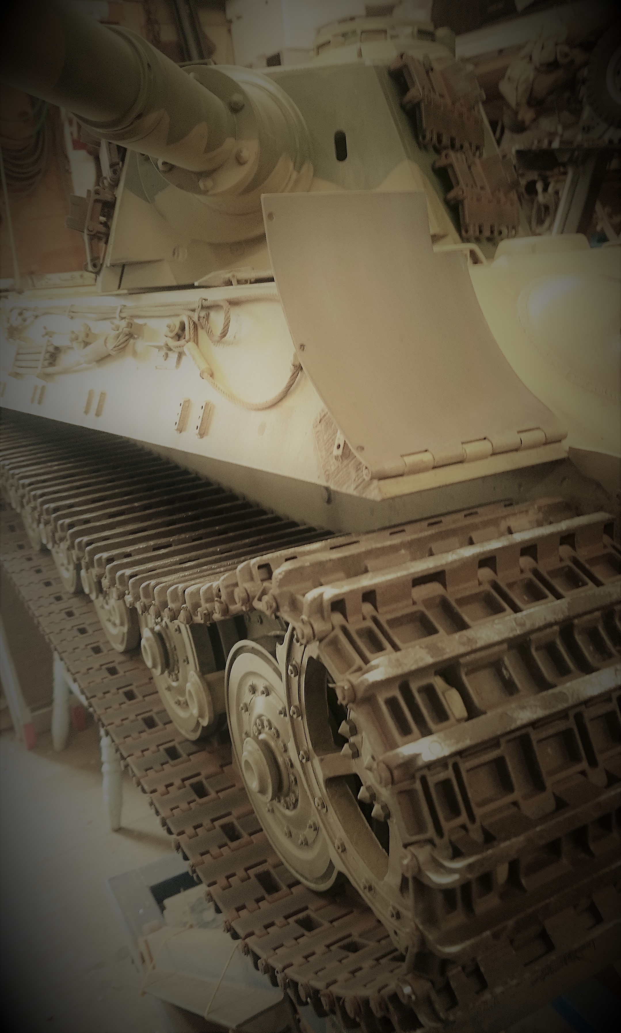

Hi Vince, ref the tracks question, as the track pieces come from Armortek they have a rather nice matt blackish finish which is fine for a vehicle just off the production line, so if your portraying a new vehicle that base is fine, I wouldn't worry to much about cleaning the links first either, maybe just degrease and let them age gracefully, for that aged look a rust wash from a spray pen in all the nooks and crannies then remove the unwanted with a rag and meths. For a used in the field look then you will need to add greys, buff, browns, blacks and rush wash, which takes forever as there are many links as you know each with a myriad of surfaces.The base colour is dependant on the condition in theatre but generally black is a good start.

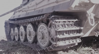

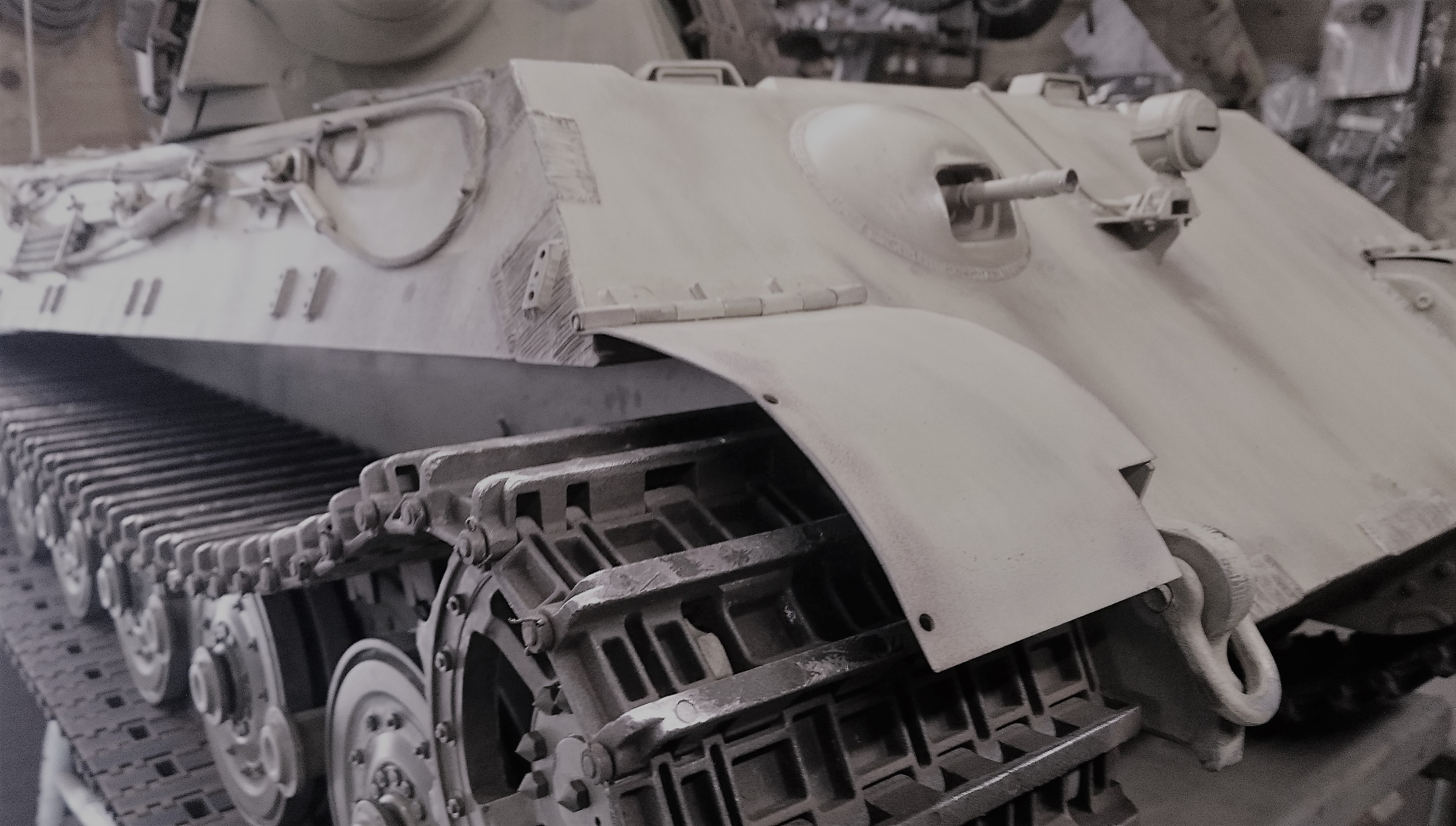

I will remove the tracks and the wheels to weather the lower hull sides

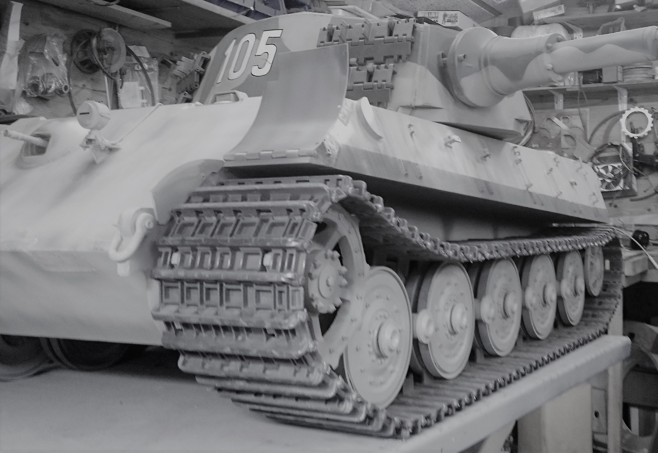

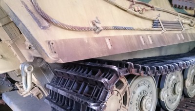

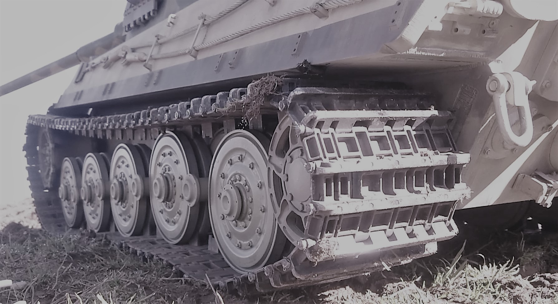

The black on the track face that contacts the ground will soon have that metalic look after just a few hours running

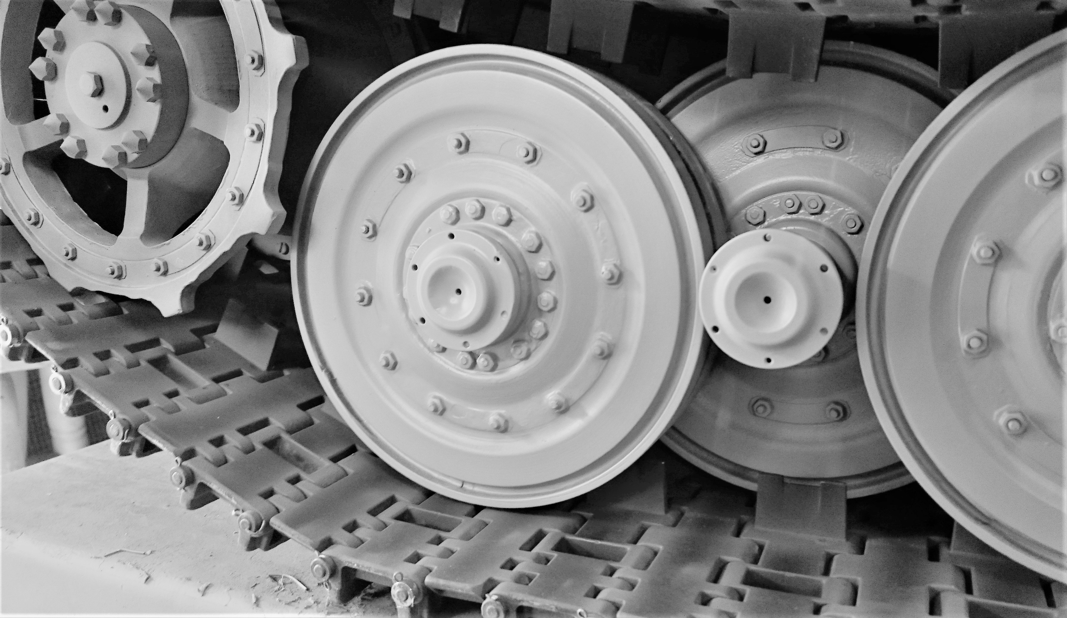

I haven't touched the wheels yet

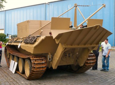

Some nice weathering reference photos for your "rat rods" 8) 8) :D
Please note this is just my humble opinion regarding practical weathering.
What some find hard to grasp is, it's not real, it's a compromise, it's a bit of theatre, it's a lot of theatre, it's practical, it's messy, it can be expensive, it need not be expensive, its time consuming, it's artistic, it's as accurate as it is in the eye of the beholder, it's your own but above all it should be fun and enjoyable! :D :D Good debate.
It would be sad to think that builders could be put off posting on this brilliant forum for fear of their efforts not being appreciated.

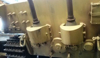

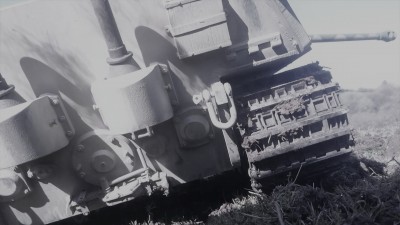

Nice used look
Nice used look

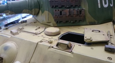

Is that surface rust I see? Nice patina!

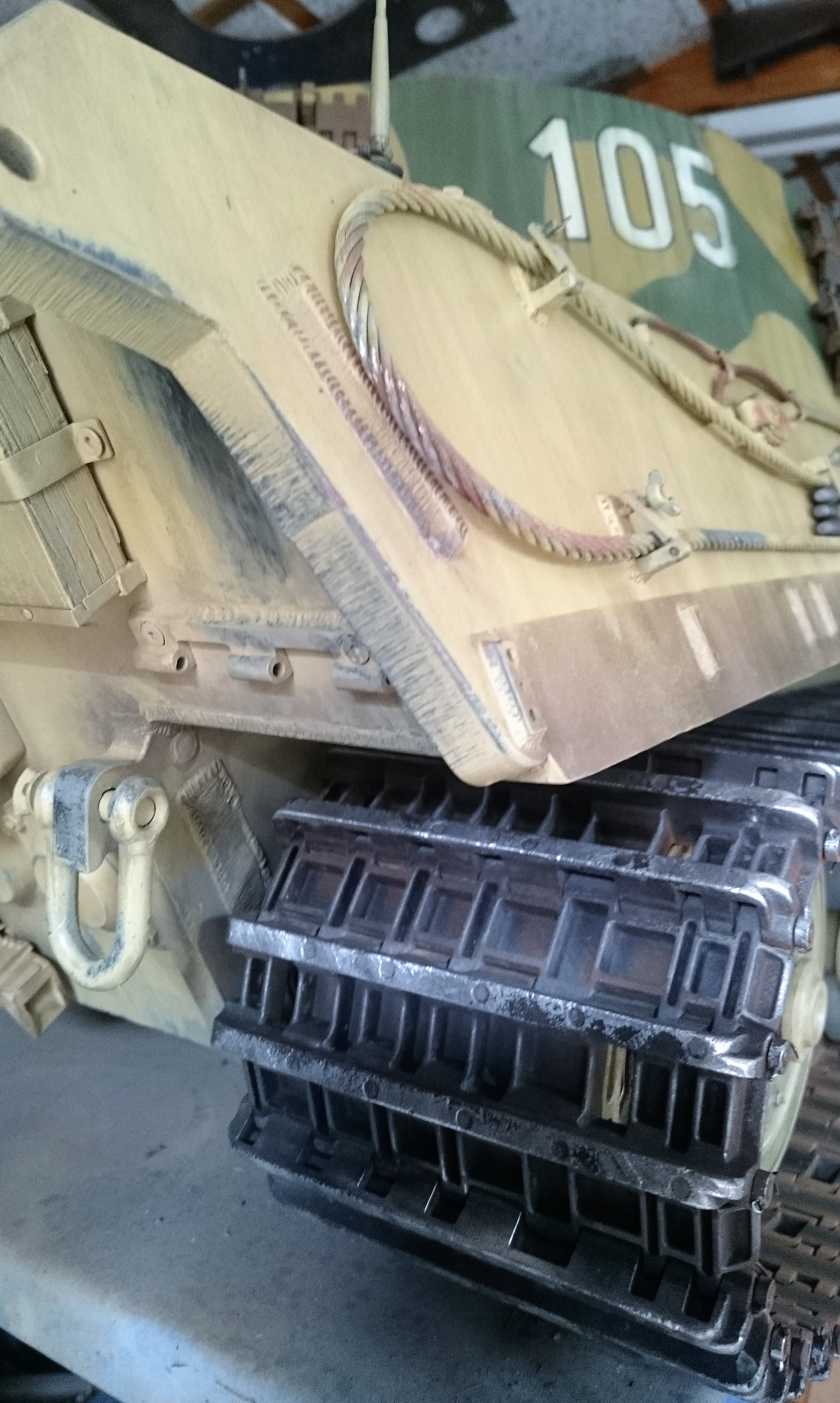

Obviously new/refurbished never run tracks patina

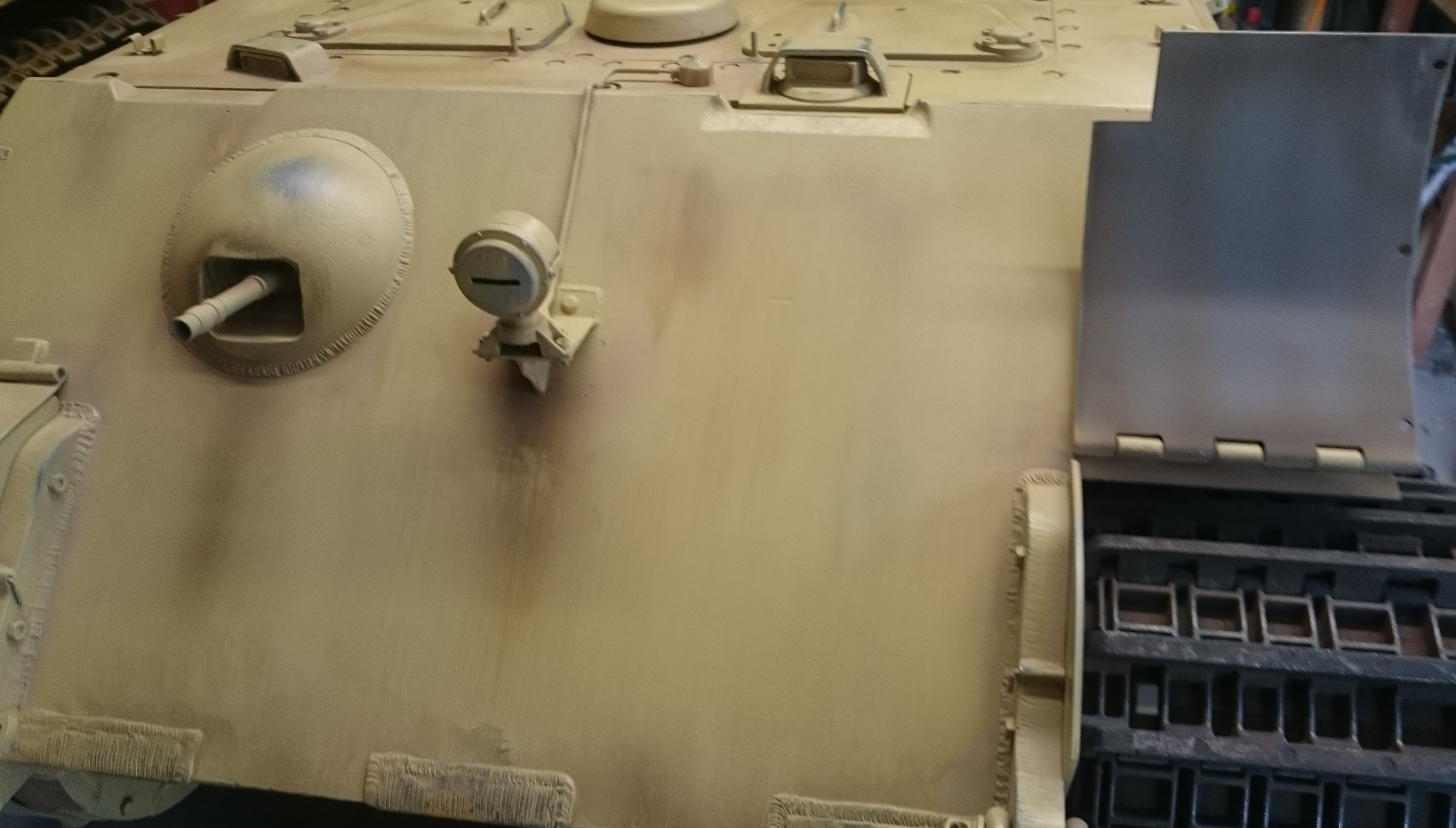

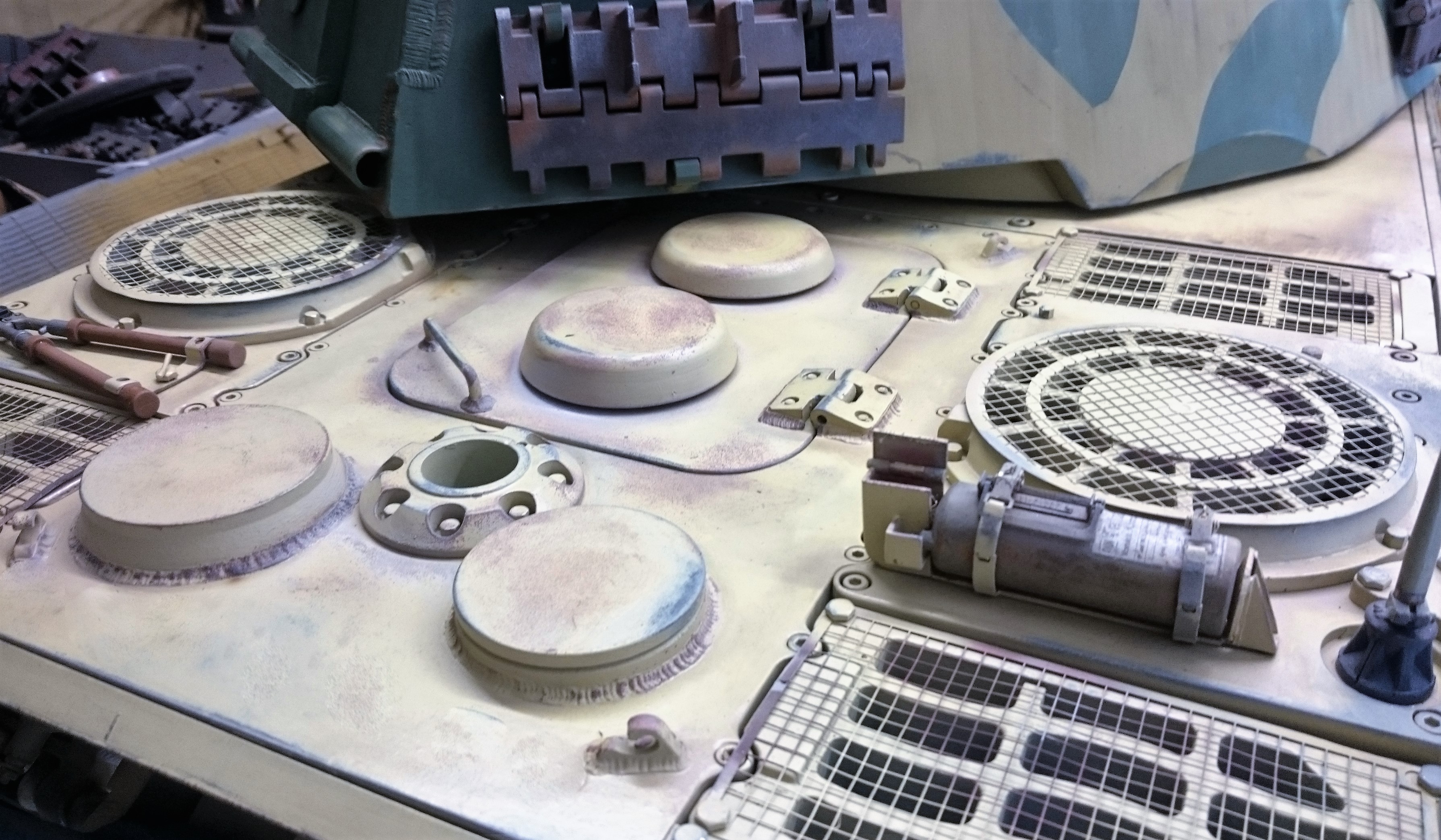

Work in progress starting with the base and rusting areas
Much of this will be removed and or covered by subsequent paint shades.

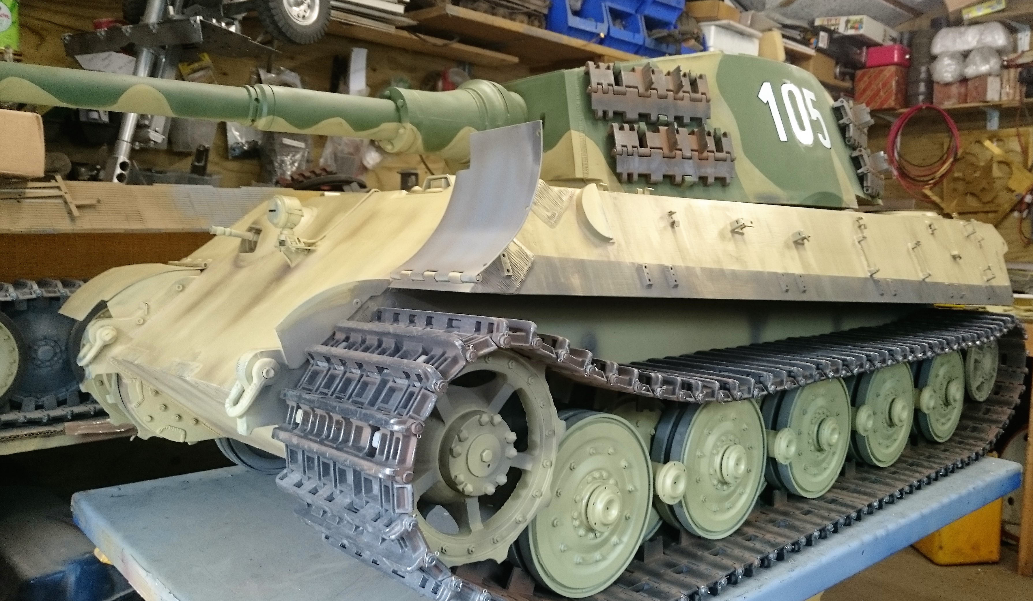

The KT is almost done, just the fiddly details to paint then some test driving trials with some VT see how she looks and sounds, and then she's up for sale.

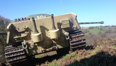

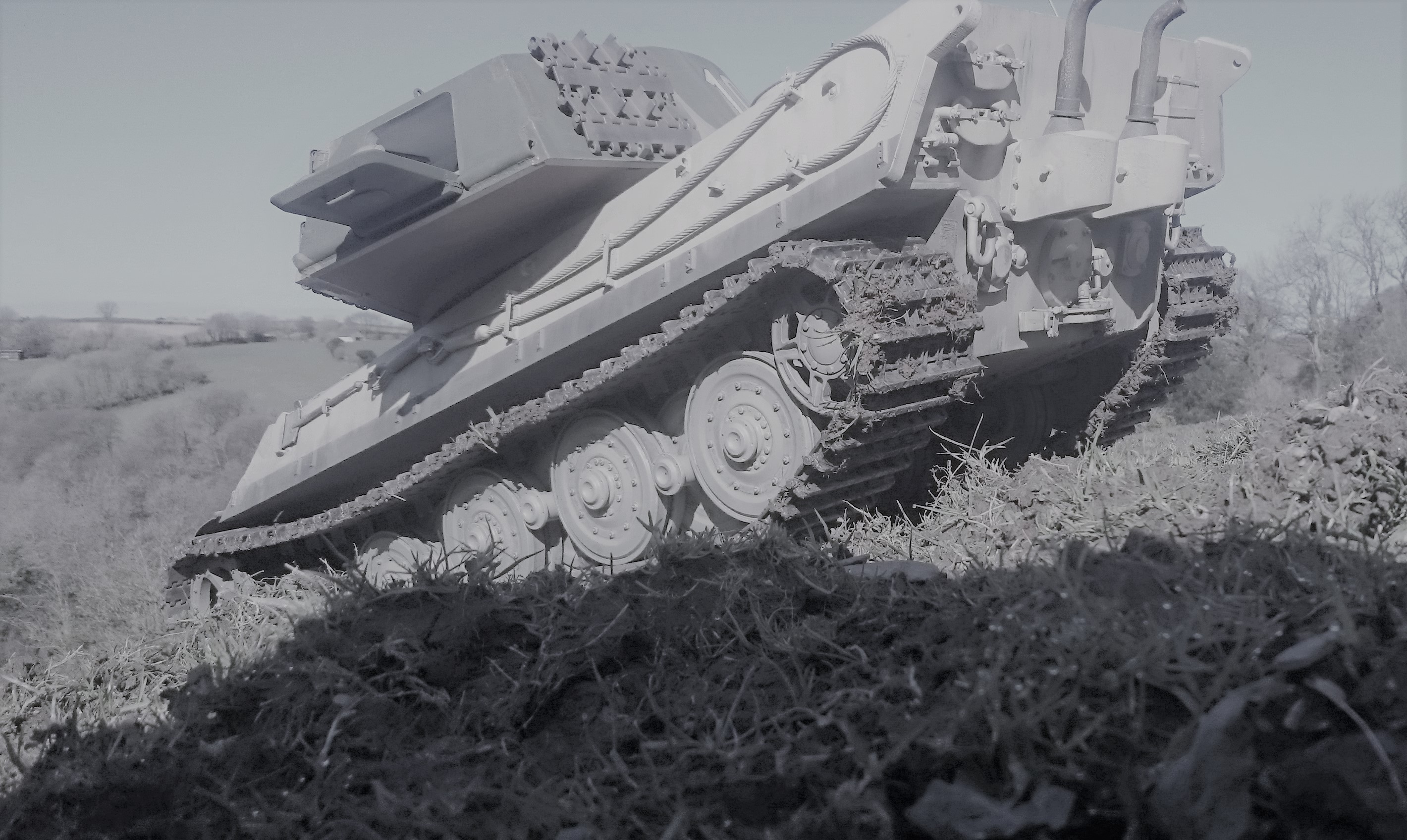

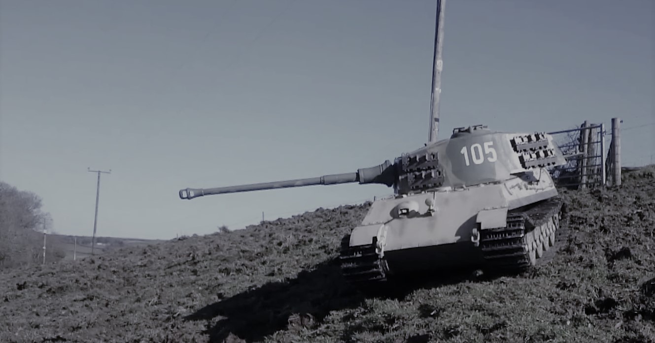

A few stills from the VT this morning.
