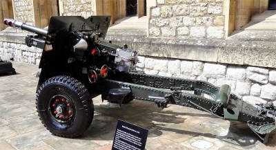

I suppose that I ought to post any progress and photos of the 25 pounder. Although not technically a build it might be of interest to some.
My plans are to paint probably in parade bronze green and pillar box red, but I may initially depict a desert camo scheme as I have plans for an el Alamein photo shoot sometime (be a good undercoat and many examples would have had just that before being painted in parade colours)..who knows?

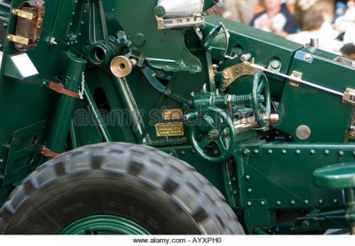

the brass parts will be challenging.
Great detail and tons more to be added.

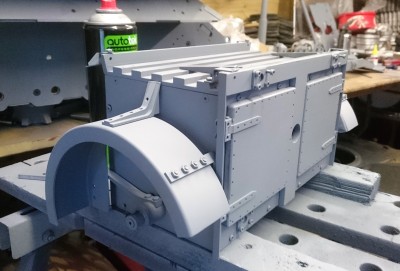

Some progress on the 25 pounder and limber, lots of etch prior to undercoat.

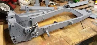

Re: 25 pounder...my plans.
For some reason I can't load more than one photo at a time, so here's another.
