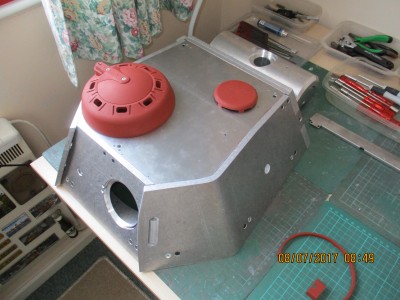

Although not so apparent, I have been busy. I decided to adapt the decks so as to remove them for easy access to the control units inside. The turret top, rear and front decks, all rest on supports bolted to the hull/turret sides. The supports were then drilled and tapped to hold the decks in place. Remove the Allen bolts and lift the decks clear. It's all been done before
...Mick

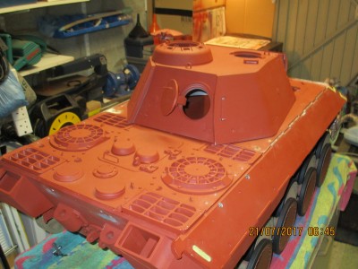

Question time lads, (this is my first model with the 'recoil').
I have installed the recoil bush in the mantlet and the mantlet bush in the mantlet boss. The mantlet boss is also installed in the mantlet.
One bush edge is slightly proud, thereby preventing the barrel from traveling through both bushes. I would welcome your advice as I do not want to file/cut the bush lip, before asking....Mick

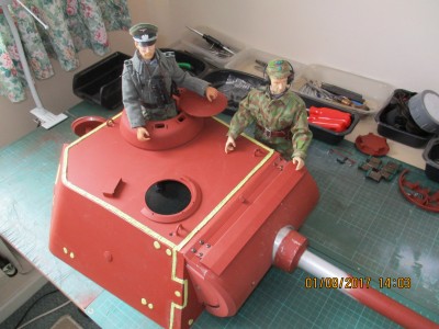

Should have made a start on the 'tracks' today. Decided to get the welding torch out and complete the turret.....just as I finished, two of the Panther crew happened by.....Mick.

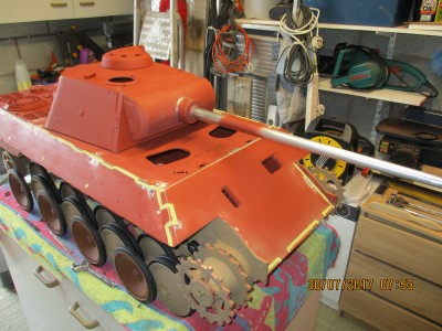

Finally, and because it is 'tipping down', made a tentative start on the tracks. I noticed that the 'chevrons' drawn in the instructions are facing the opposite way on the actual tracks. In the track assembly view the outer 'chevrons' are also facing to the rear. I have started to assemble the track links as per the drawings
....Mick

Ummm, yes assemble as per drawings and hang them the same over the sprockets, second pair of gloves!
Not my favourite job I must confess but she's nothing without them ..Phil

Thanks Phil, I have completed one set of tracks assembled as per the drawing, ignoring the 'chevron' facing. I will attach the tracks as the instructions for fitting, again ignoring the 'Chevron'. I do not believe they add much to the traction anyway.....That should prompt a comment or two
