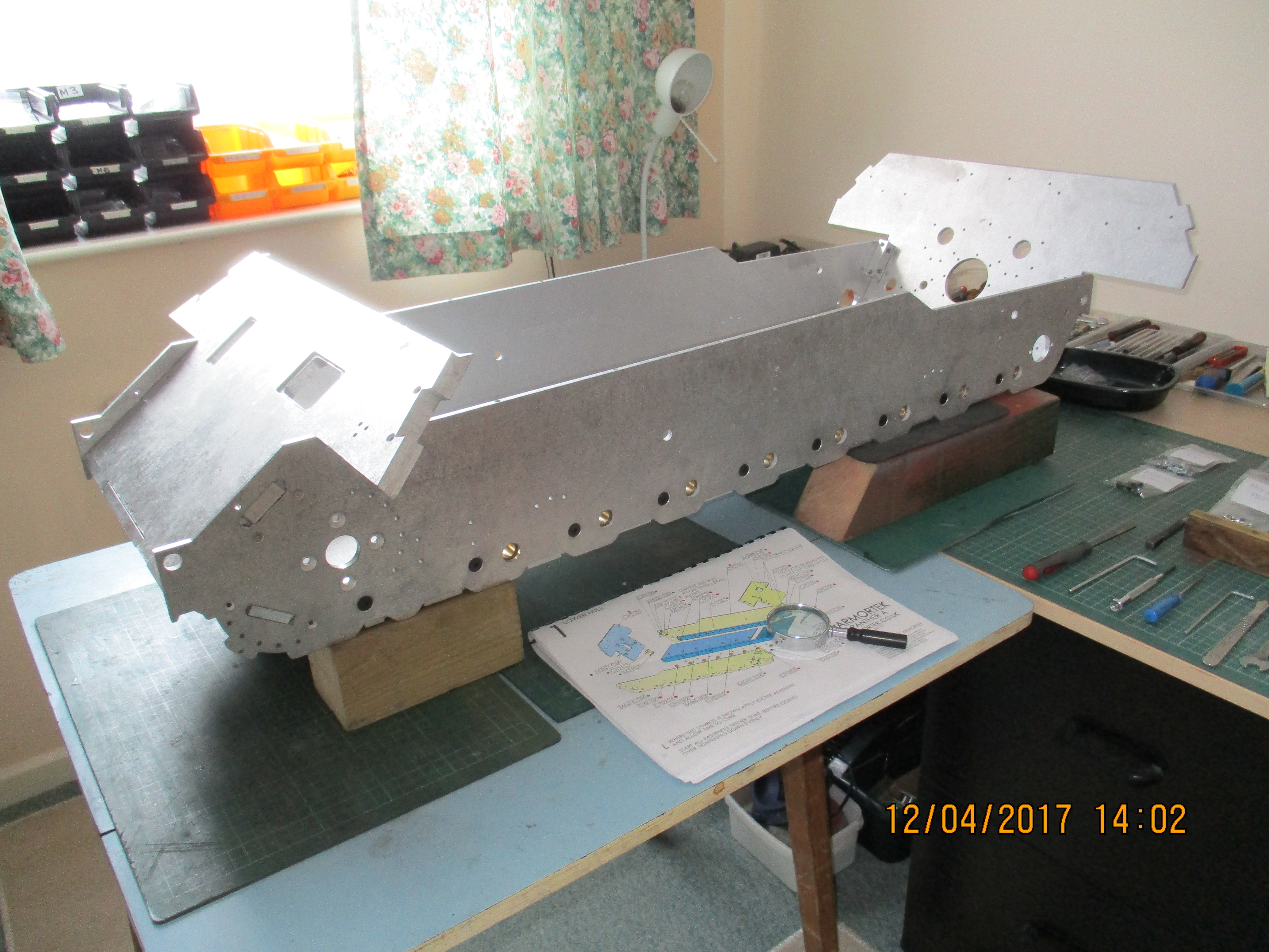

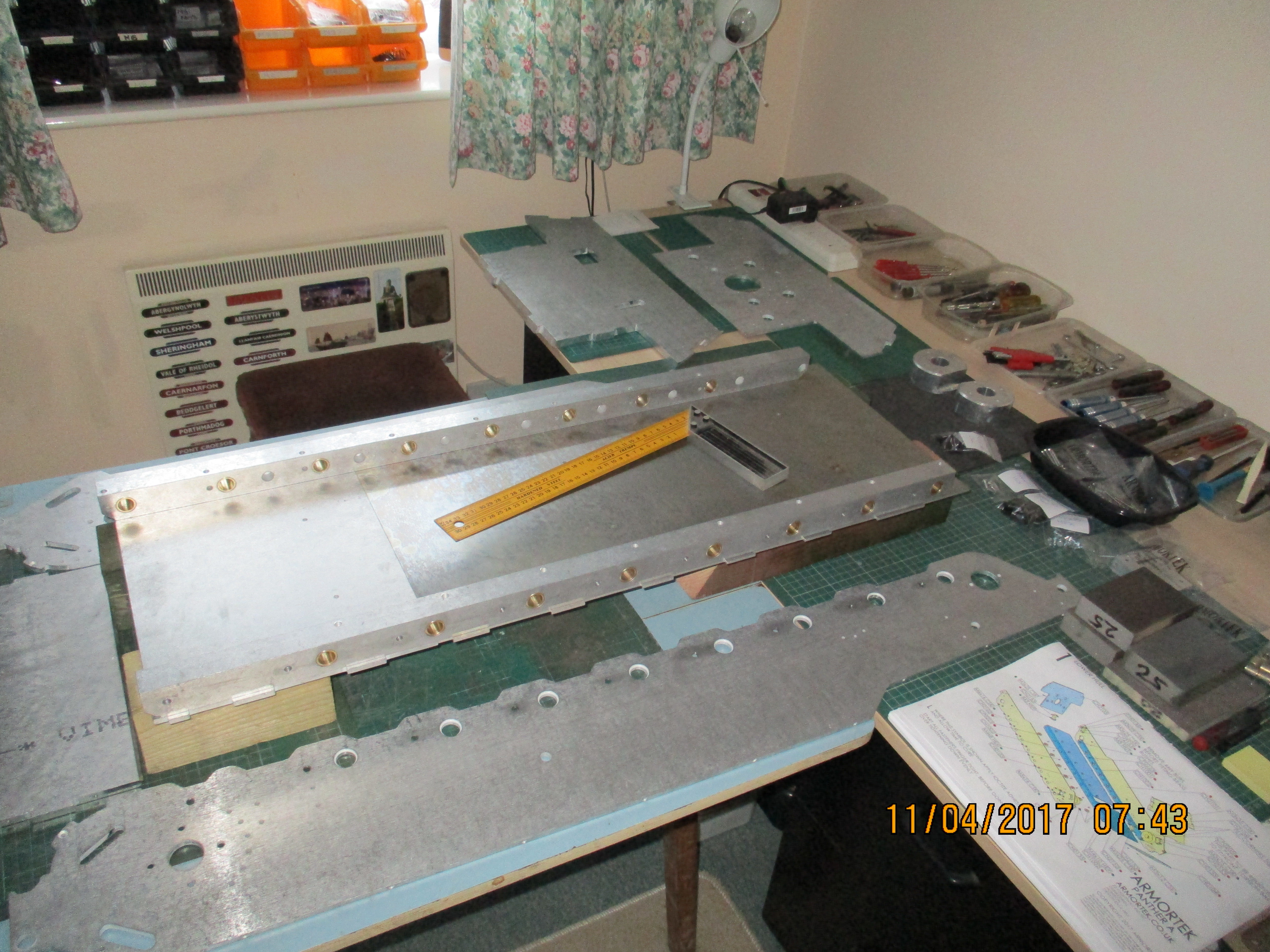

My Panther kit arrived and is located in the garage. I am advised by management that, covering the double bed in the spare room with Panther Kit parts is no longer acceptable. Visiting family members are unable to get a good nights sleep.....due to the weight of the parts on the duvet.....don't you just love the ladies. Back in the real world the Panther A kit is massive, quality assured product. I made a tentative start with page one of the instruction booklet this is going to be a most enjoyable build.....Mick

Further progress, minimal work with a small file and it all slots together....well pleased.....Mick

Re: Mick's Panther A
I sense another really neat build afoot! Did you not have the alignment issues with the suspension bars that Steve did with his?
Hello Peter, no problems, The hull is square and the suspension/setscrews/side plates etc., all line up. I have no idea what happened with Steve's build. I use a magnifier to closely follow the outline drawings. I am not as far in my build however, I can only post as I find....no problems whatsoever. I have used 'loctite' on the brass bearings, which located easily....onwards and upwards....Mick

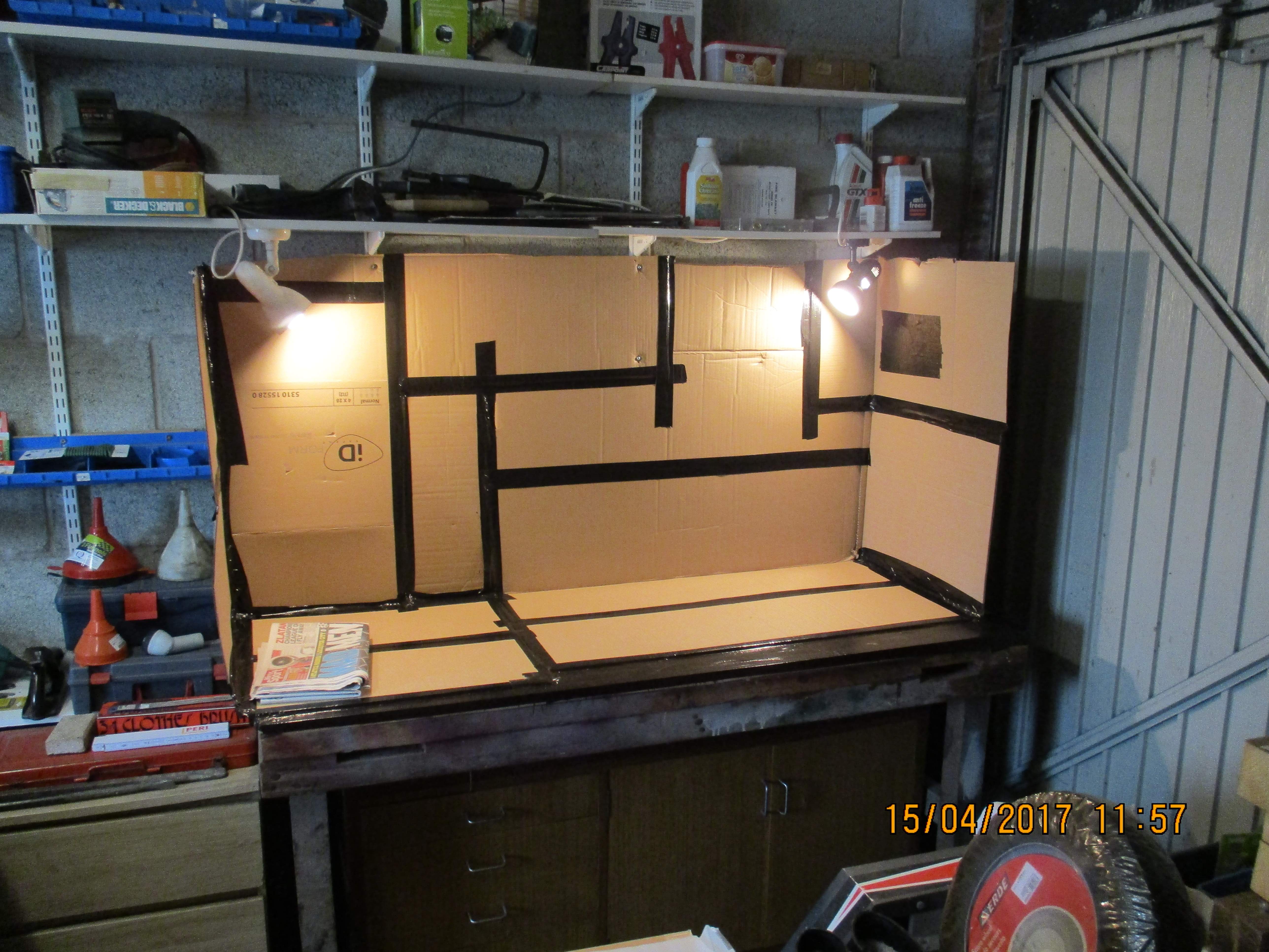

Held a meeting, it has been decided that, as the Panther A is a huge model and very heavy, more space is needed. The hull alone is already heavy, so, with the improving weather, I will relocate said build into the garage. Obvious really.....Oh, and another use for Armortek packing boxes...

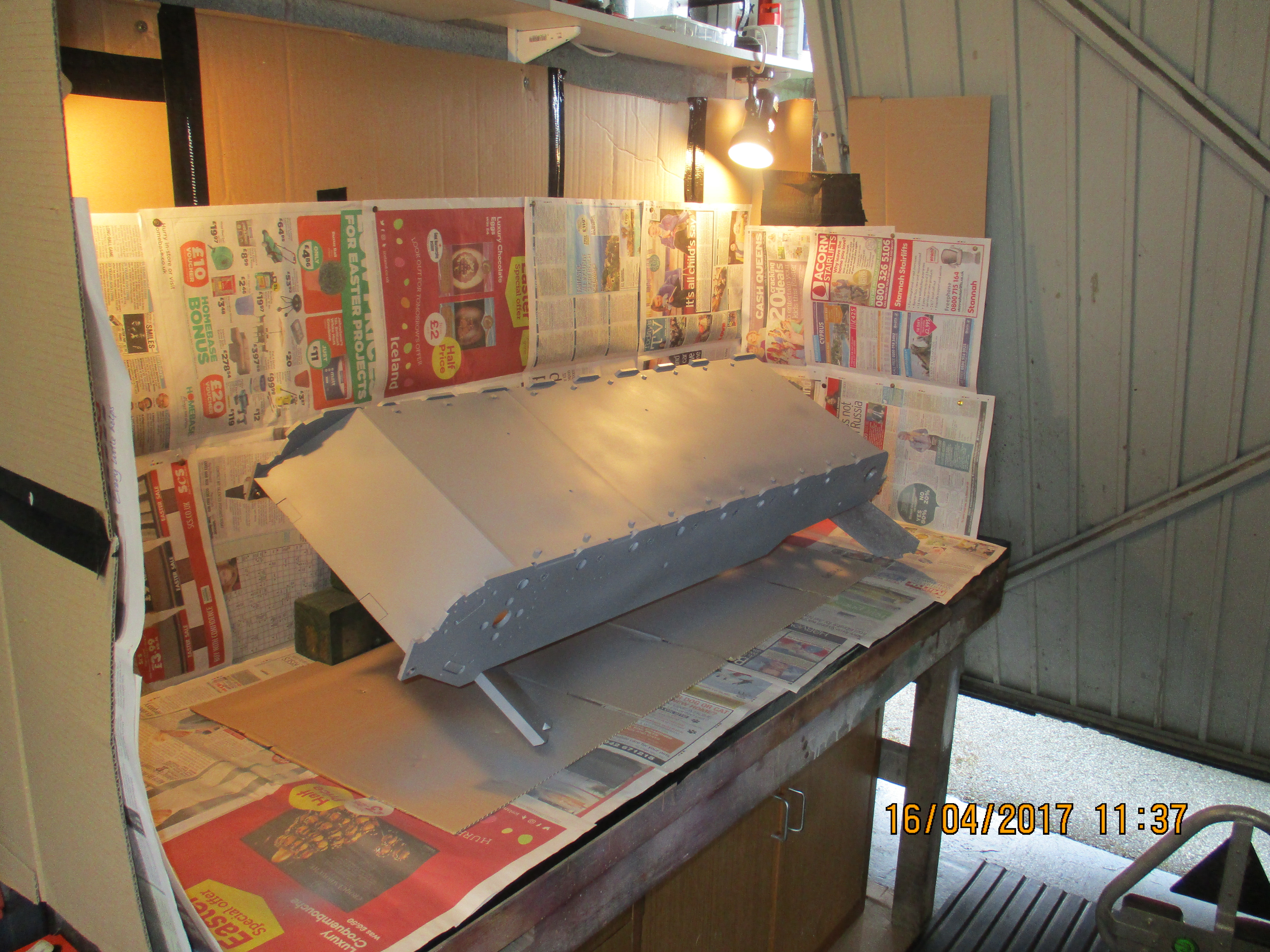

Thank you Dennis, Paul and Yves. I have all the permissions required for use of the very small third bedroom....as you all are only to aware these beasts become extremely heavy and difficult to manage in a limited space. So, I will fit the suspension to the hull, in the bedroom workshop and then transfer the Panther to the garage. The weather is fine so I took the opportunity to spray an acid etch primer. I will paint the inside of the hull before fitting the suspension.

Good progress being made there.
Just ensure everything is square,I only noticed the misalignment on mine when I had the upper side plates fitted and went to install the hull top plate.
Coming along there nicely Michael. Hope you are using a proper painters mask with disposable filters when spraying that etch primer- the stuff is absolutely lethal to the lungs!
Thank you Steve and Peter, I have a suitable paint spray mask, also with the garage doors open front and rear most of the primer was blown outside by the wind..... Steve, I have checked very carefully while building the lower hull, all is well. Enjoying the build ....Mick

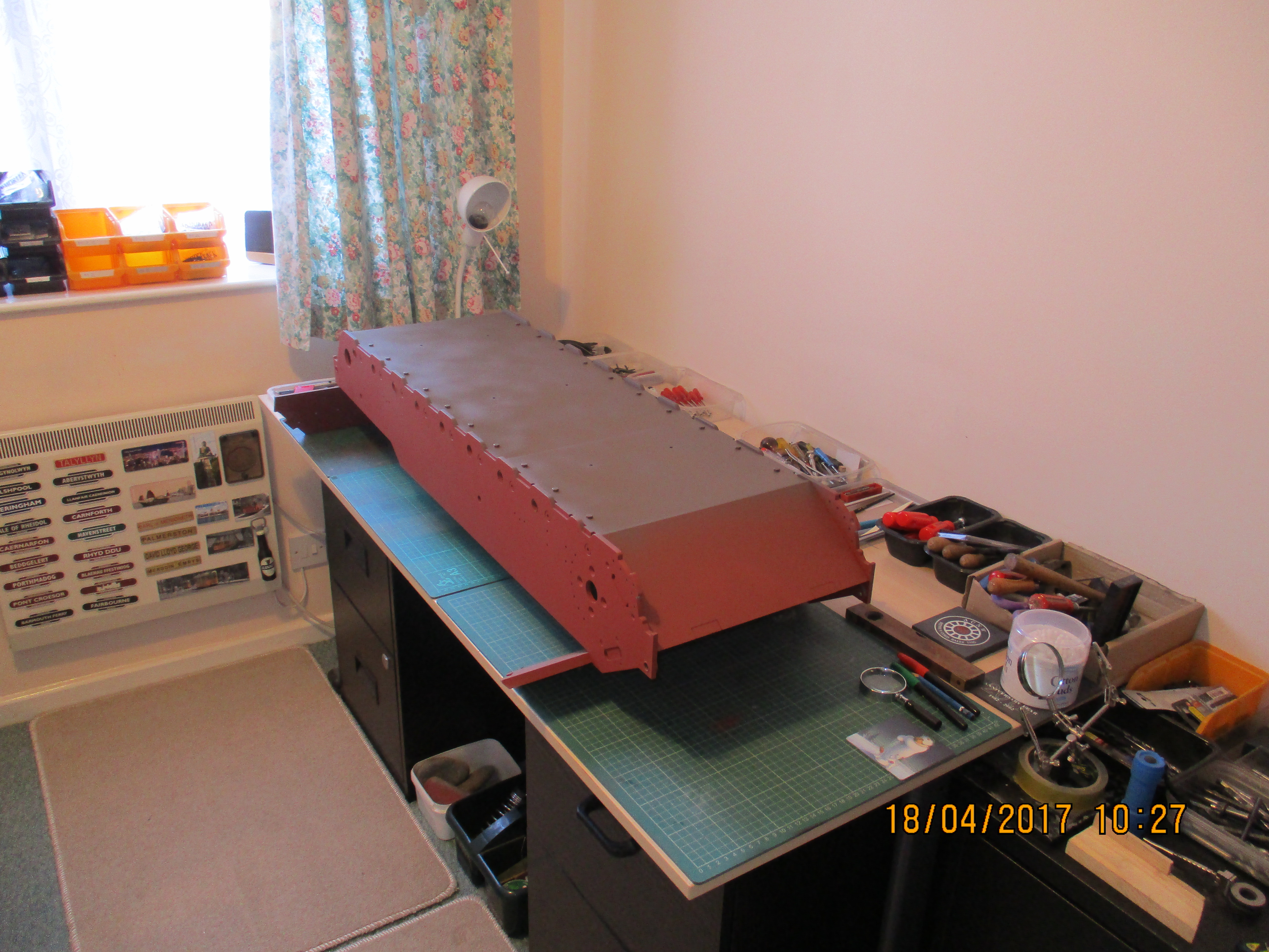

Wouldn't you just know it, the Sun comes out.....the lawn needs cutting....I managed to top coat the underside....once she is turned over never to be seen again, that's that.....Mick
That'll be a bottom coat on the top then Mick? Glad you're enjoying the build, in your various workshops. Thanks for posting. Stephen
