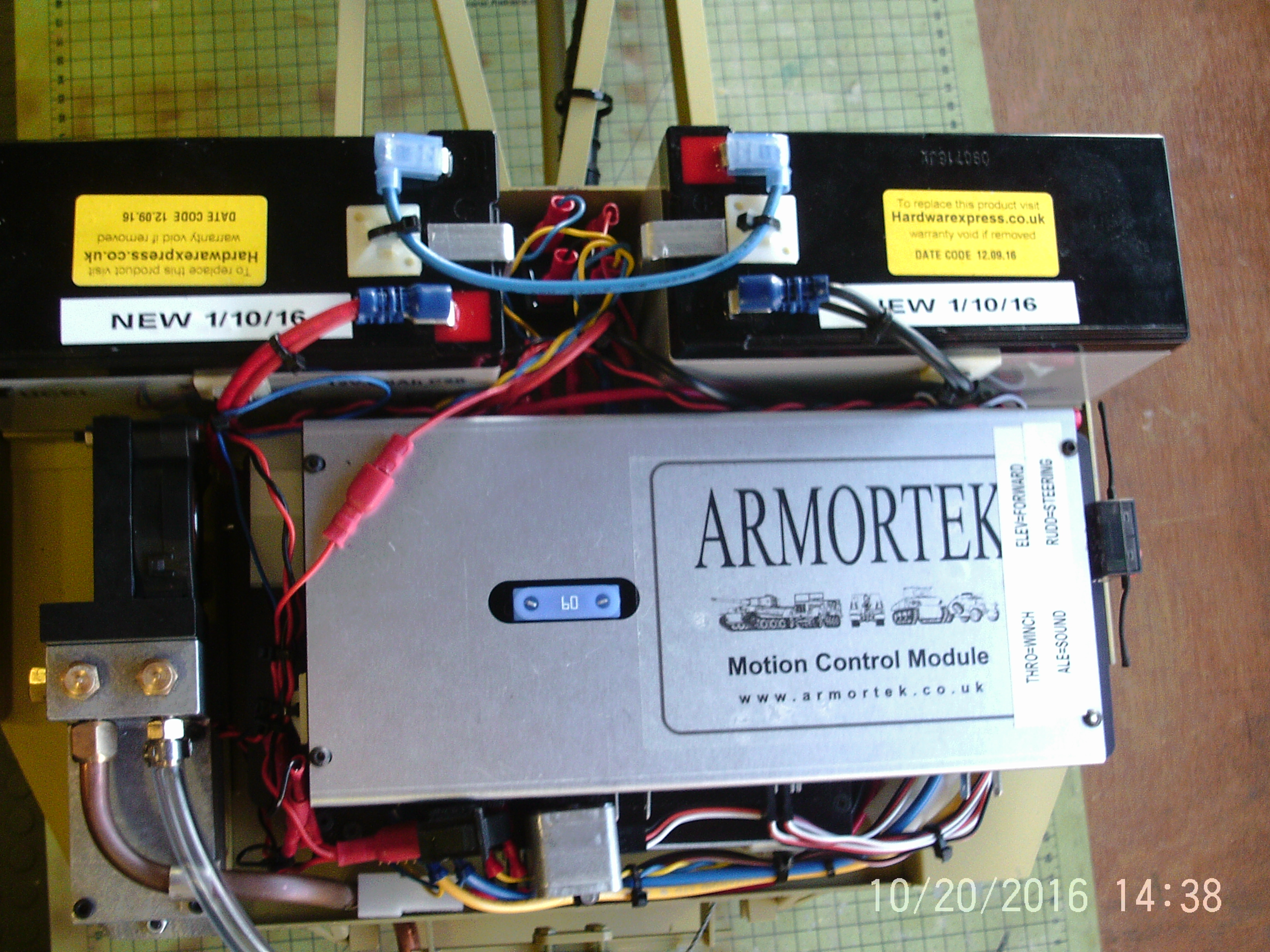

Mike, in seeking "best practice" for routing and tidying the wiring for the motion control and audio modules I have noticed in a photo you put on p7 (?)of this thread what appear to be adapters for the spade connectors which enable the cables to be placed at right angles to the module spade connectors. This shows the cables emerging parallel to the face of the modules not jutting out thus creating some much needed space.
Unfortunately I cannot work out from the picture what connectors you have used to achieve this. Web searches have only suggested "piggyback connectors" but these don't achieve the desired 90 degree shift.
Can you shed some light on this minor but potentially very helpful solution??

In the absence of an answer from Mick, it looks to me like he's enlarged the hole in a standard 1/4" spade connector like these:
and just bolted them at 90 degrees to the spade connectors which stick out from the Motion Control Module.

That does seem to be the case and is certainly one solution.
A number of places do sell right-angled / L shaped spade connectors which would also work.
Check out Amazon UK, Maplin, RS online and such like.

found these on ebay, simple search of 90 degree spade connectors was all it took, bit fiddly to crimp as you cant slide the sleeve back to crimp/solder them and there isn't a crimp tool to do the job neatly, if you get let down let me know,

Hello Martin, sorry completely missed your post. I simply drilled a larger hole in a standard spade connector and turned the connector 'upright'.....Mick
