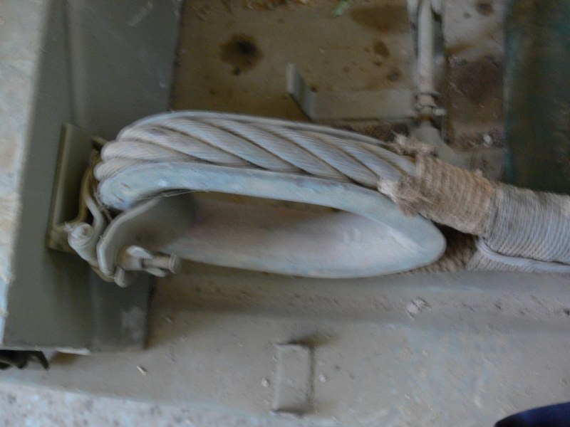

The photos in my post above are of a Comet tow rope in storage at Bovington. There is very slight evidence of surface rust but the rope is no longer serviceable. Here's another:
Hope this helps.

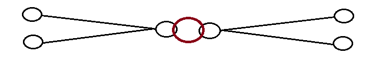

Thanks Stephen, I did double up each length of rope but added a single eye to each end.
If i understand correctly, i need a single eye at one end and 2 eyes at the other end of the cable.
the 2 single eyes are connected by the pear shaped ring.
Effectively this creates 2 Y shaped cables joined together at the single eye ends. I would have a total of 6 eyes for the entire assembly
I guess this would allow the 2 eyes to be connected to the 2 towing brackets on the front or rear of the tank to create an evenly distributed tow.
I will have to partially redo mine now, but at least i have some spare connectors.

Hi Steve, I think (hope) this is what Stephen means.
I will wait for confirmation before i hack mine apart.

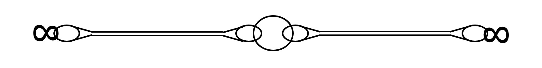

Tim, you had it the first time! Have another look at my diagramme.
It's like this:
I think the confusion might be over the doubling up of the cable. In your diagrammes, No 1 is correct, noting that each half is of double thickness.
The cable consists of two 30ft lengths of 7/8th inch thick wire, four eyes, a pear shaped ring and two self closing fittings.
Each of the 30ft lengths is doubled up and bound around an eye at each end. You've now got two identical assemblies, each 15 ft long, of double thickness and with a single eye at each end.
Now join the two sections with the pear shaped ring and at the two free ends, attach the self-closing fittings.

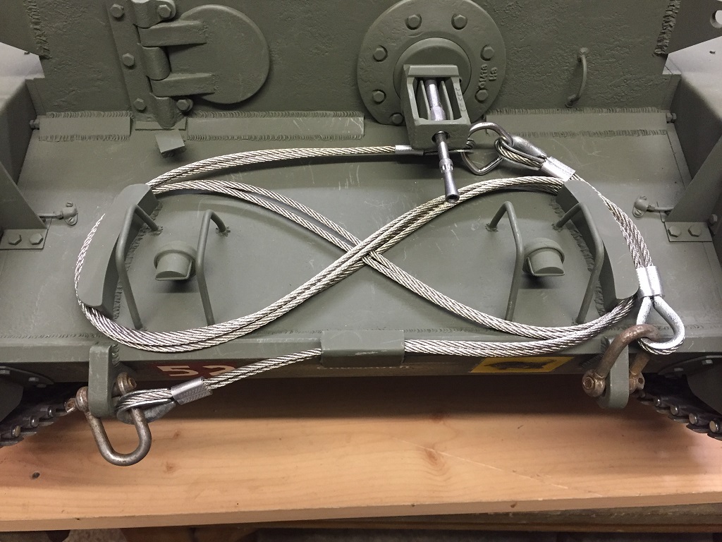

Hi all, Ive fitted the cables that i made last night and hope that these photos will show what i did.
I will have a go at weathering them a bit (but no rust) over the weekend.

Re: Comet tow cable ?
Tim.
That looks good, I now see how the cable was assembled.
British engineering at its best, why have simple tow rope when you can make something really complicated.
