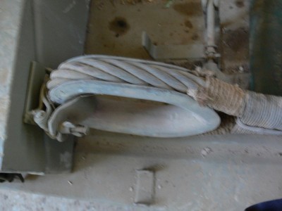

The photos in my post above are of a Comet tow rope in storage at Bovington. There is very slight evidence of surface rust but the rope is no longer serviceable. Here's another:

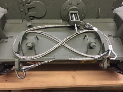

Hi all, Ive fitted the cables that i made last night and hope that these photos will show what i did.
I will have a go at weathering them a bit (but no rust) over the weekend.
Tim

Re: Comet tow cable ?
Tim.
That looks good, I now see how the cable was assembled.
British engineering at its best, why have simple tow rope when you can make something really complicated.

Hi Derek, i got them from ebay and were not very expensive.
I have 4 crimps and 4 eyes left over that you can have FOC.
I can either hand them to you if you are going to Tigerday or i can post them if you let me have your address via PM.
Tim
