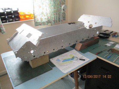

Further progress, minimal work with a small file and it all slots together....well pleased.....Mick

Hello Peter, no problems, The hull is square and the suspension/setscrews/side plates etc., all line up. I have no idea what happened with Steve's build. I use a magnifier to closely follow the outline drawings. I am not as far in my build however, I can only post as I find....no problems whatsoever. I have used 'loctite' on the brass bearings, which located easily....onwards and upwards....Mick :D

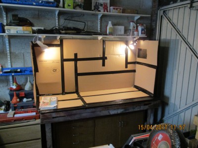

Held a meeting, it has been decided that, as the Panther A is a huge model and very heavy, more space is needed. The hull alone is already heavy, so, with the improving weather, I will relocate said build into the garage. Obvious really.....Oh, and another use for Armortek packing boxes... 8)
Also doubles as a paint spray booth

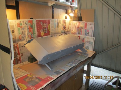

Thank you Dennis, Paul and Yves. I have all the permissions required for use of the very small third bedroom....as you all are only to aware these beasts become extremely heavy and difficult to manage in a limited space. So, I will fit the suspension to the hull, in the bedroom workshop and then transfer the Panther to the garage. The weather is fine so I took the opportunity to spray an acid etch primer. I will paint the inside of the hull before fitting the suspension.
I have just cause to remember the Comet Dennis, :roll: having almost driven it off the dining room table.
Ian, I use a medium strength Loctite 243......Mick
I like to read the paper while spraying...

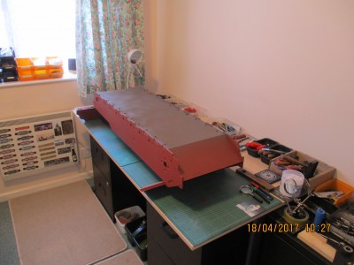

Wouldn't you just know it, the Sun comes out.....the lawn needs cutting....I managed to top coat the underside....once she is turned over never to be seen again, that's that.....Mick :wink:
Mud brown...
Mud brown...
Has liked: 1040 times
Re: Mick's Panther A
That'll be a bottom coat on the top then Mick? Glad you're enjoying the build, in your various workshops. Thanks for posting. Stephen
