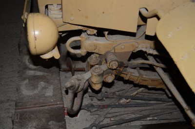

Hi Adrian,
As pm, please see the below photos, I hope these help.
