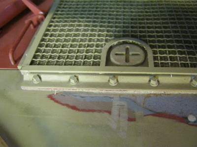

Re: Tiger 1 (Early Variant) 2004 #98 build
Hi Graham,
I used UniBond Repair Epoxy Adhesive, 10 years and it hasn't come loose yet.
plus all the clamps I had.
Looking at the photos of your deck, if you are looking to make the tiger more detailed you might want to think about changing the deck bolts. Just ask Gill if you can buy some square headed deck bolts, Mark made them for the later releases.

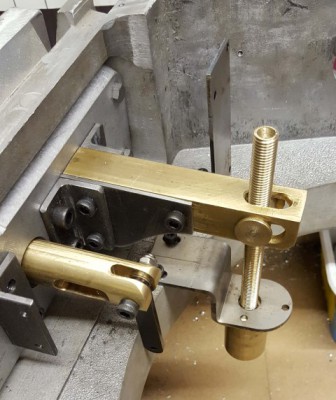

Started on the interior controls for the gun and thanks to Adrian I now know what bits I have to help me. In the photo the first attempt at the elevation of the gun with my own brackets. I think that the screw needs to have a bearing underneath the motor holder take the weight of the barrel and the motor mounted on a subframe under the motor bracket. I also need to make a longer screw incorporating a thrust bearing. Any comments?

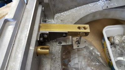

Mark 1 tank gun mechanism. A new barrel elevator screw waiting for a thrust bearing to be delivered. The recoil arm may be set vertically or horizontally, any comments anyone?
You might want to think about rephrasing that - Mark-1-Tanks are Armortek's only direct competitor in the UK
It will depend entirely on the orientation of your recoil servo.
