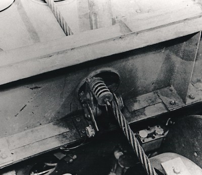

The original Bergepanther had a traction dynamometer, Zugkraftmessers, fitted:
Bergepanther Zugkraftmessers
In some diagrams this is incorrectly labeled as a "cable tensioning device".
The ETOUSA Intelligence Report No.167 includes a brief description under the Winch heading. It confirms that the device was adjustable, should be set for 40 tons and would trigger a red warning light near the winch operators position if the load exceeded that. It ends with the note, "There is no positive cut-out." So the model is accurate in that respect!
The Bergepanther crew were reminded with a special Note (Beachten) on p29 of D659/4 "Bergen von Panzerkampfwagen" It translates (roughly) as, "Observe the 40-t-limit (sic) Warning Light and Dynamometer Needle Scale. Should the Warning Light illuminate, stop the Winch immediately". The ETOUSA report omitted to mention the needle scale on the device itself.
The key to trouble-free operation seemed to be to keep the cable under tension both when paying out and pulling in. The winch was very prone to the rope riding off the capstans. This was picked up in the original Kummersdorf Field Tests, repeated in reports from the Front, and observed again in the Allied Technical Intelligence evaluations. One of the factors causing the rope to slip off was contamination with mud and small debris. To clean this off a clam-shell set of spiral brushes was devised and mounted on sprung curved rods outboard of the Seilfuhrung (roller fairlead) at the rear. Good pictures exist on p16-1-64 of Panzertracts 16-1 Bergepanther book. They did not work in real life but set me thinking...
