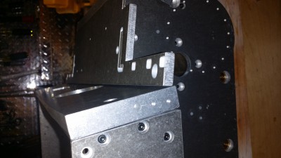

The only problem I have so far is with the upper front plate. As I mentioned it was not meeting the lower front hull. I put a 45 degree on the underside and it closed up.
Now I have a similar problem where it meets the glacis.However grinding is not going to bring it closer. Should I have some aluminum tacked on? I have a retired aluminum worker living around the corner with a full shop in his garage.

I will take that route. My concern is that I am forcing something or just plain have something backwards. This was the only piece that just would not go.
I could bevel the back edge and split the difference with the front, but there is no point.
Jb weld will take care of it.
If my aluminum gut wants to add a piece on it I may let him but there's no point really.

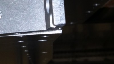

I have ran into a problem I have seen before. The pannier floor seems to be about 1'16 to wide. (forgive my colonial measurements, I am an American woodworker)
I take it I should file the high spots until the gap disappears.

Posts: 5132
Has liked: 1485 times
Been liked: 1695 times
Re: Mid Production Tiger Kit
Squaring off the folds should take care of the excess width.
See here:
http://www.armortek.co.uk/Forum3b/viewt ... 38&p=24059
John Fitzsimons
Posts: 1868
Has liked: 6 times
Been liked: 813 times
Post by John Fitzsimons »
As Adrian says, the folds throw it out of whack. If you look along the profile you should see what is causing the problem. The is the same with every Tiger kit.
