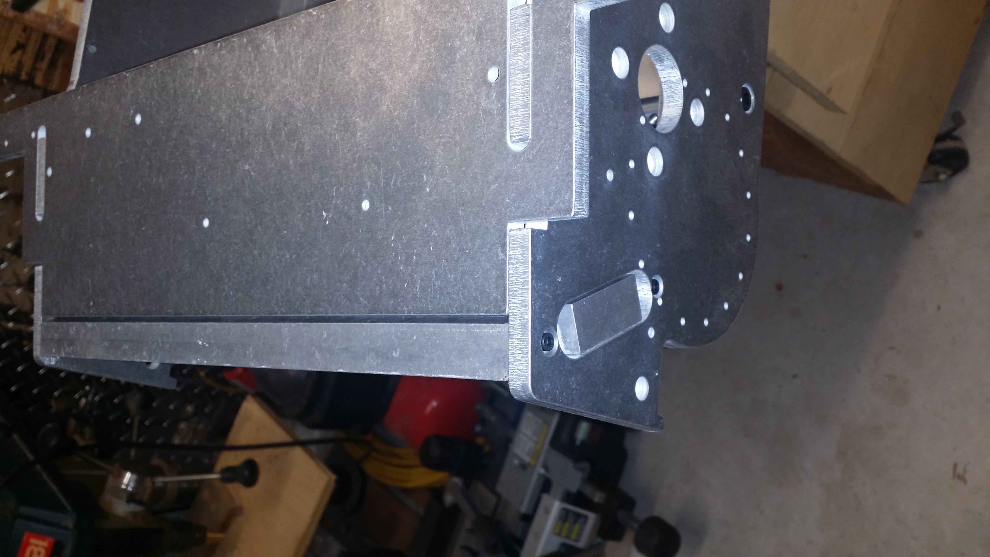

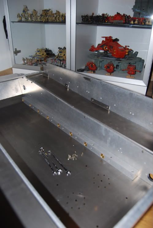

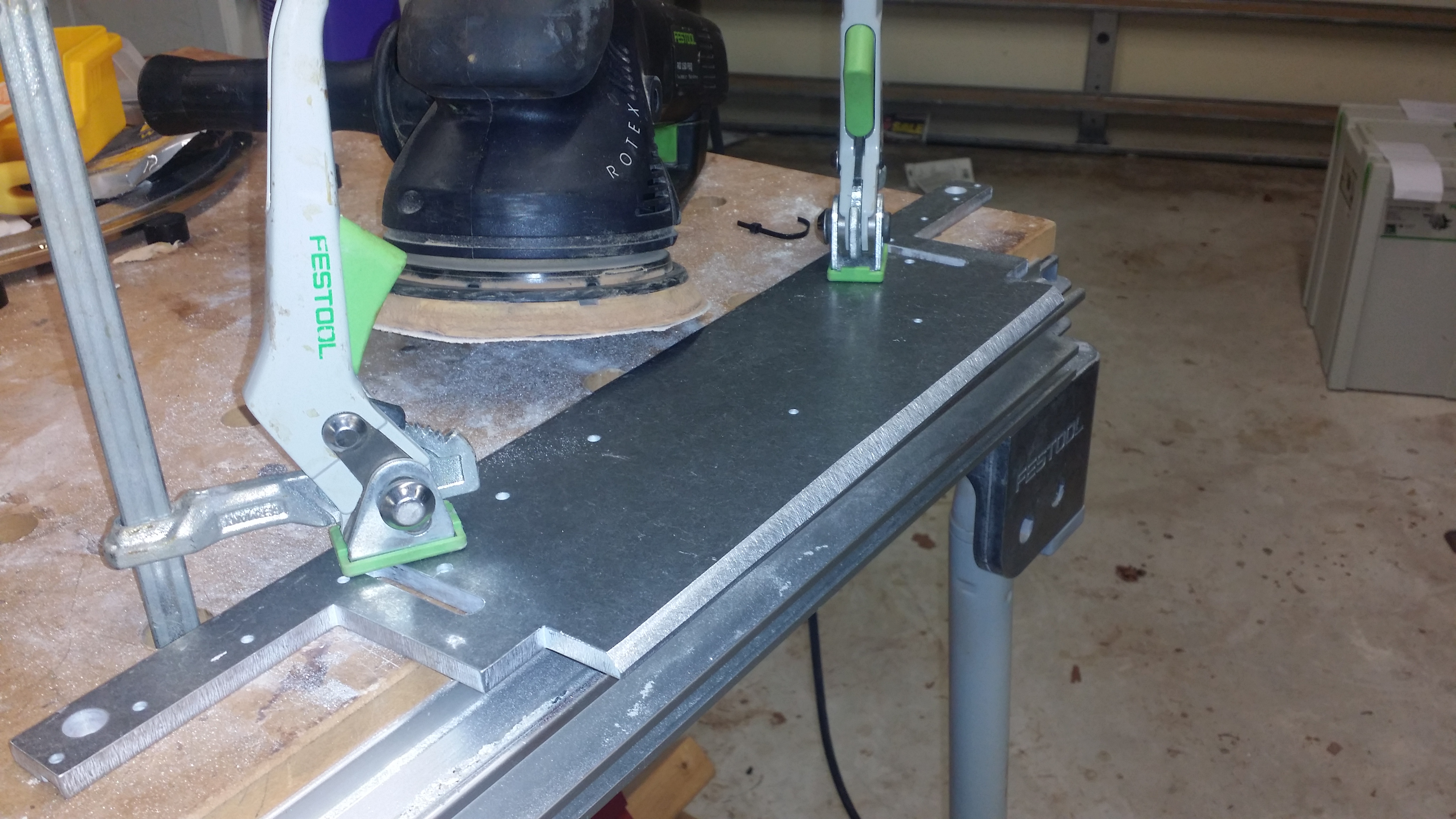

I ground it to a 45 and it fit perfectly. I will send some pics when they load. I am having a devil of a time figuring out the panier floor.I cant seem to find the nuts that go with the m3-10s. Do you have any more assembly pics from that stage? I am scouring the internet now.

Re: Mid Production Tiger Kit
Are they not just regular m3 nuts. I think the fasteners were dome head. I prefer to have the option to take the hull apart again for refurbishment if necessary.
