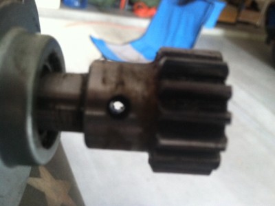

- Posts: 20
- Joined: Sat Dec 15, 2012 5:25 am
Re: RE: poor firefly
I believe I may have found the issue, I will need others advice to see if it is in fact the problem. I pulled the gear box off and the gear is intact no wear or tear. I turned on the tank and moved the throttle forward the gear turned. I held the gear and just the inner shaft turned. After removing the engine I found what appears to be a dow missing that would hold the gear and the shaft. Enclosed is the picture. Any advice is appreciated very very much. Thanks

- Posts: 20
Also does anyone know the size of the dow that I would use if it is indeed this.

- Posts: 2937
- Been liked: 3710 times
Hi Alfred
If you e-mail us directly with your address, we will send you a couple of the dowels that should be fitted. Once fitted repeat your test of holding the gear to make sure there are no issues inside the worm and wheel gearbox fitted to the Parvalux motors.
