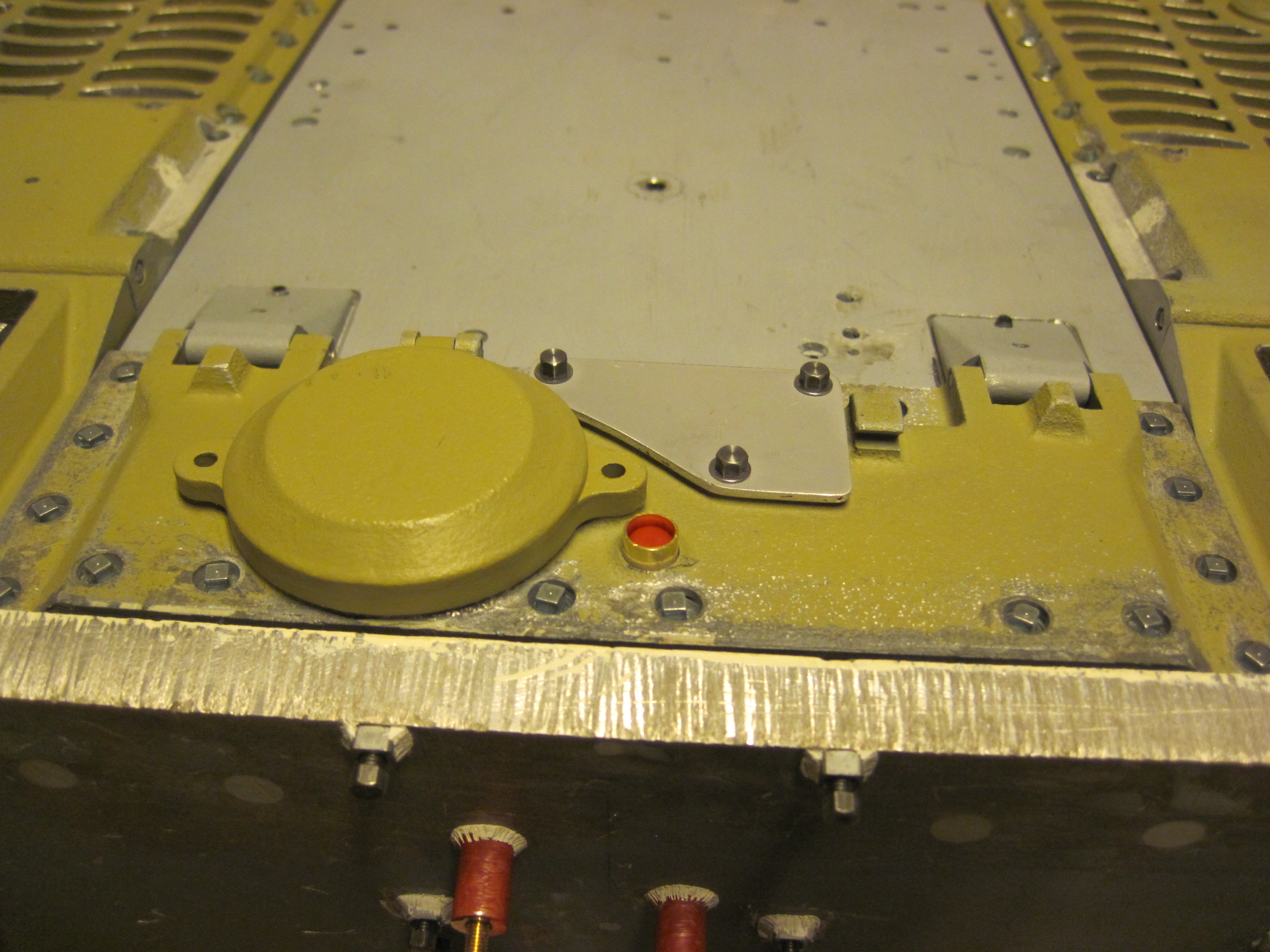

Hi all
Some more pic of my Tiger build, any comments welcome Regards Ragnar
THANKS FOR THE TIGER`S
2010 mid-Tiger Nr.005

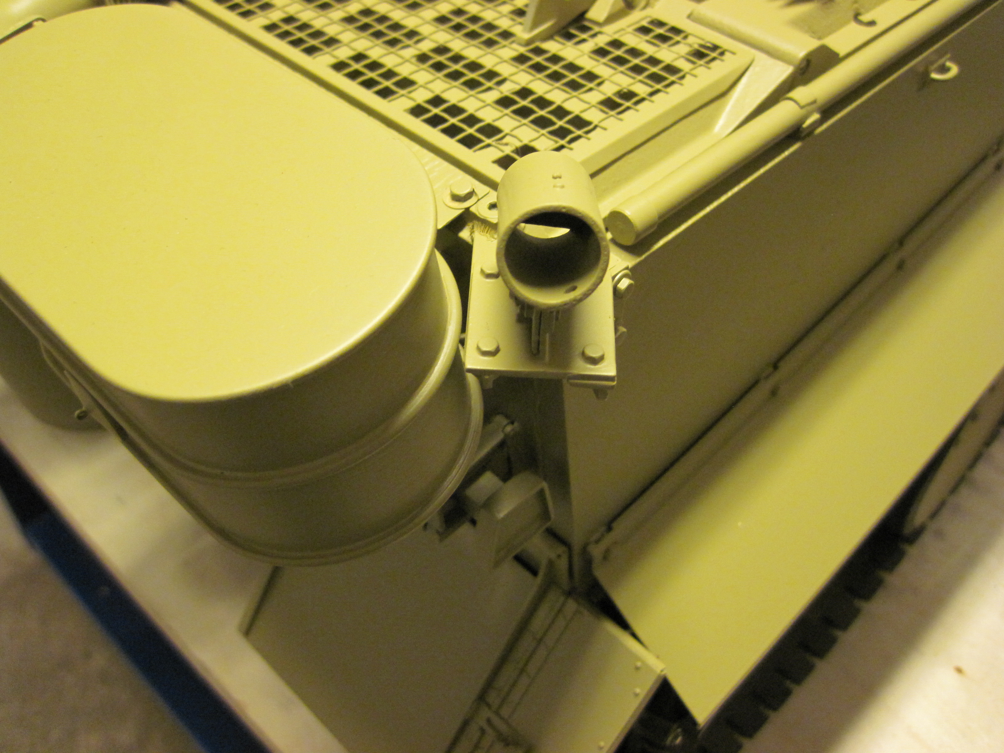

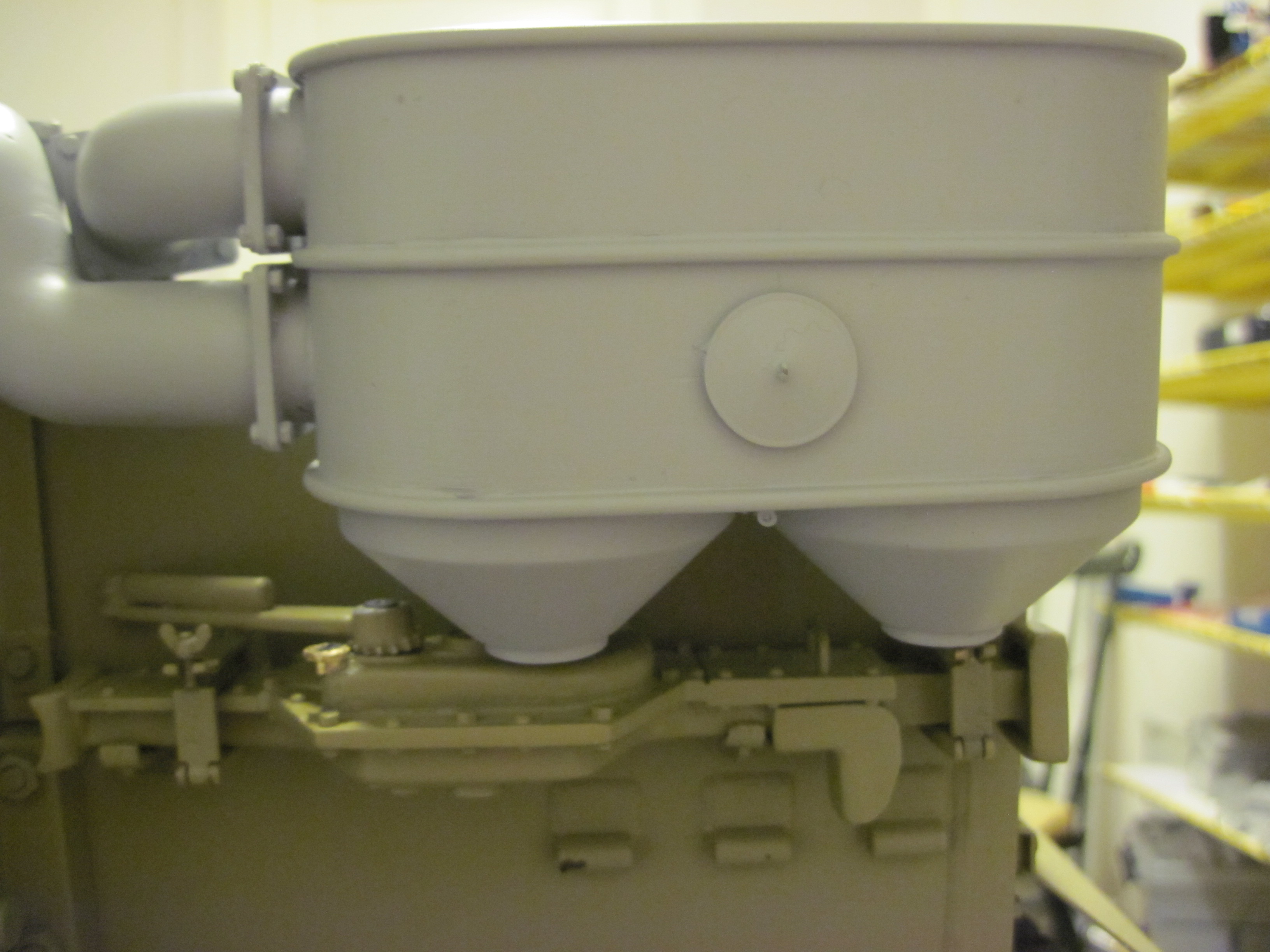

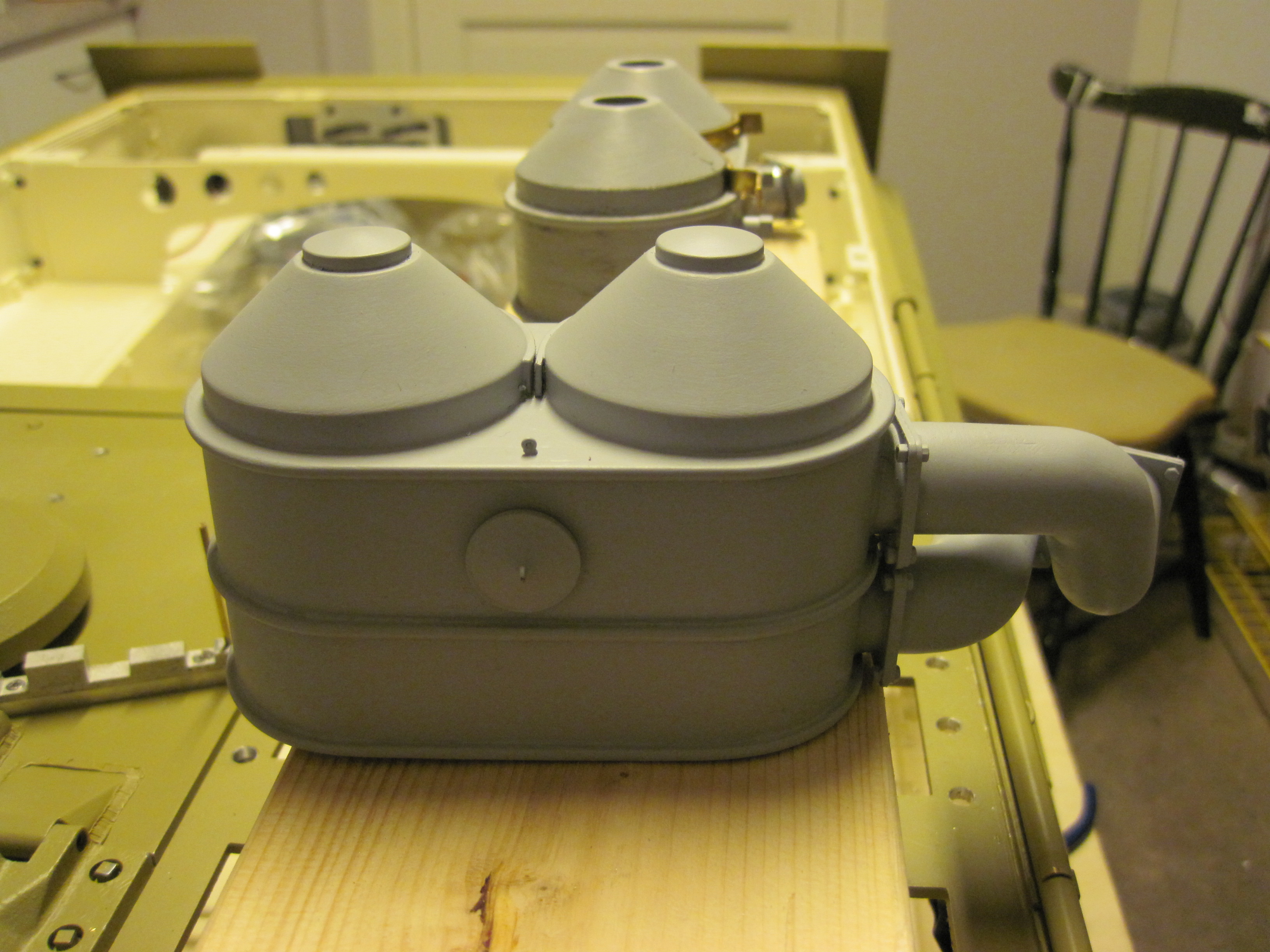

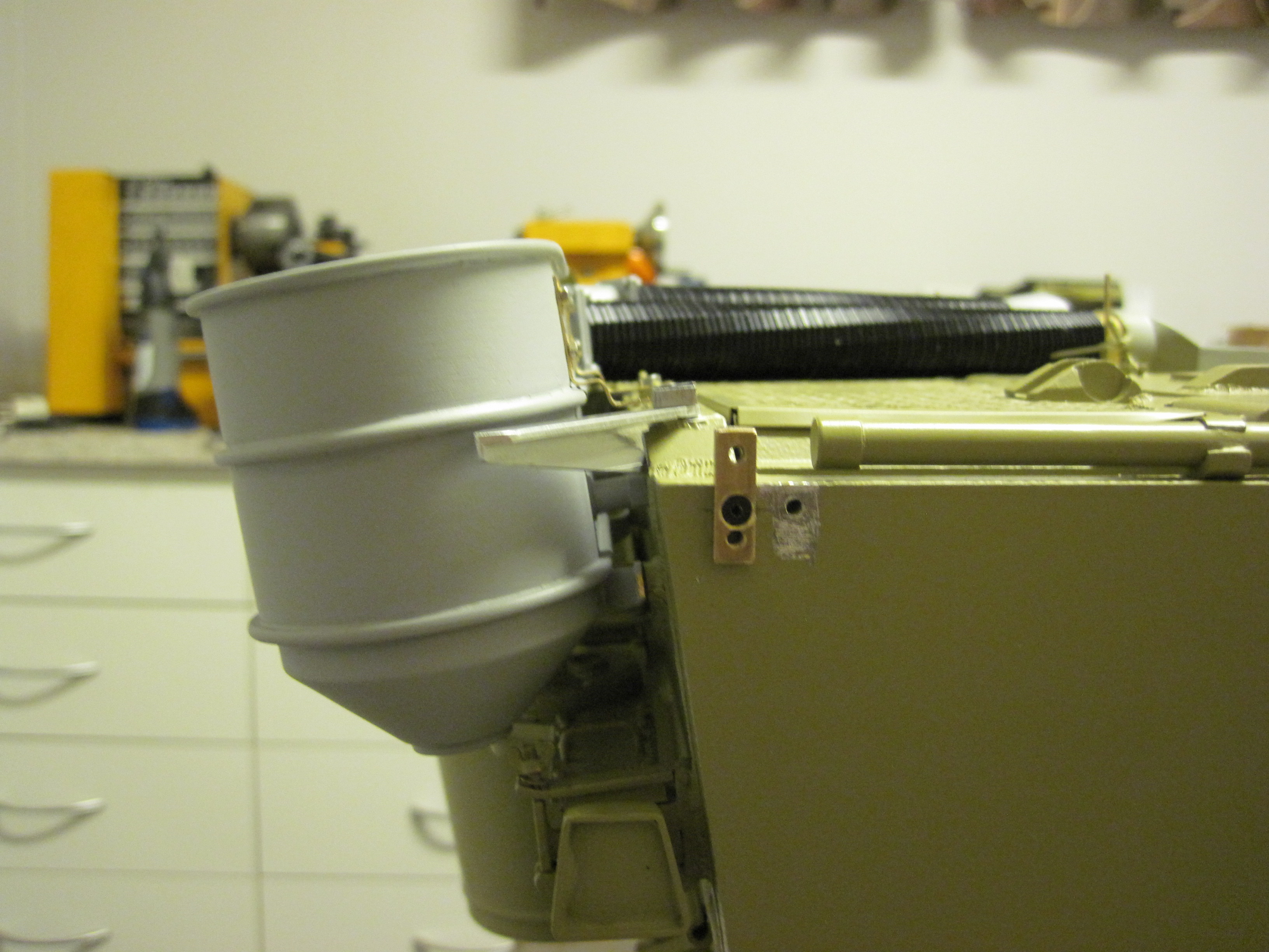

Hi All
Some pic. of my feifel system mod. It is Mike`s system that I have done some work on.
The rework has been done with styren strips and the filler I used are plastic padding PP100. If it gets right it is intended to be a single chamber system. Ragnar

Hi Ragnar
You have done some more nice work there,with the adaption
of your Feifel.
Nice pictures
Phil
of your Feifel.
Nice pictures

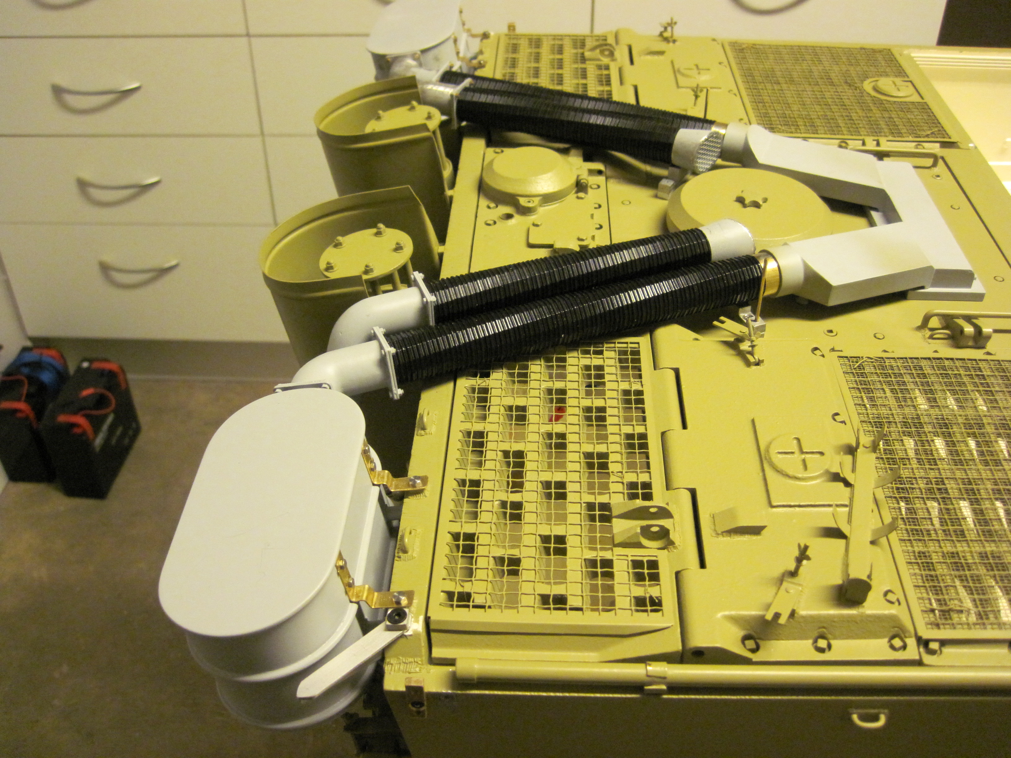

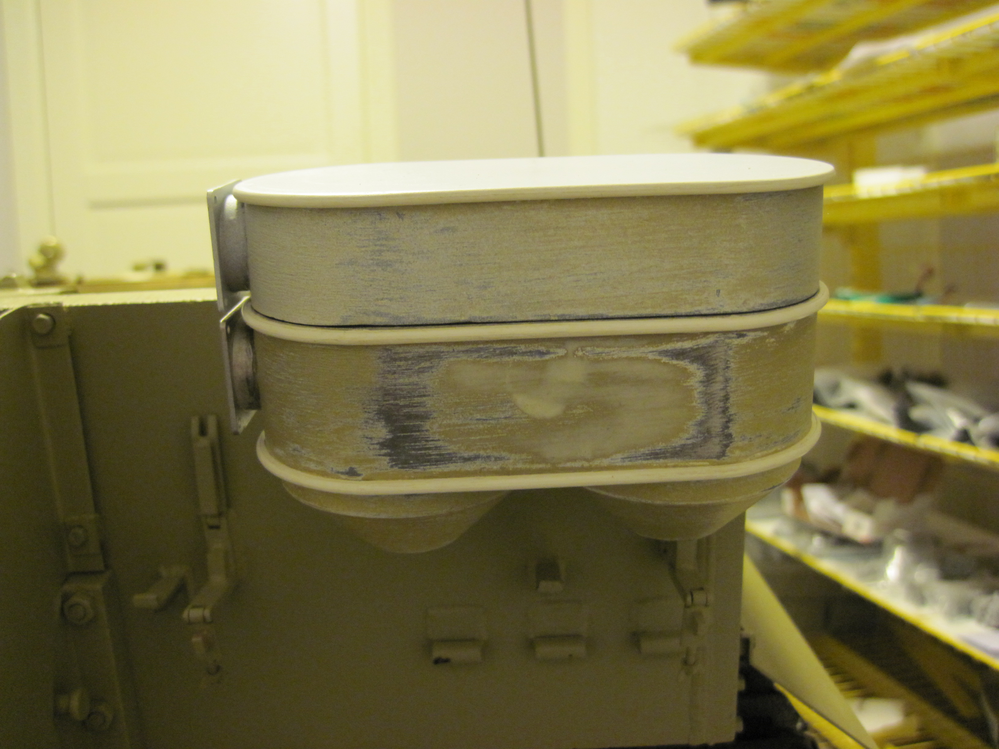

Re: Ragnar`s 2010 Tiger build

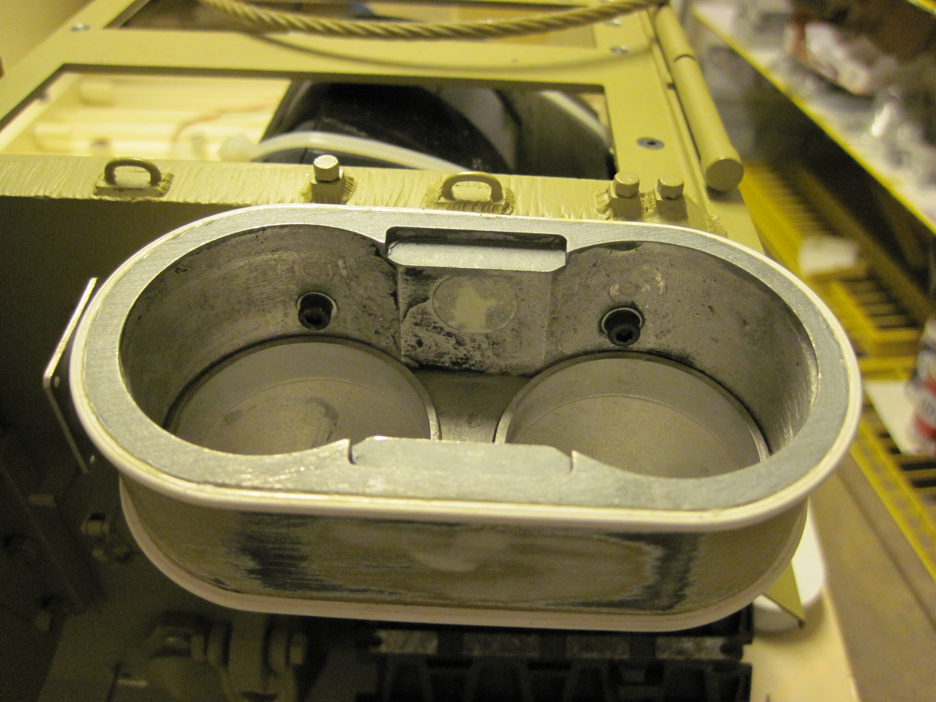

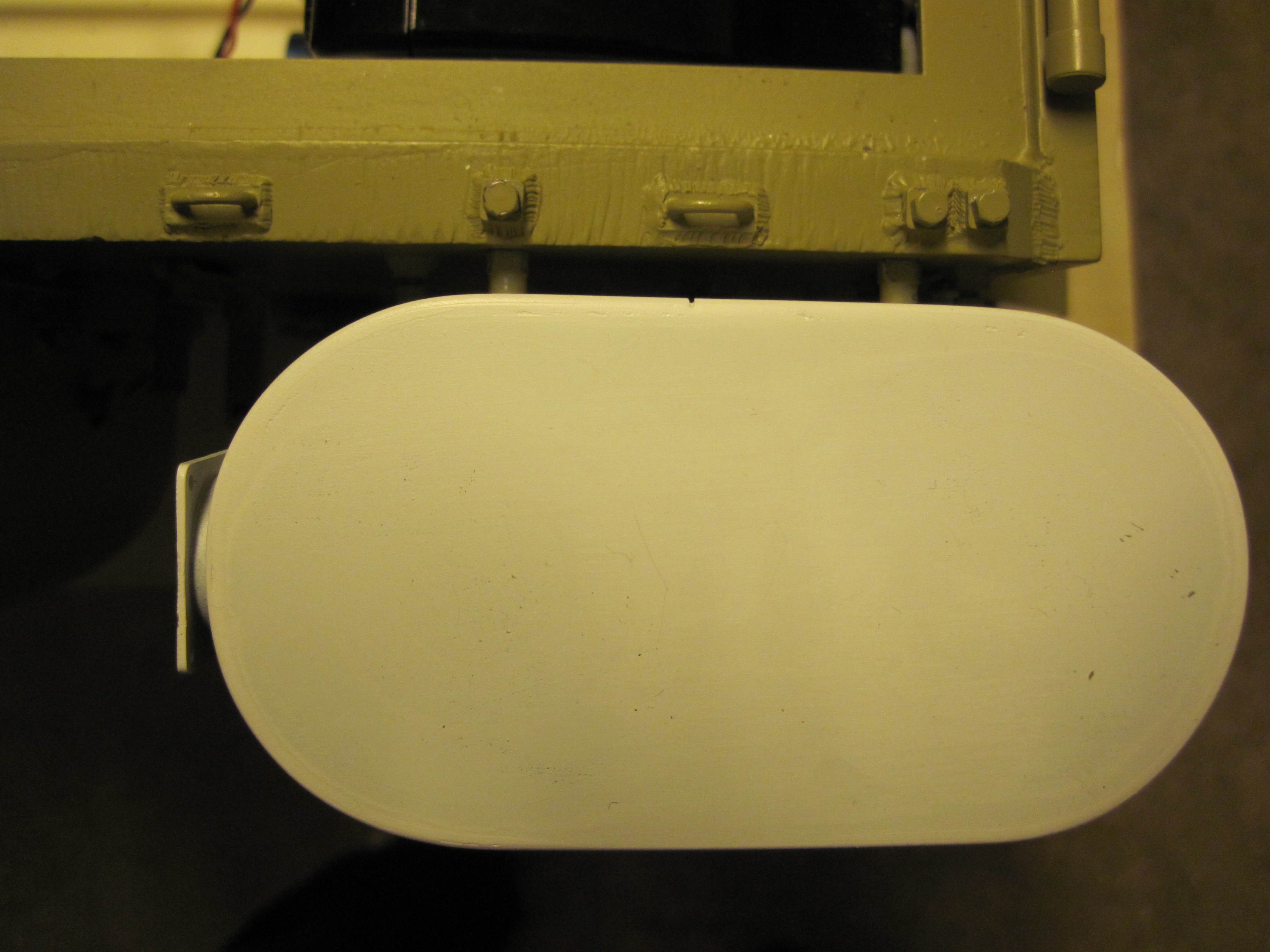

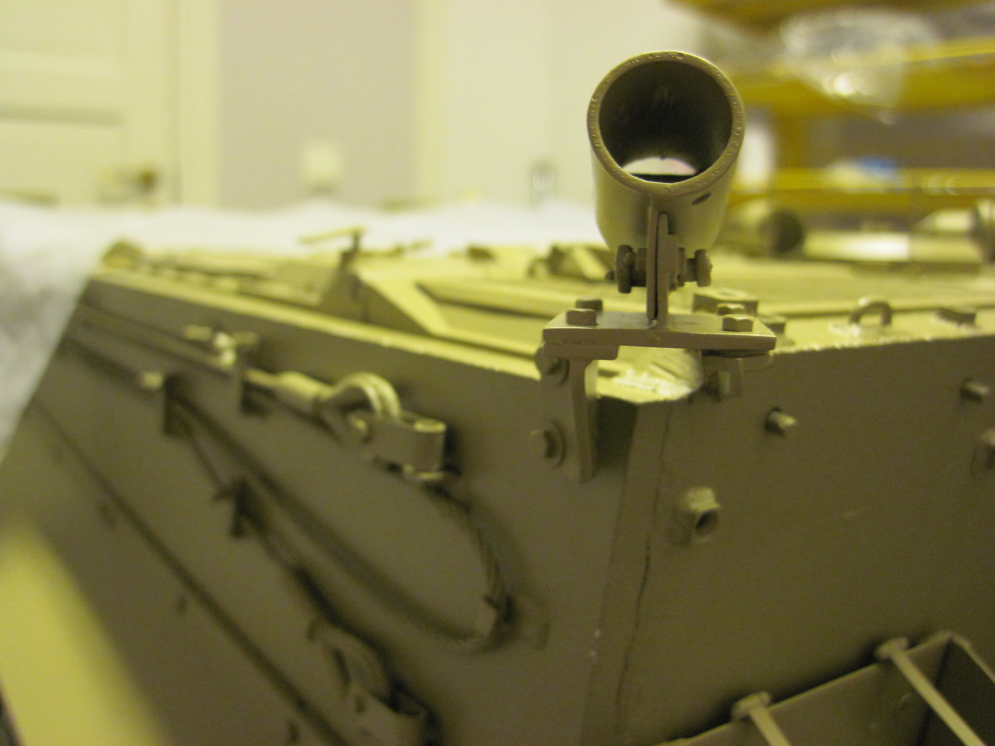

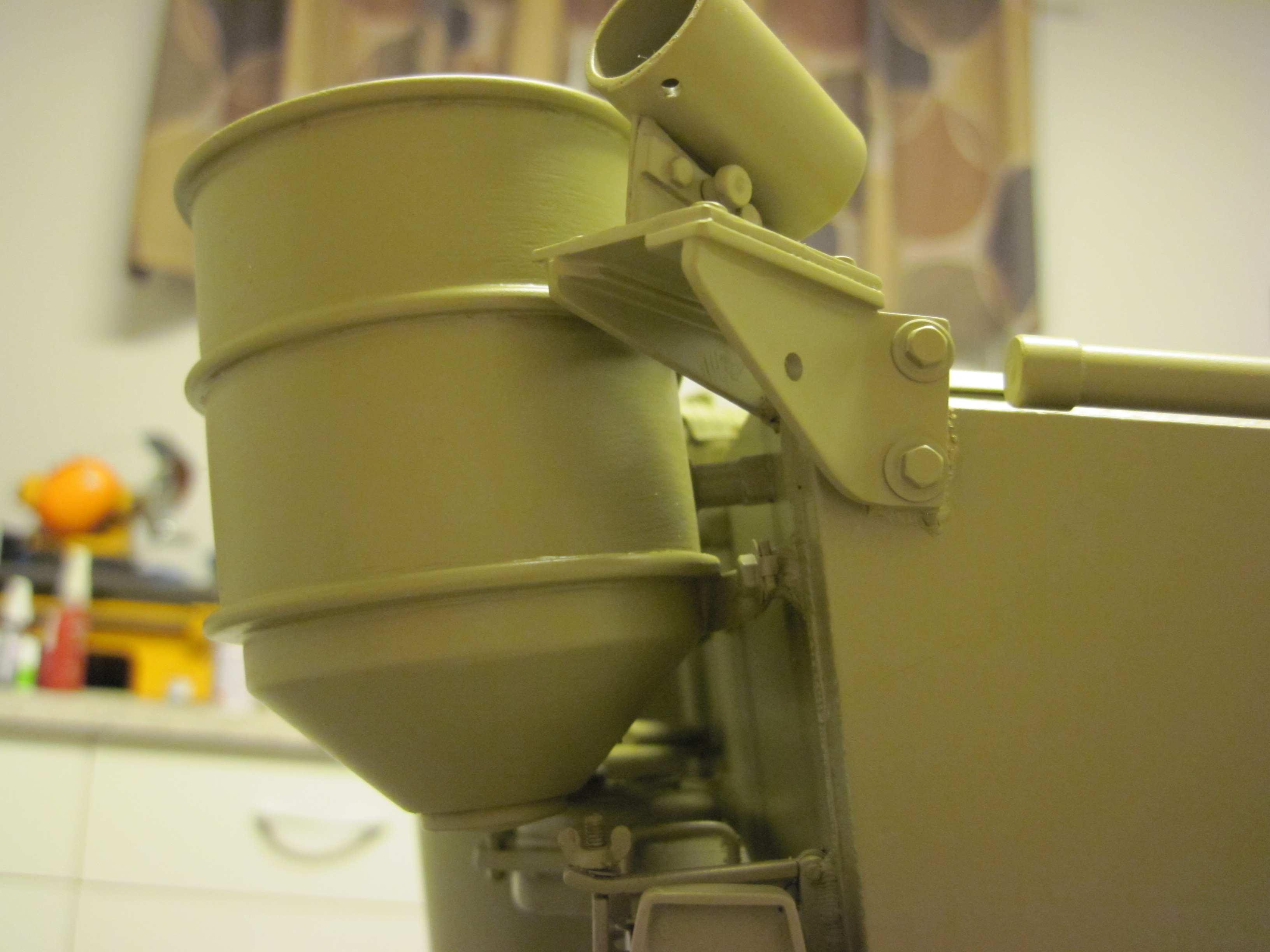

More Feifel pic.
Almost completed, some small parts need to be added and a final primer and paint. It is still Mike`s feifel parts,just modified. It was an close fit between the jack and the schrapnel bracket. The long air hoses,nedded the removal of two rings. The lower and upper brackets had to be made of brass sheet, due to the whitemetal would brake apart as I had to bend them.
Ragnar
Ragnar

Hi Ragnar
Beautiful work! That will be one very nice looking Tiger.
Kind regards

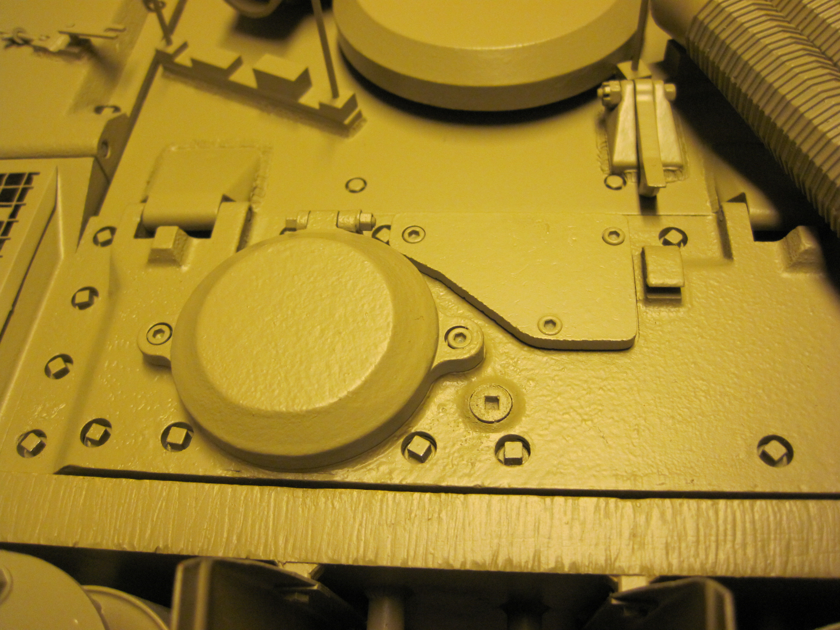

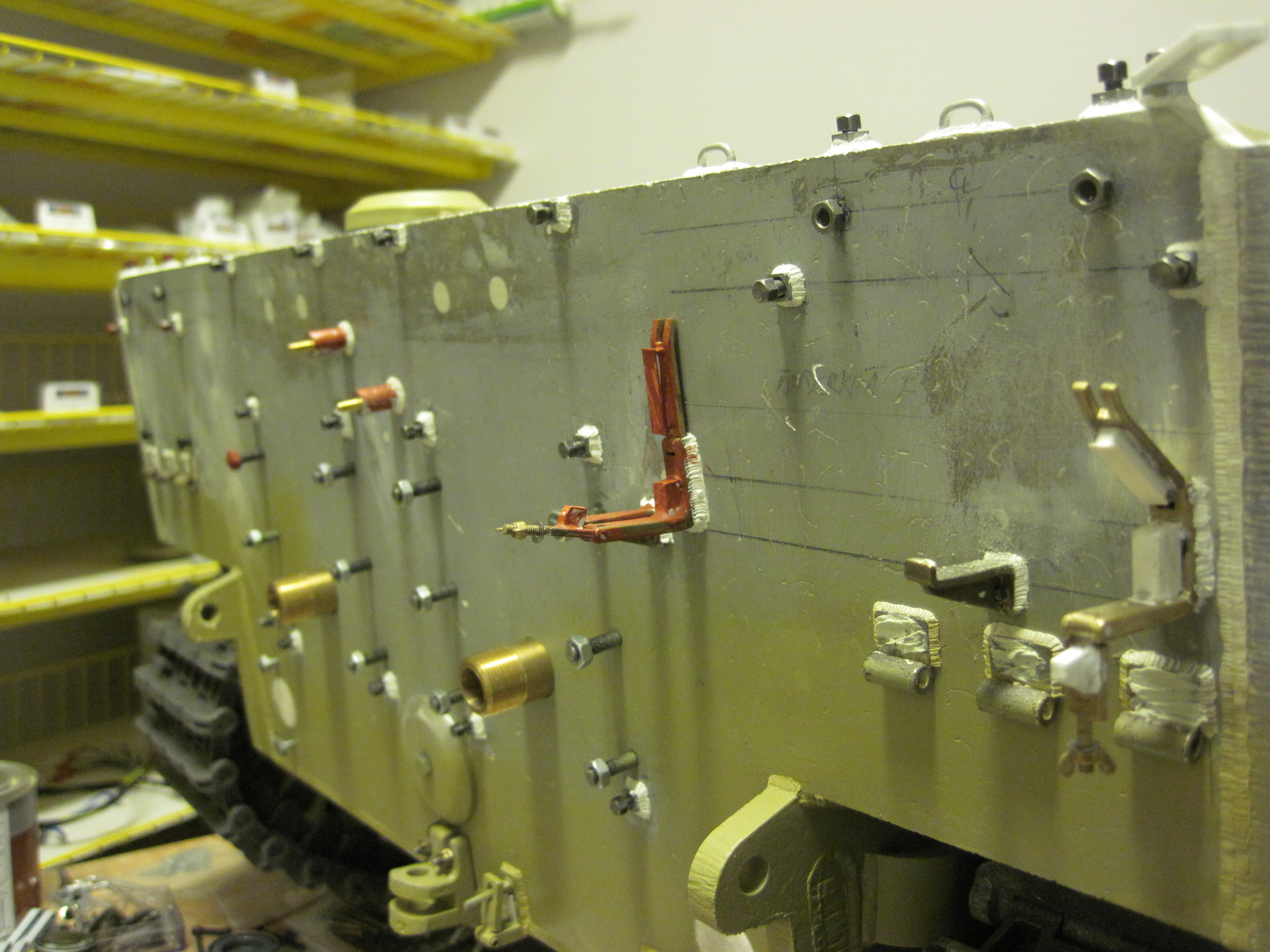

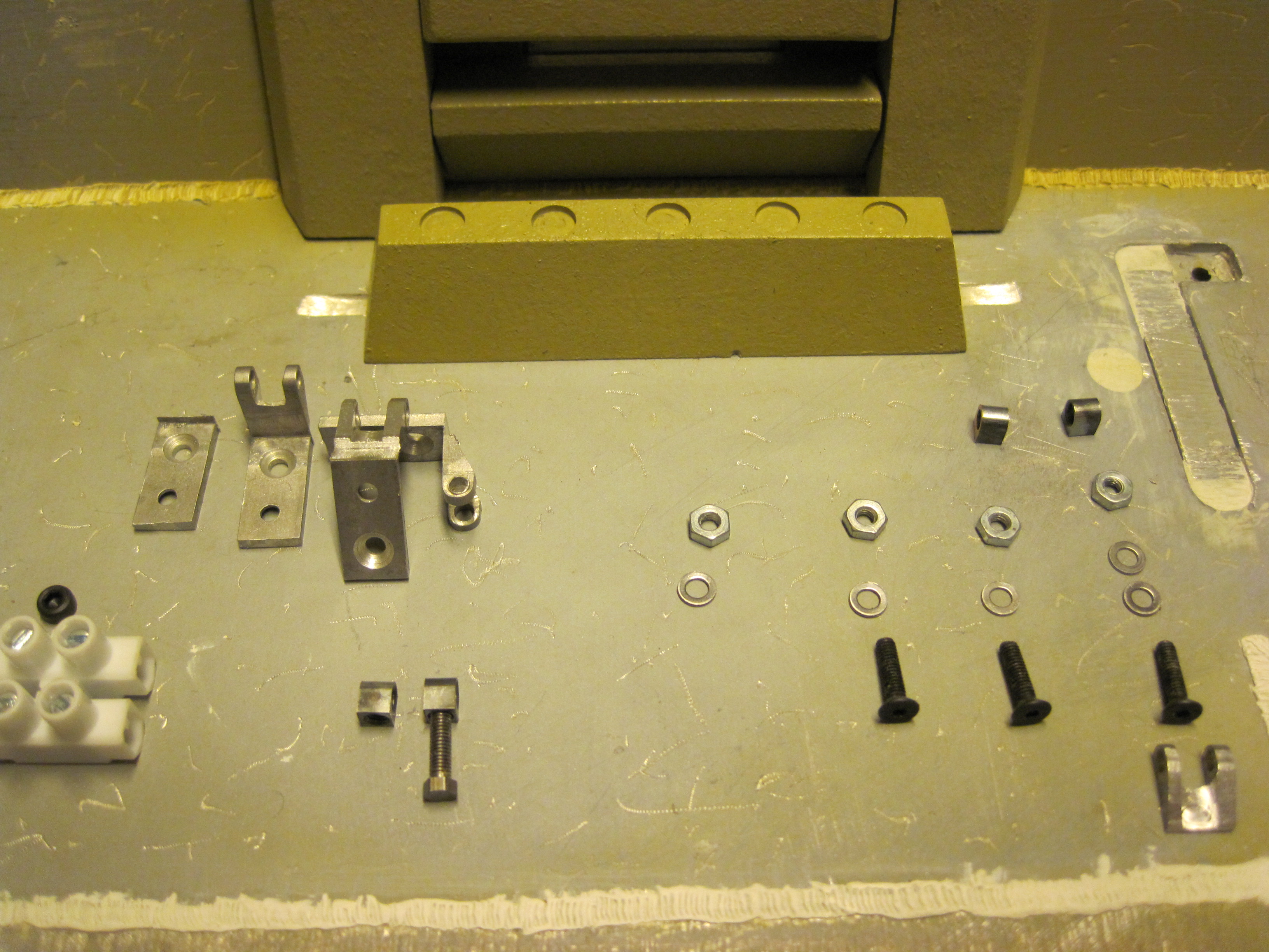

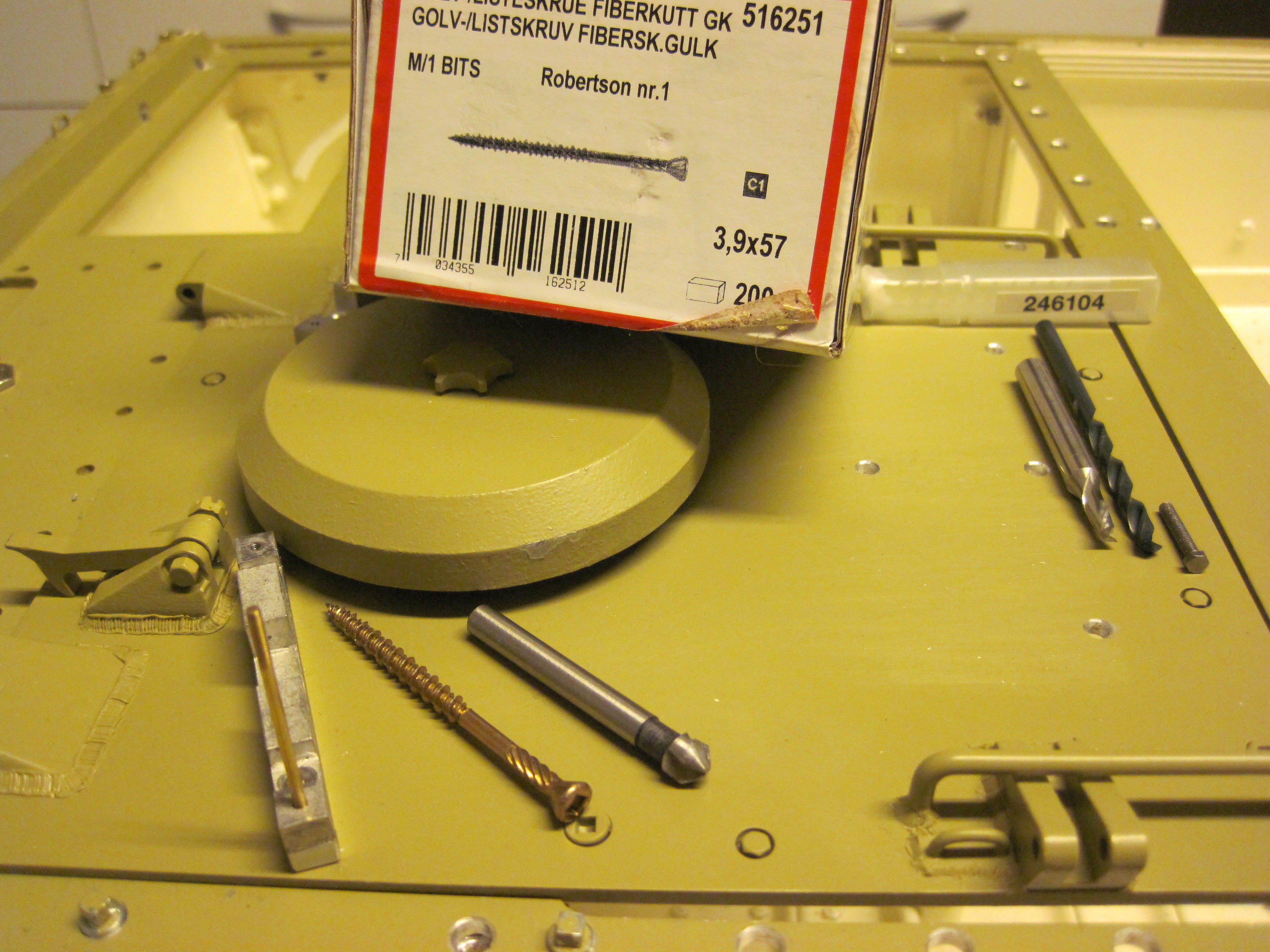

One little thing among others are the engine hatch closing/tightening locknuts. The eight or so little round things with a square recess in them around the perimeter of the hatch. How on earth did you make them? And the other ones with a recessed square protrusion? If you would like to share the technique, I would be so grateful.
Thanks,
/Chris
Thanks,
/Chris
- Posts: 70
- Joined: Fri Apr 10, 2009 11:22 am
- Location: NORWAY
- Been liked: 13 times
Hi Chris
It is very simple, take the screw and cut of head. The screw are used for fixing wooden trims around windows and floors. The problem is that some places have them with torx head, and others with Robertsen (known as R1-R3.
The hex head is 2,5m/m , started with 4m/m drillbit and flatend with the milling tool
I hope this is of any help, and i have taken a photo of a little set up
Ragnar
Ragnar
Brilliant idea with the wood screw!
Thanks for the instructive photo.
/Chris
/Chris

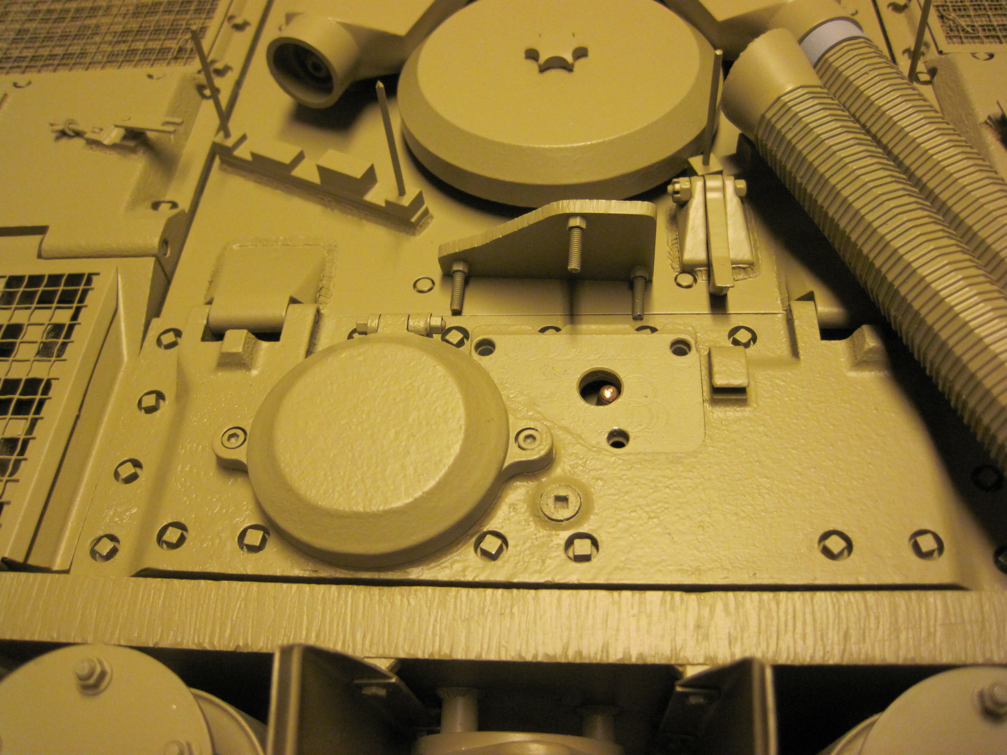

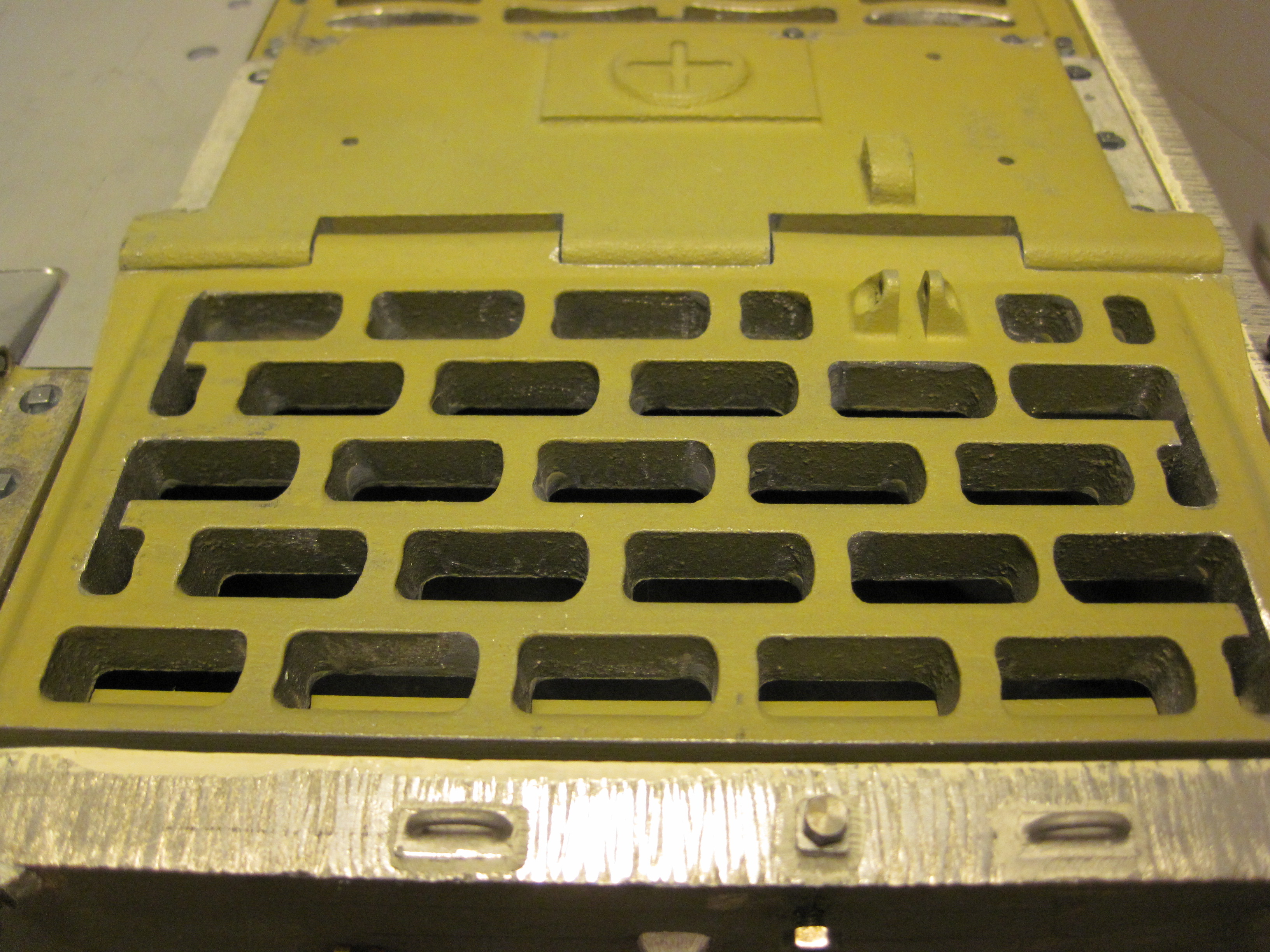

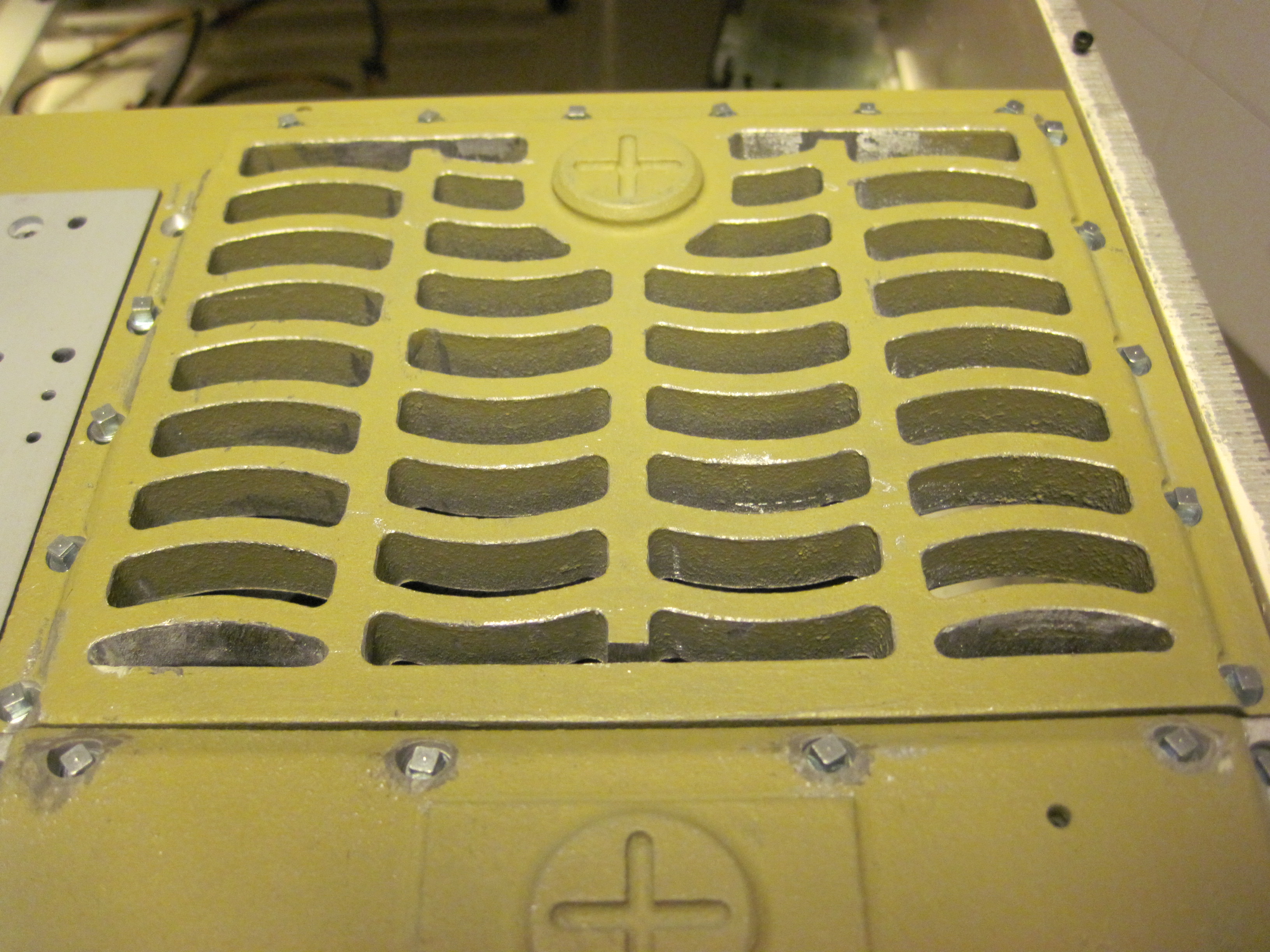

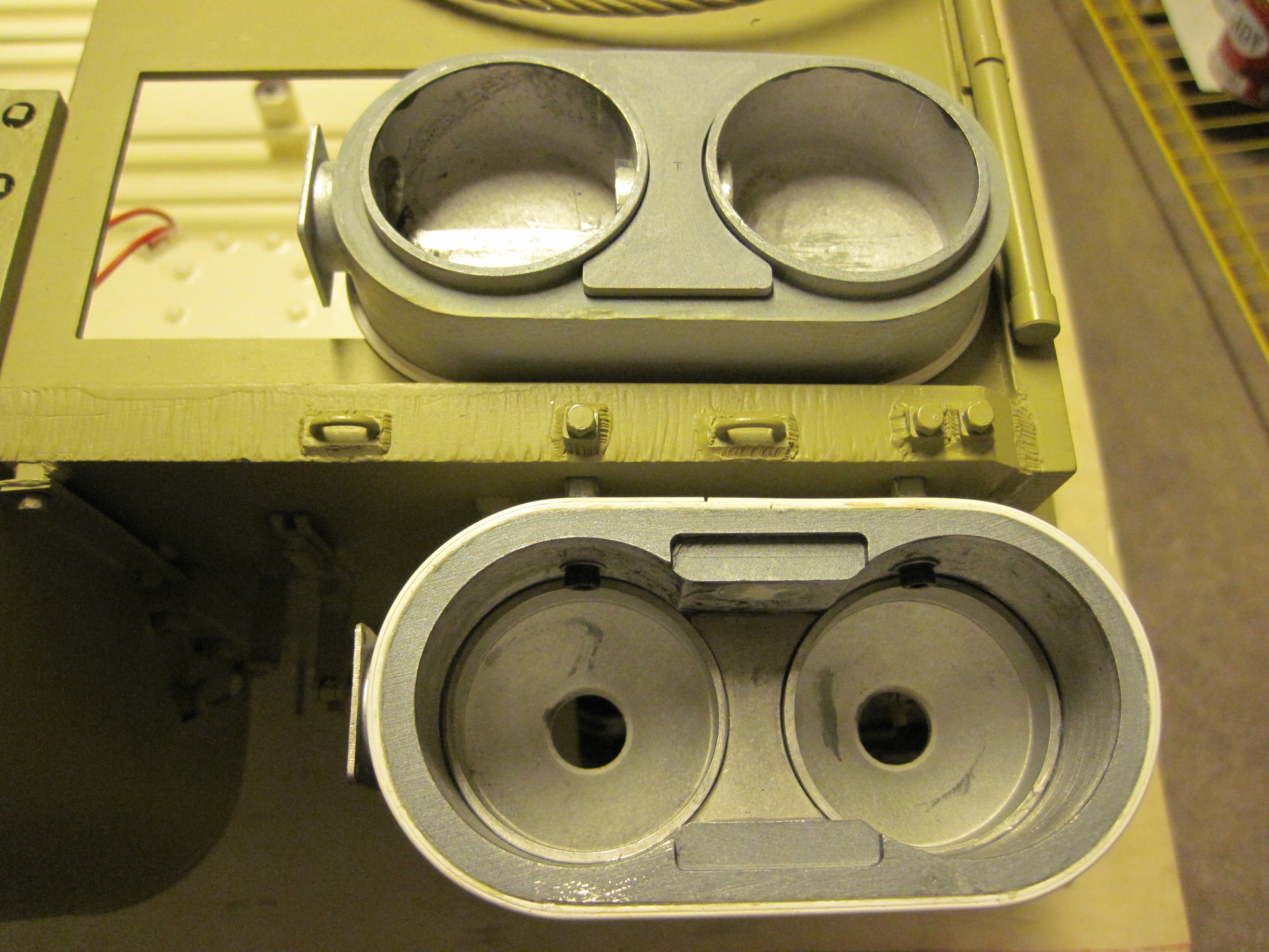

Hi All

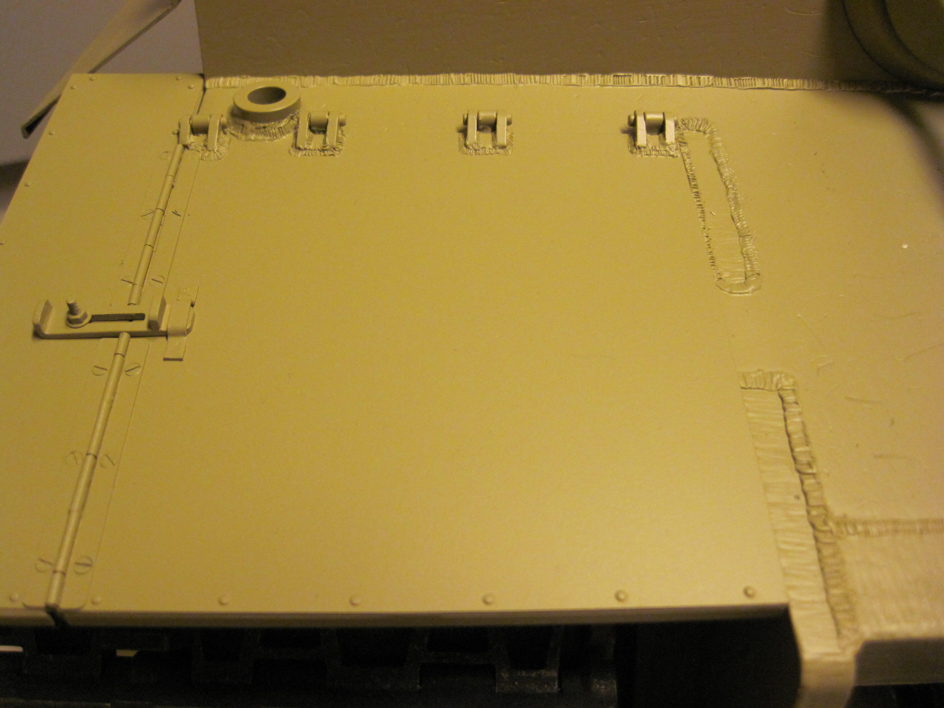

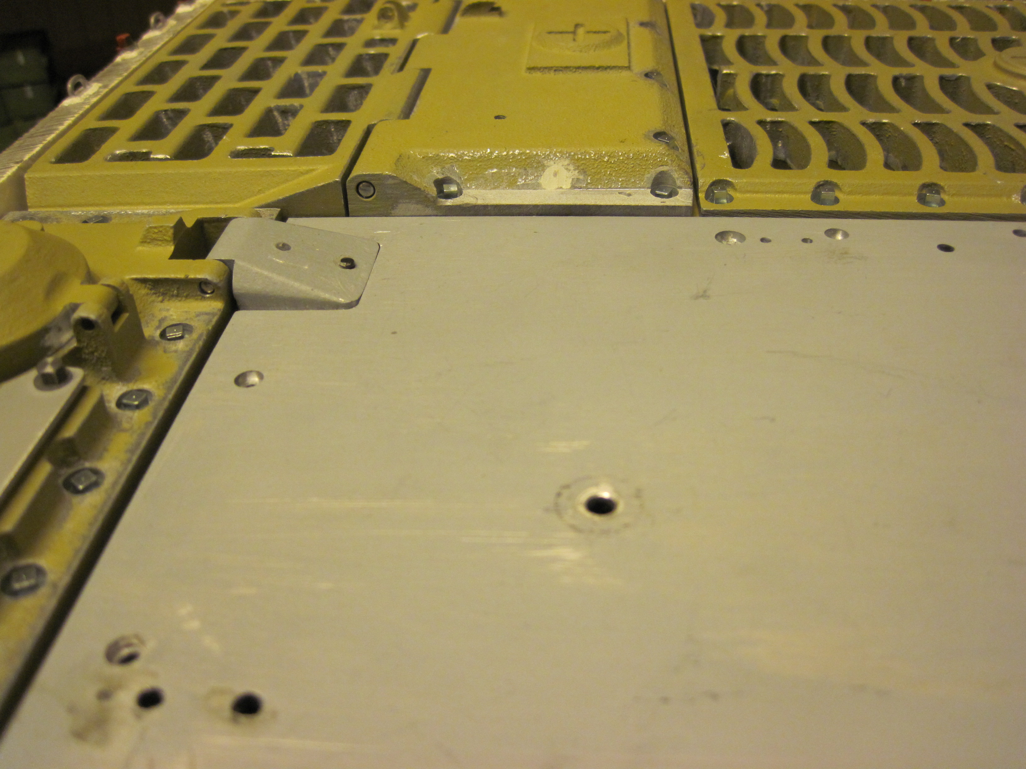

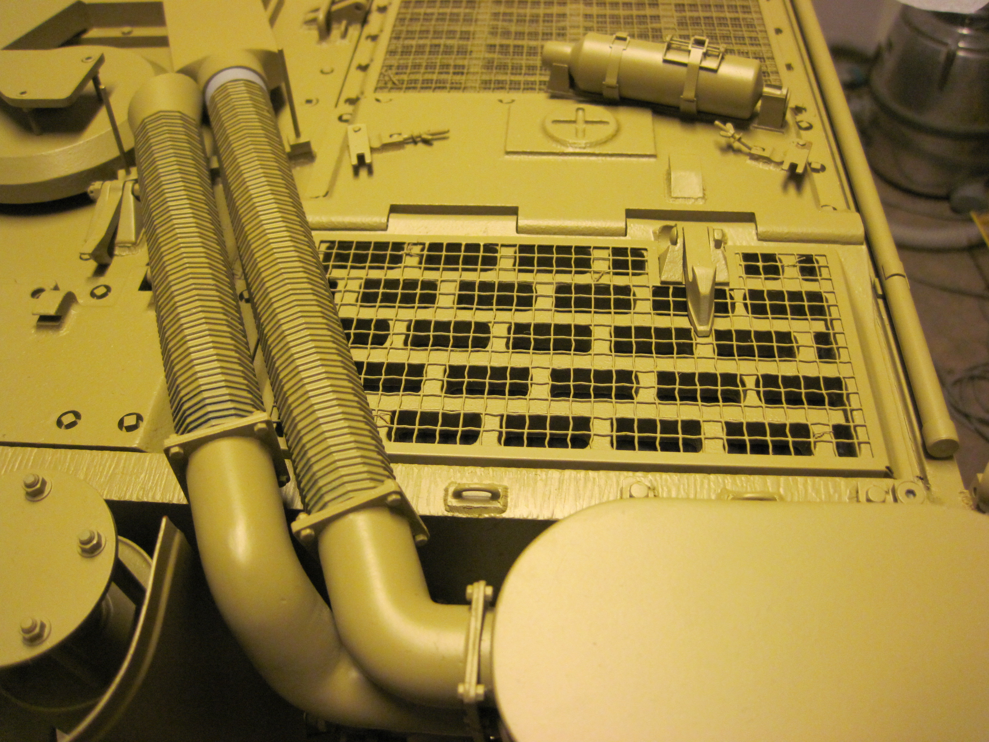

Some more pic. of my rear plate and rear deck An comments on this,good or bad
Ragnar
Ragnar

Got it Ragnar . Very nice workmanship you are doing a wonderful build so far well done.. Dale
