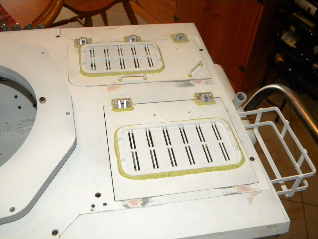

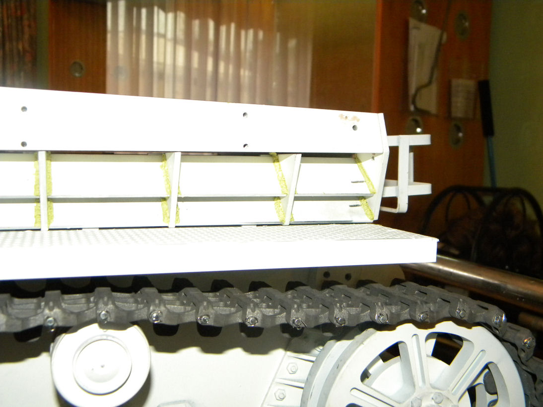

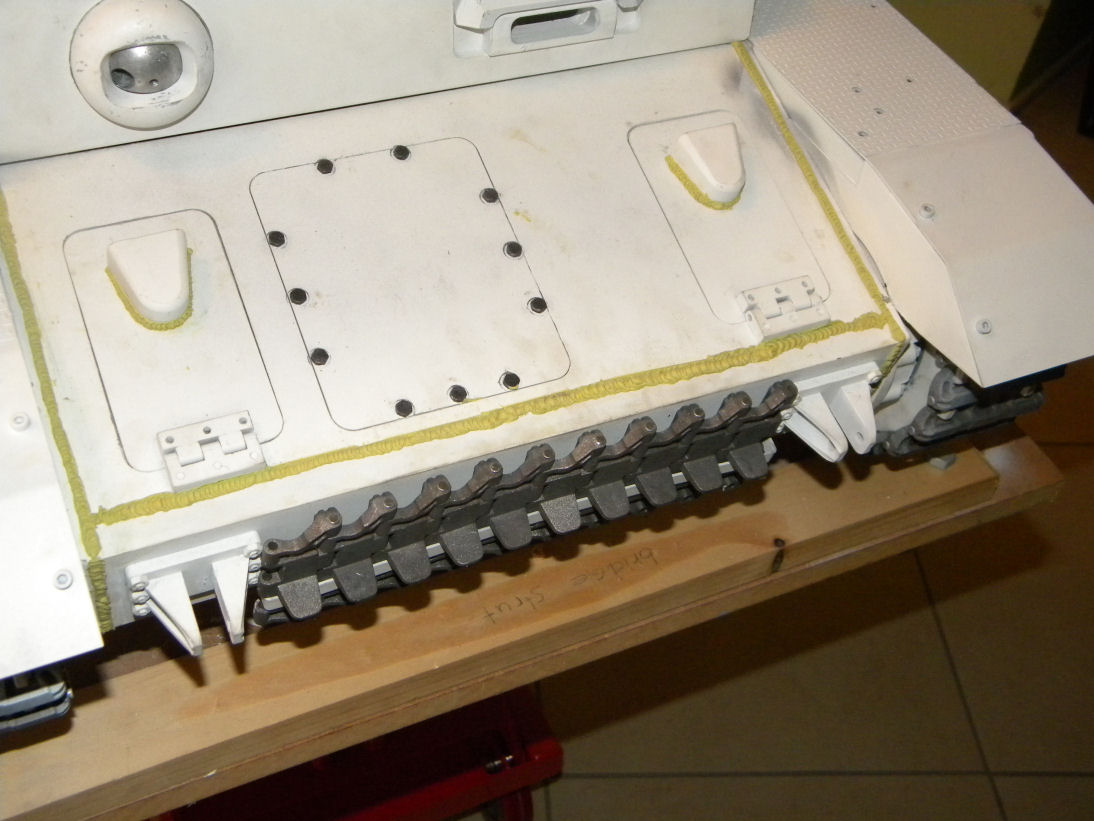

g'day all interested persons. posting my unpainted amature newbie fake welds attempt. comments good & bad (contructive replies) welcomed. i want to look semi authentic.

Those welds look great to me nothing wrong with them at all very good :D i didnt go with all the welds on mine ,too impatiant i think your build is coming on realy well nice to see it ,all the best ,,,,,,,,,,,,,,,,,,,,,,nick

I agree they look fine from your pictures and you will be pleased with them
when they are painted :)
Your Panzer 1V is looking good.
