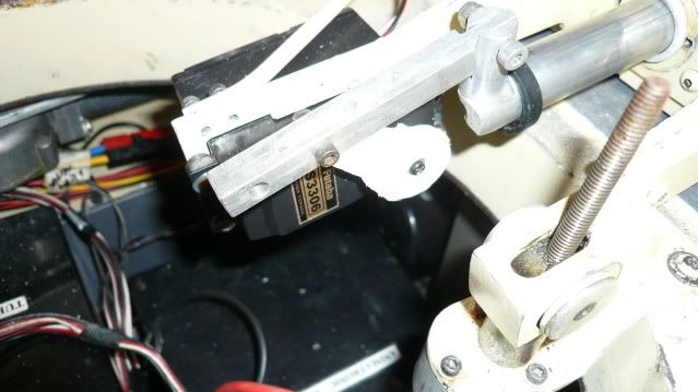

Re: Barrel Recoil
This is another view of my recoil system, Please note the 'white' PTFE bearing allowing a smooth and rigid guide for movement of the barrel. Also note the 'black' plastic bush which acts as a cushioning stop. I recommend the large FUTABA 3306 SERVO , as this has 24kg of torque, essential in moving a large heavy object. You must also power this servo using a 6 VOLT NICAD, 4.8 volt is not powerful enough.

Re: Barrel Recoil
If you cannot get enough recoil movement with an existing Futaba servo arm, here is one that I have found which gives a much longer throw.

Re: Barrel Recoil
Hi Tim, no video at the moment, but will take one hopefully next week when I have fitted the new longer servo arm. By the way my son lives in Bel Air, is that far from you?

Re: Barrel Recoil
Hi Tim, here is the promised video. The basic system is pretty crude, but it has worked successfully now for six years. However I would like to make a longer servo output arm in order to make the leverage a little straighter. For the 'slow' barrel return, I am using the TURNIGY servo speed reducer as previously mentioned.
