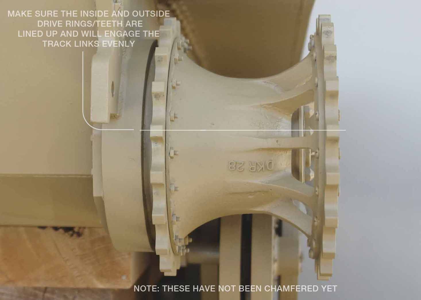

I know two fellow builders who have spent a great deal of time perfecting the performance of their Tiger I tracks and running gear. In the end, it all came down to two main problems, both regarding the teeth on the drive sprocket.
1. First ensure the inner and outer sprocket rings and teeth are lined up and all mounting holes are lined up. The holes can be drilled slightly if needed to allow for alignment. This can be checked and done by stacking the rings together while not mounted to the hub.
This photo is to show the alignment I am referring to.
If these are not aligned, the track will attempt to engage unevenly and cause one side or the other to ride up the teeth of one side.

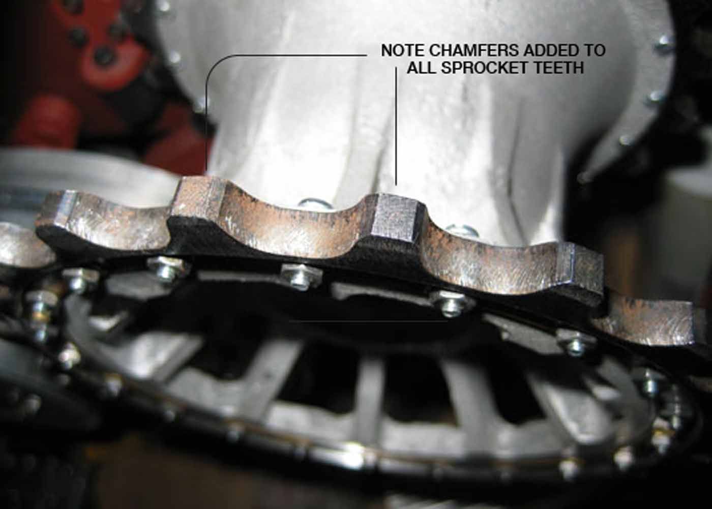

2. Chamfer all teeth on all four sides.
Photo courtesy of Tim McCarthy
The difference in smoothness of running after adding the chamfers is amazing. A few years ago, Sean Cleary went through this whole exercise and I can tell you, his Tiger can run at full speed, spin on a dime with both tracks moving in opposite directions and climb steep inclines at any angle without any problems and the most amazing and noticeable thing was how quiet his tracks were compared to my Panthers. My Panther was clacking away(assuming the sound was from the corners of the teeth). Sean's Tiger was just purring along like a finely tuned machine.

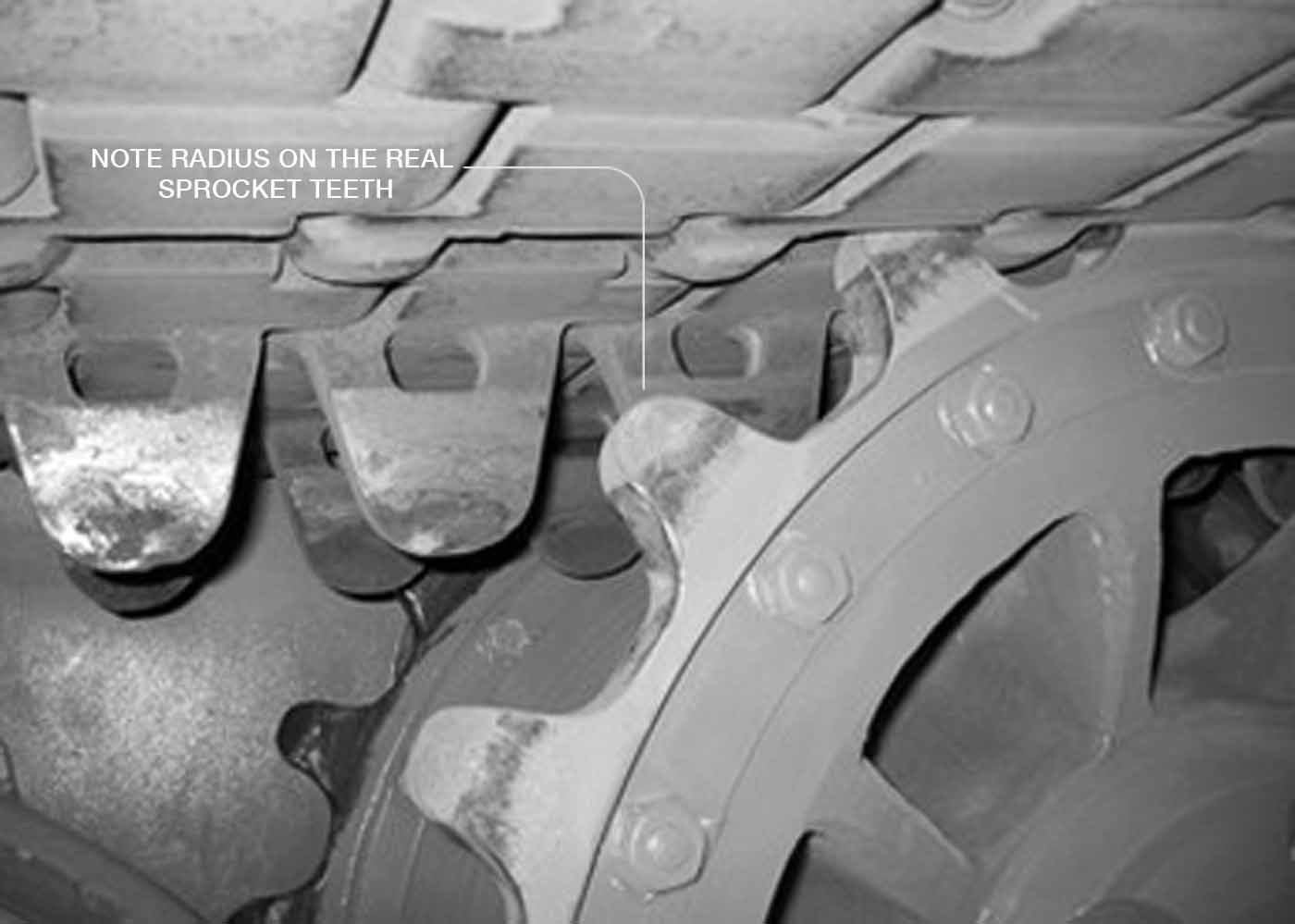

Notice how the real sprockets are radiused and chamfered. Some from wear but they are in the new parts as well. This allows them to easily find the guide-holes in the links.
