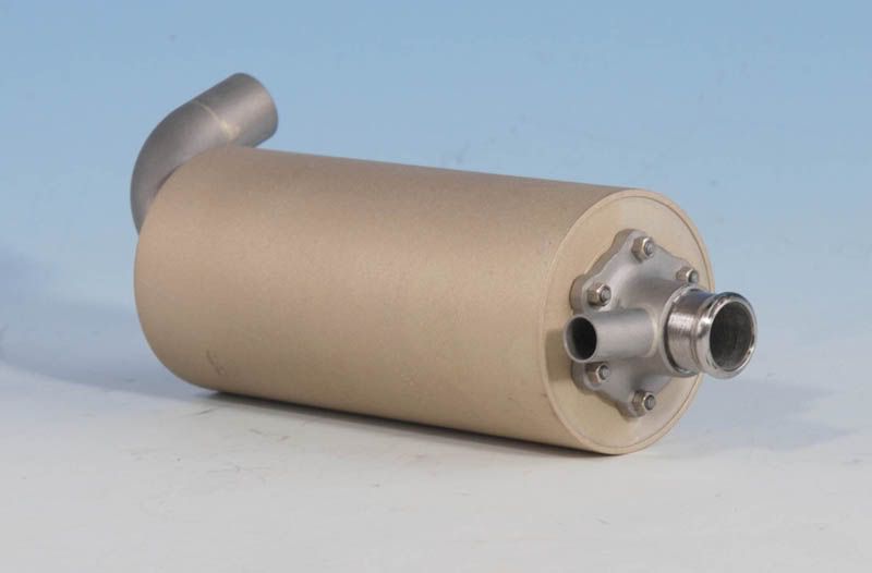

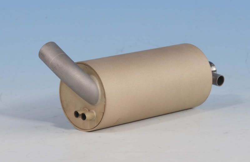

Hi, here is the next part I do need for getting the side wall of the block correct. The oil cooler is a water/oil heat exchanger. The water enters through a thermostat valve anaible a short circuit when engine is cold. Then the water passes through the big cylinder cooling the oil in the wirld pipe.
I guess there are a lot of members done steam engines before and must have some experience with cooling pipes, heat exchangers and so on. So please excuse my unproffessionel winding of the pipe. I desided not to make a new one just for the reason I had no more pipe available.
The brass cooler is 85 mm long and 29 mm in Ø. Water in- and outlet is 10 mm inner Ø. The oil pipe is 1,9 m long and the inner Ø is 3 mm. Hope everthing is tight and the different medias don't mix up.
Roland
