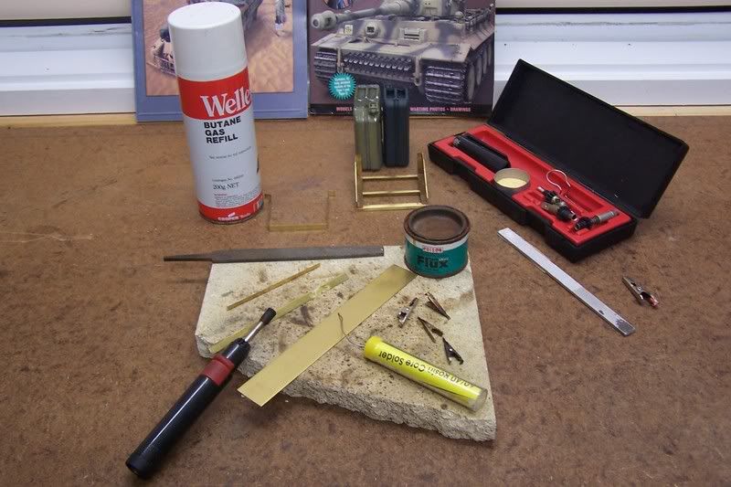

I will keep this simple . This is what I use . Blow torch pen type , Yorkshire flux, rosin core solder , small clamps , file , wet and dry sand paper , KS brass .

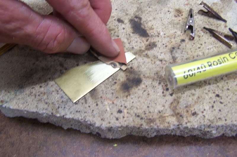

Cut all the parts and clean the parts with wet and dry sand paper make shore your hands are clean . No finger prints on the joints .

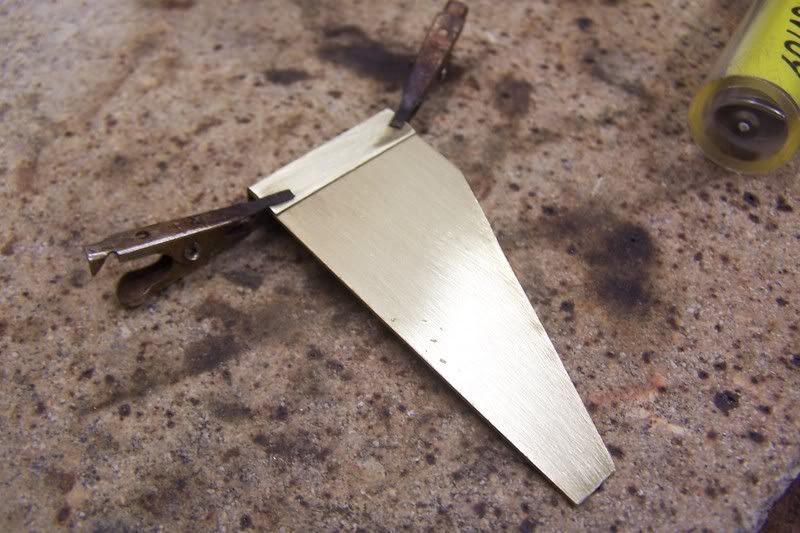

Test fit all the parts with clamps .

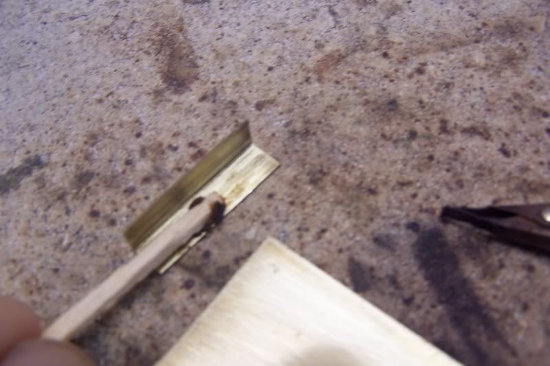

Pull apart and add flux to one part only . The build will be done in stages with cooling time between .
Dale jordan
Posts: 1460
Been liked: 525 times
Post by Dale jordan »

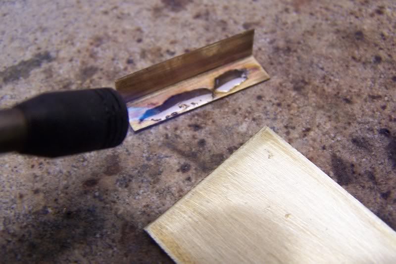

Heat up with torch and add some solder . let cool .
