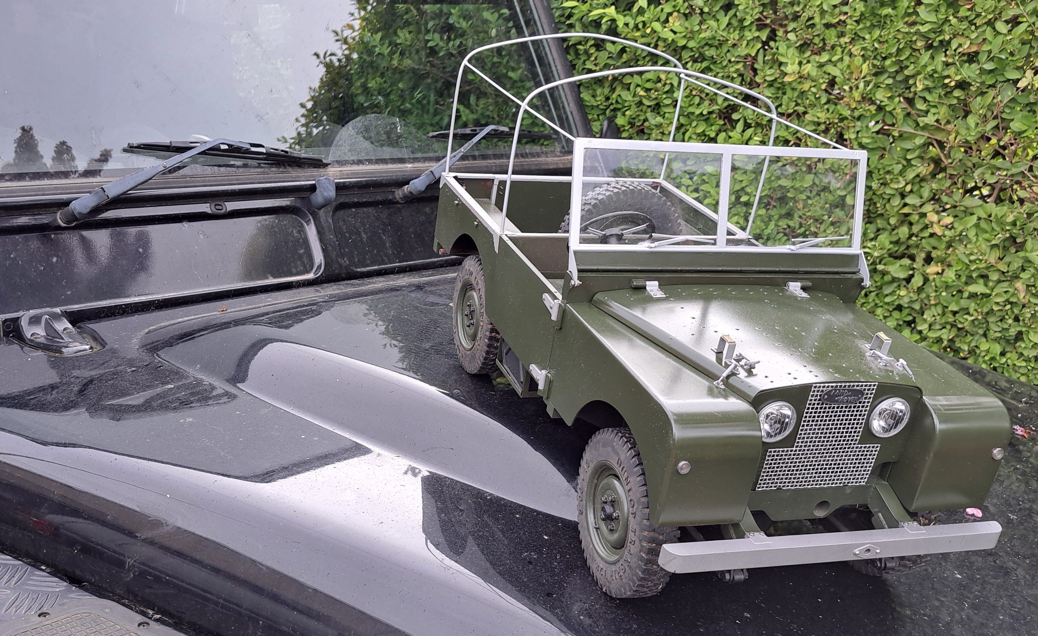

Pottering away as we do, time to have a look at the canopy frame. I am "doing" a later S1, thus I am allowed a rounded canopy top. La.d R.... changed the design to help prevent water and other detritus collecting on the roof canvas.
So, before the canvas we need a frame that doesn't wobble about:-
Made this jig to help hold the posts upright(ish).
Laying out the horizontal frame.
Horizontals soldered in position.
Jig removed a coat of paint, for now.
Take care and have a happy New Year.
Charles

Been awhile but there has been this niggling little job to do, securing the horizontal frame to the windscreen and making it detachable too. Oh, and fairly discrete too 8)
The answer my friends, eye bolts, small M2 ones:-
The hole is 2mm, turned down the collar & threaded
Screwed in
Screwed in
Cut of the excess, replace one of the clear panels(didn't fit, left a gap) and fit windscreen wiper stuff.
Leave the glue to set, mask and paint next.
Take care.
Charles

An update, what with it being bright,warm and sunny we have had to work, :shock: :cry: :cry:
Still I had a bit of time in the evenings to have a go at fitting the Armopax wiper blades:-
Note the jaunty angle of the blades; referenced from a contemporary  vehicle, whose name we don't mention.
Some interior work next and then wing mirrors 8)
