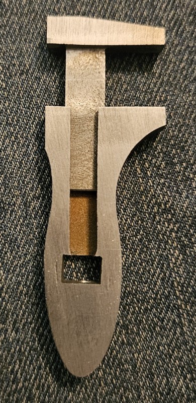

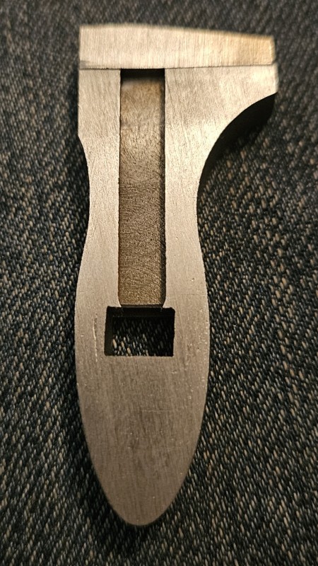

So the series 1 tool box beckons again and I finished the pliers off. The first set snapped at the handle as I took out too much meat. So I started again and made them stronger this time.
With those out of the way i looked at the movable jaw spanner included in the original tool kit.
A bit of profile filing and milling on the fixed jaw handle and shaping of the moving jaw.

Re: KIT No. 98 BUILD
Given the size of the original King Dick shifting spanner, I'm guessing it's 1" long? Nice job ! You'll need to dip it in some 'Black it' to get that nice acid black colouring
