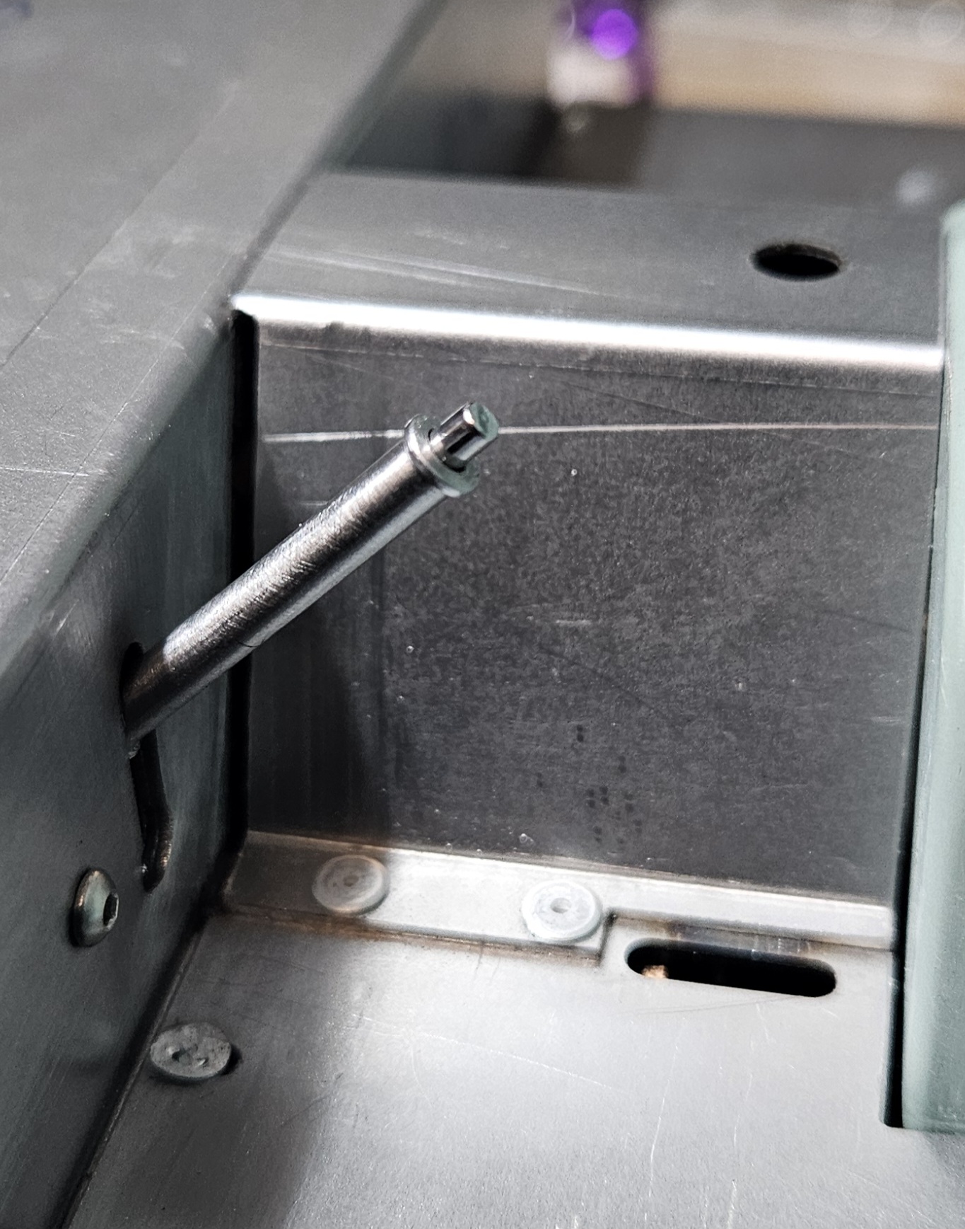

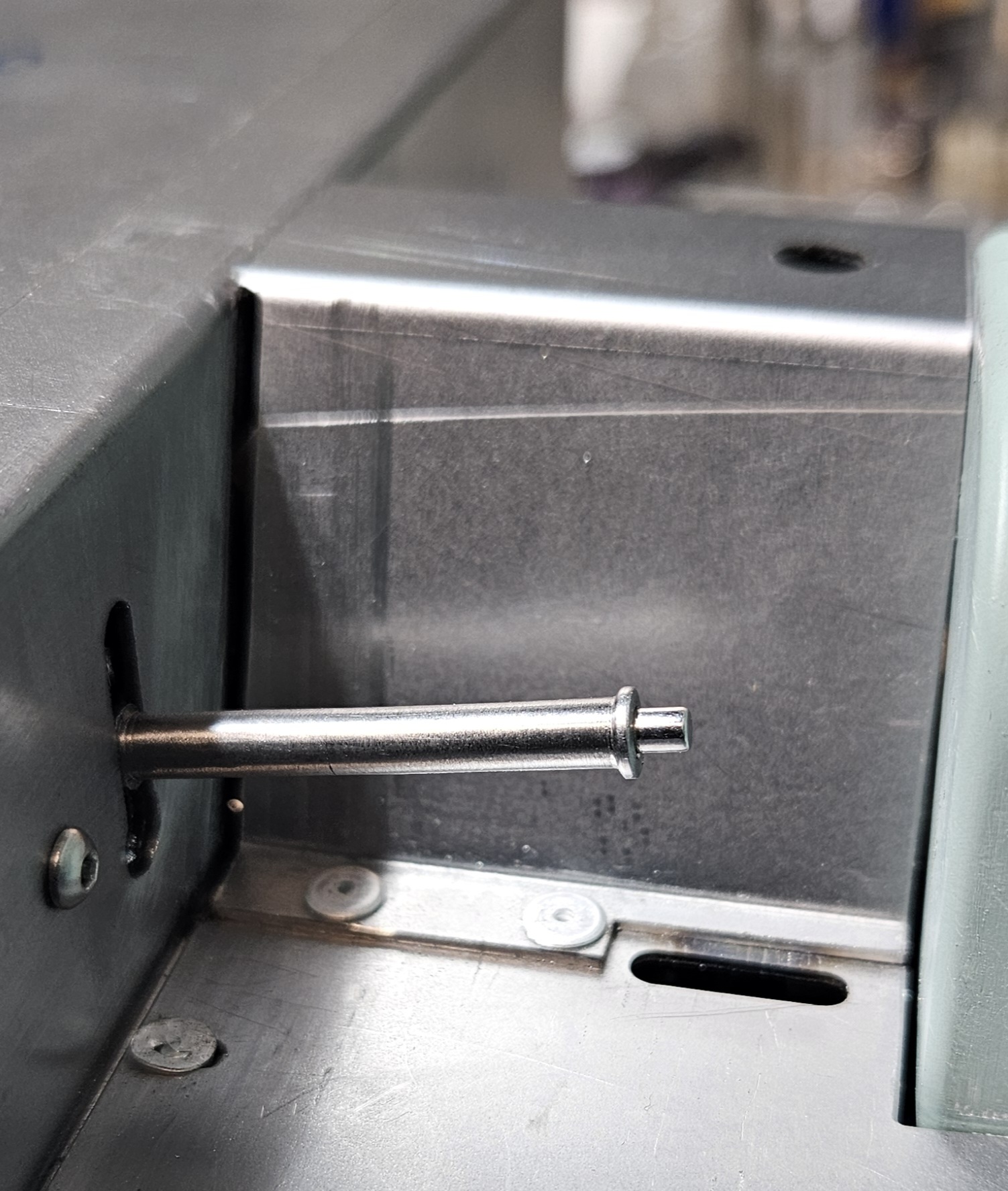

Another project within the wider build today.
While fitting the cab floor I thought a handbrake would look good. Nothing too flashy, just a turned rod fitted to the seat panel to the drivers left.
But I got absorbed in the idea and it kind of grew into a functional lever on a sprung pivot so that it can be set at an up or down position. Oh and I just had to make the release button something you could press.
It is a bit in the way of the drive battery but nothing that is causing a problem.

I was looking at that Charles but I concentrated on the spring detent. I guess it could make it again, but I tend to make things up as I go along and try to do things in one take lol.

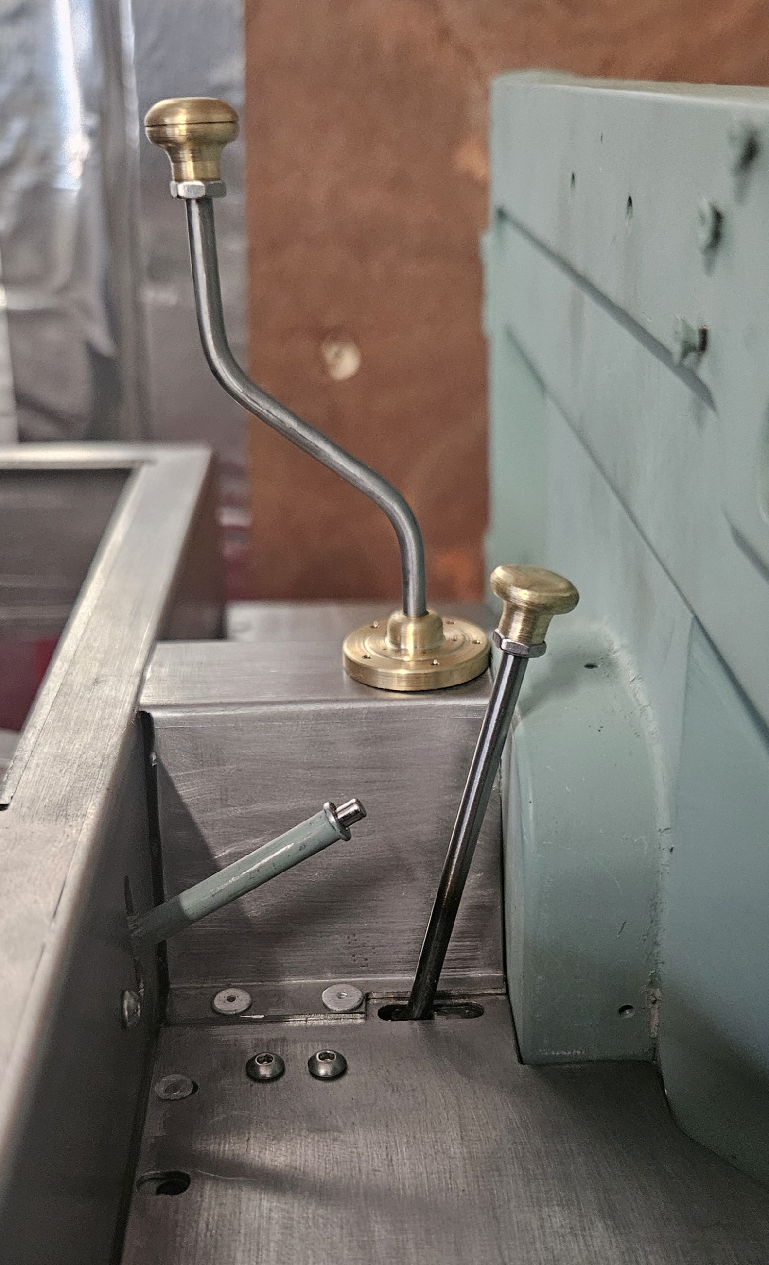

Re: KIT No. 98 BUILD

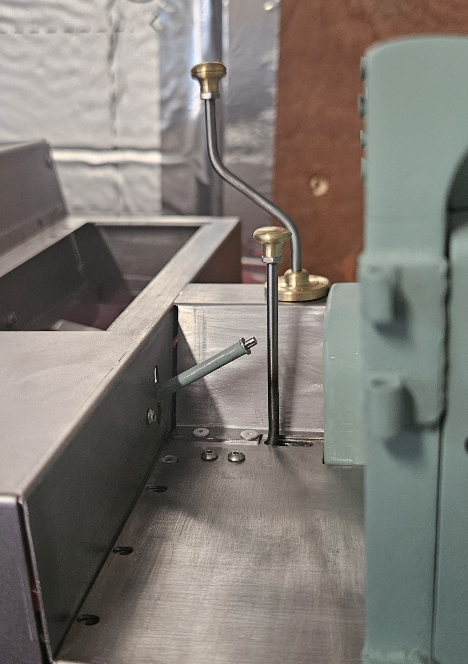

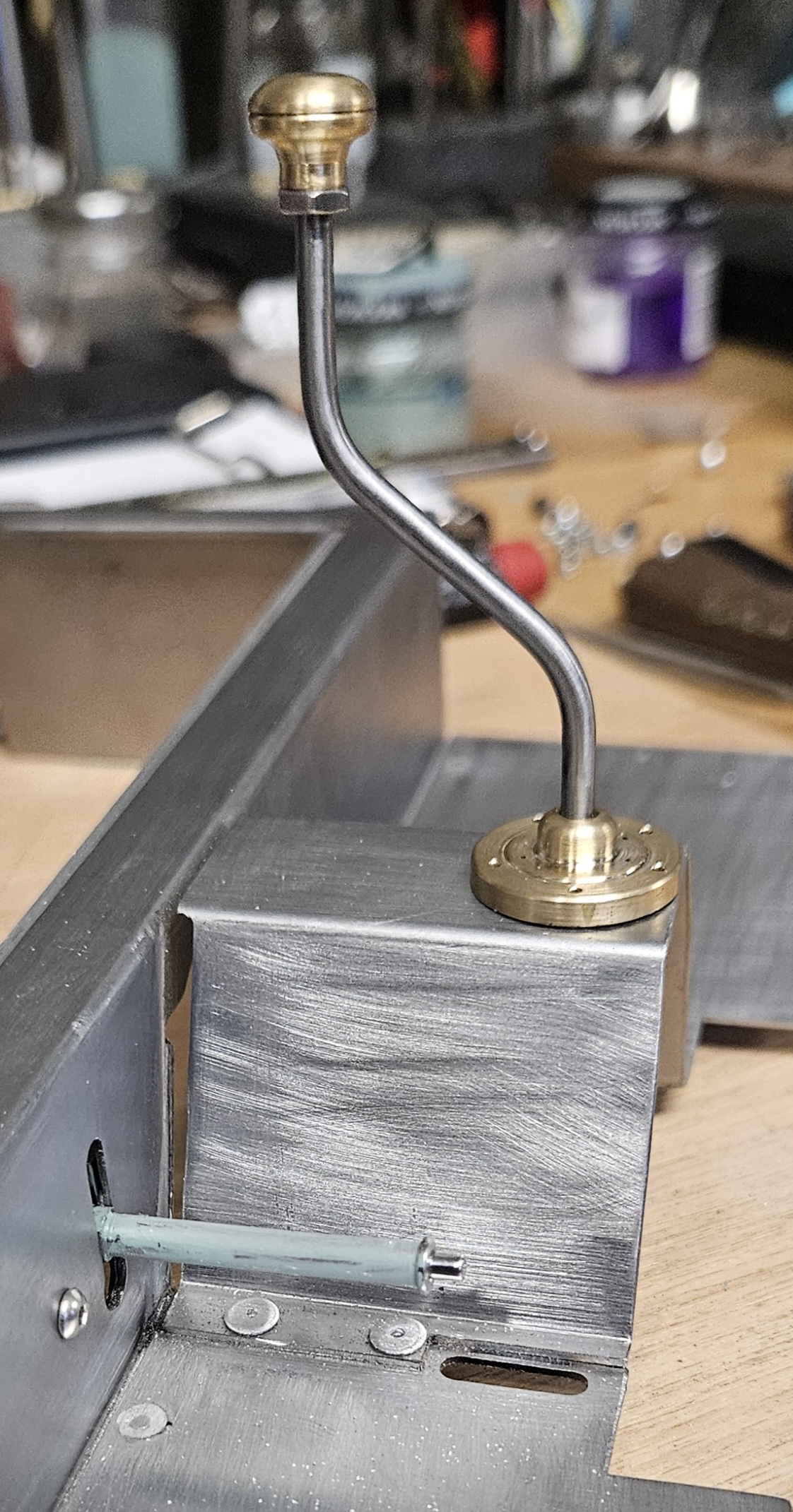

This is the new gear change lever and base, there are a few different designs on the various models.
I like the look of this one so chose to do it on mine.

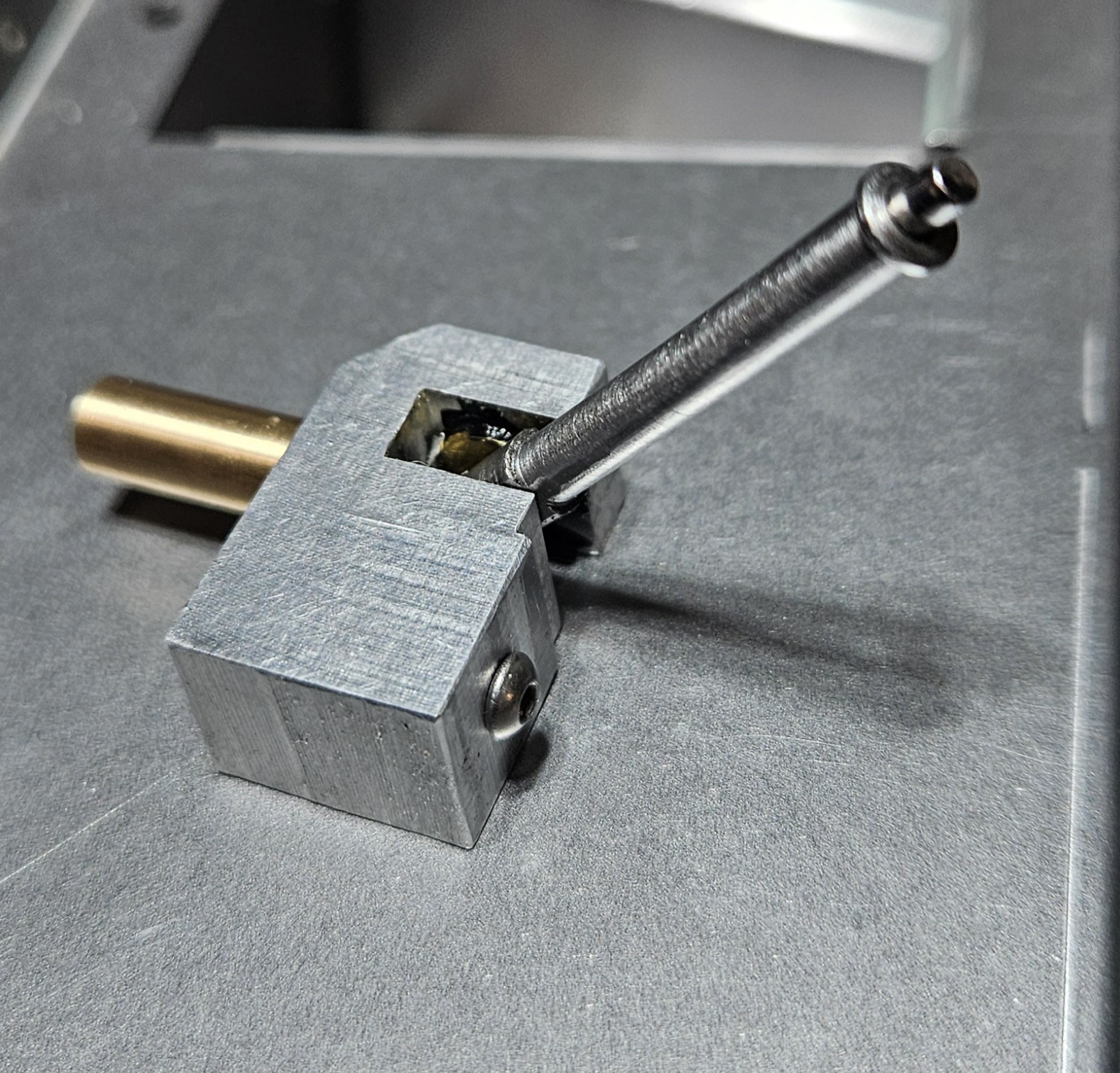

Continuing with the controls I made the high, low range
Lever in a similar way to the others.
I made an alloy base for it to pivot in and hopefully carry a microswitch to activate the electrical system.

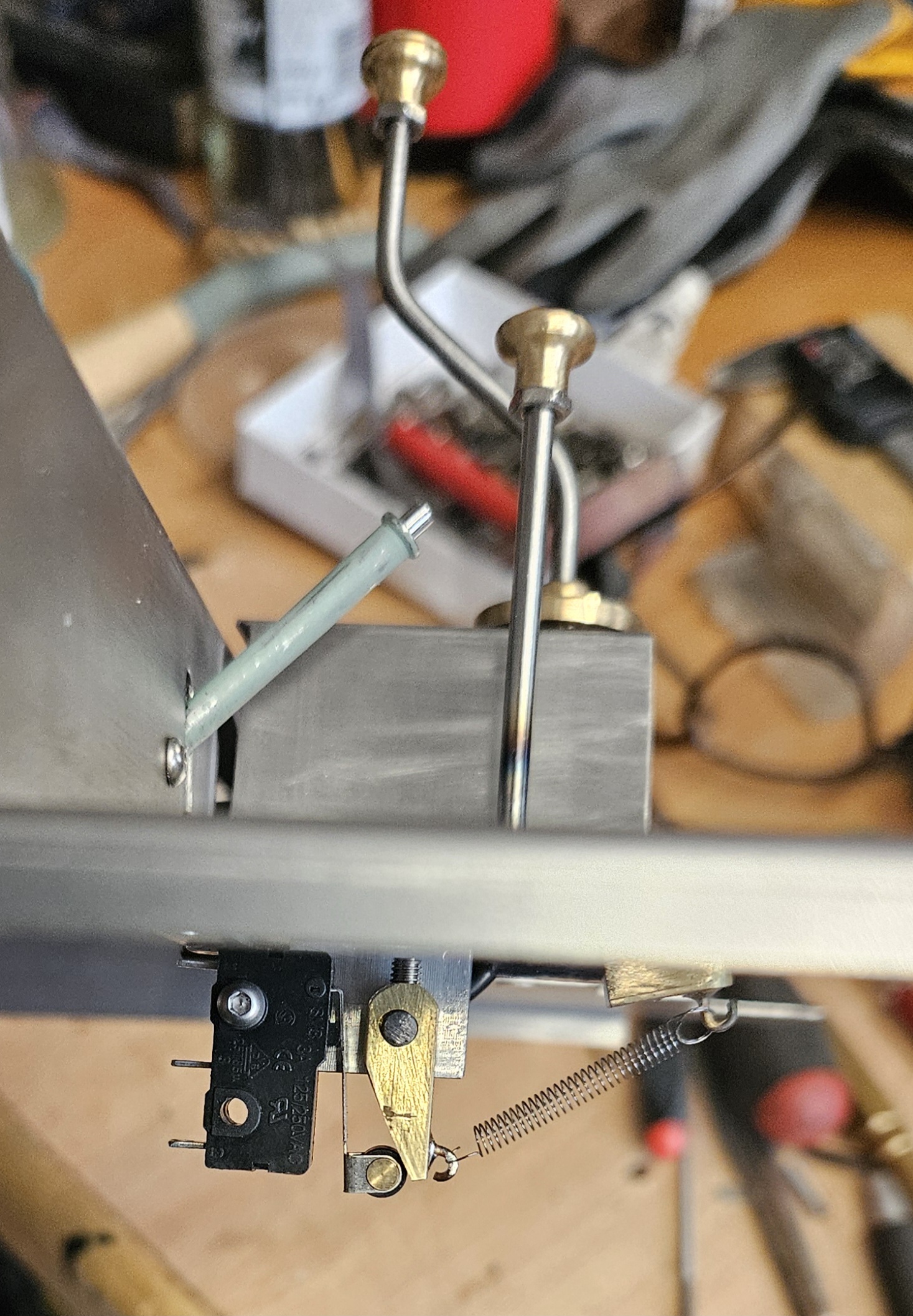

I thought about Charles idea to power the electrics using the hand brake. Having already done that assembly I decided to use the Hi-Low range lever instead.
Fitting a microswitch and return spring was relatively easy. But I needed a way to keep the switch in the off position when the model is static.
So I set a magnet into the gearbox housing to retain the lever in the forward position, then spring tension holds the switch on for running.

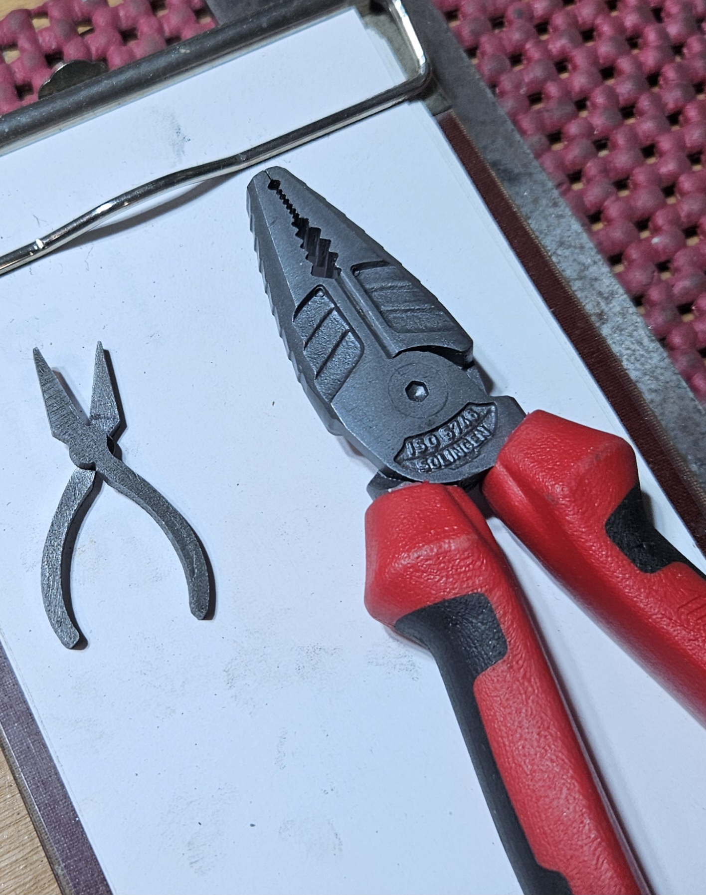

Getting to the point of painting i decided to avoid it for a while and step back to my hand tools.
I thought a pair of pliers might be a fun project to have a go at.
So, a square bar of CCI was sliced into a 7mm thick slab and half of a pair of pliers was drawn on it.
Roughly cut out with a hacksaw then shaped with needle files.
When I was happy with the profile I cut the part in two with a junior hacksaw to give me two identical pieces.
I'm now at that point and looking at how to machine the pivot point on each piece to create a functioning tool.

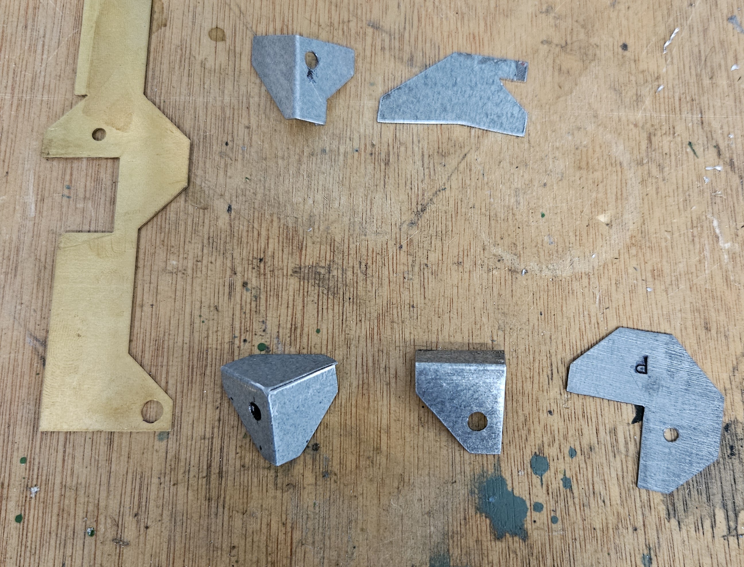

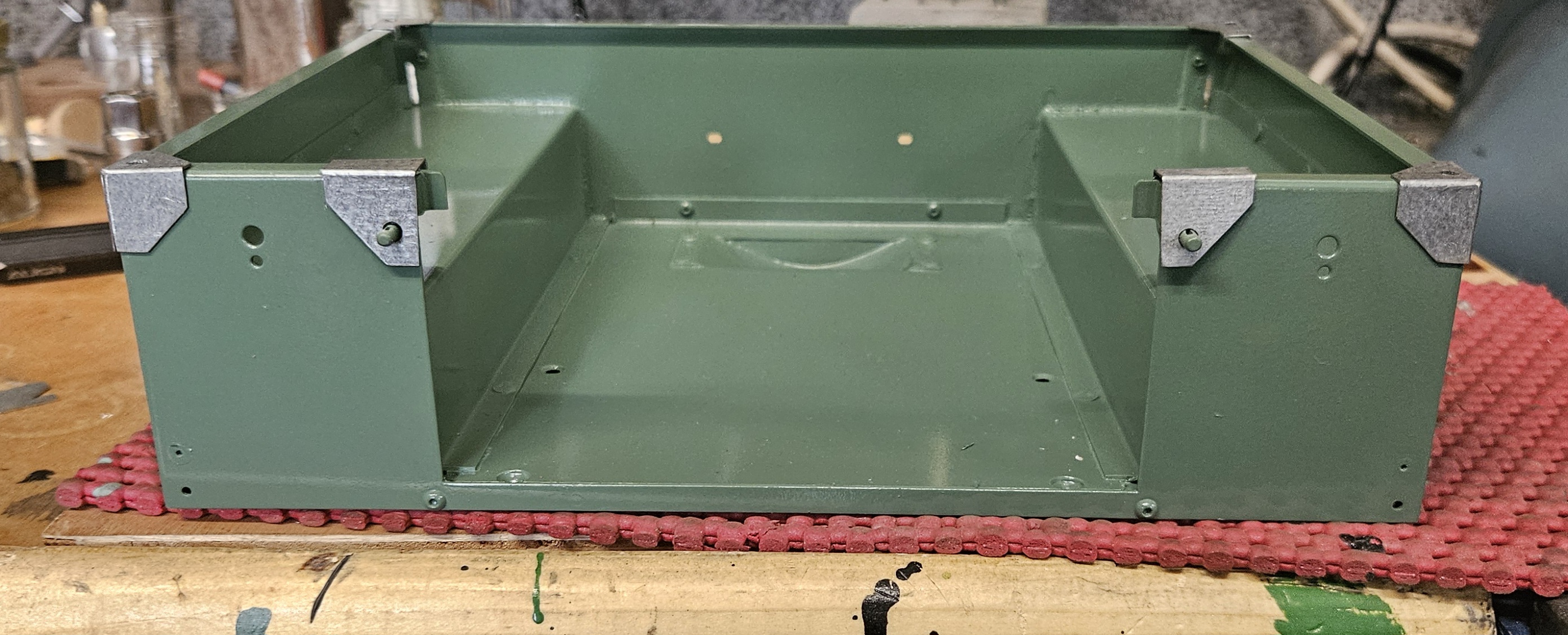

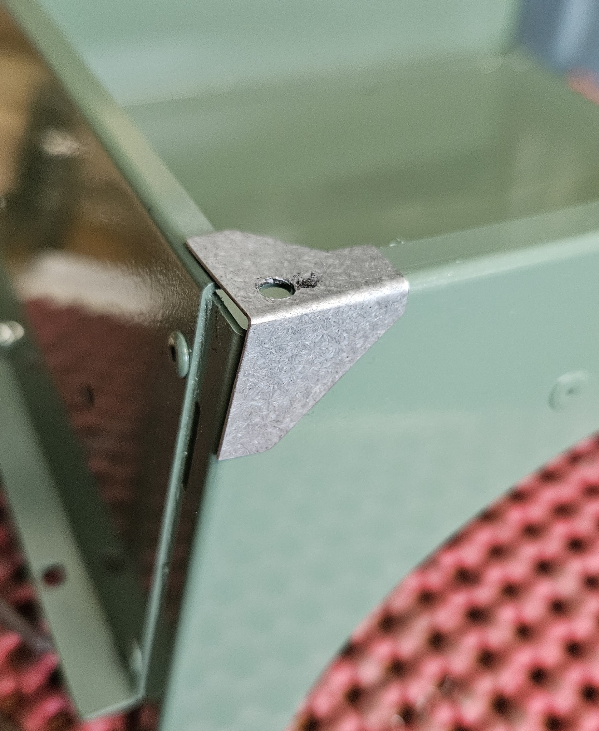

Back to some tin work.
I have had the body panels capping on my radar for a while. I don't like the brass fret so I decided to redo the metalwork in galvanised steel.
Rather than try to do the whole thing in one piece I made separate corner and end caps.
Now I just need to make lengths of U section to run between each cap.
