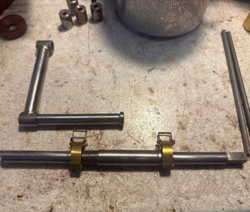

A quick question. What as the size and diameter of the roll pins you used for the swing arms. My T1 is boxed still but I want to have the roll pins ready.

Hi Chris,
thank you for your nice words.
The diameter of the pins is 2,5mm and the lenght is 18mm.
Regards Martin

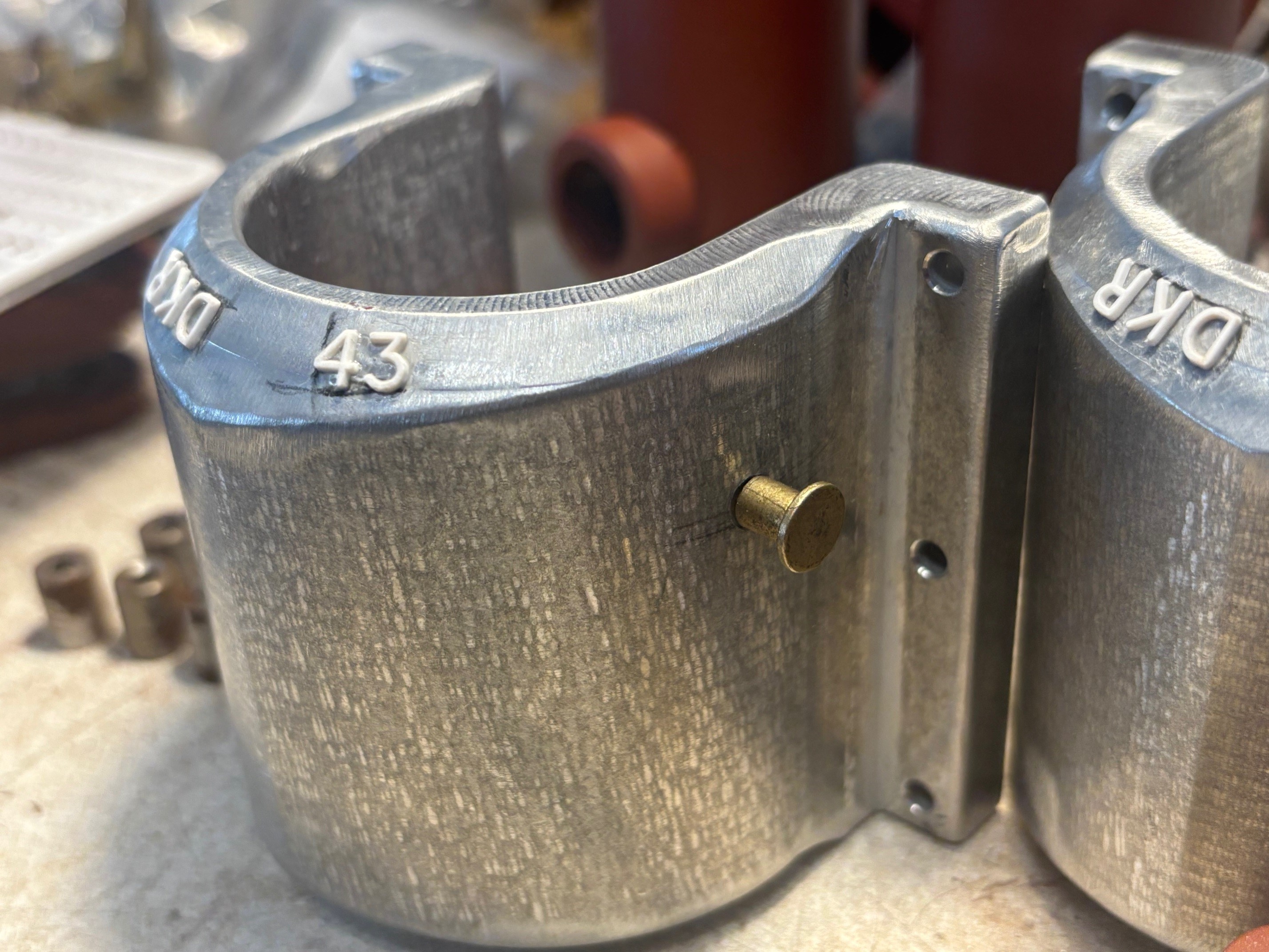

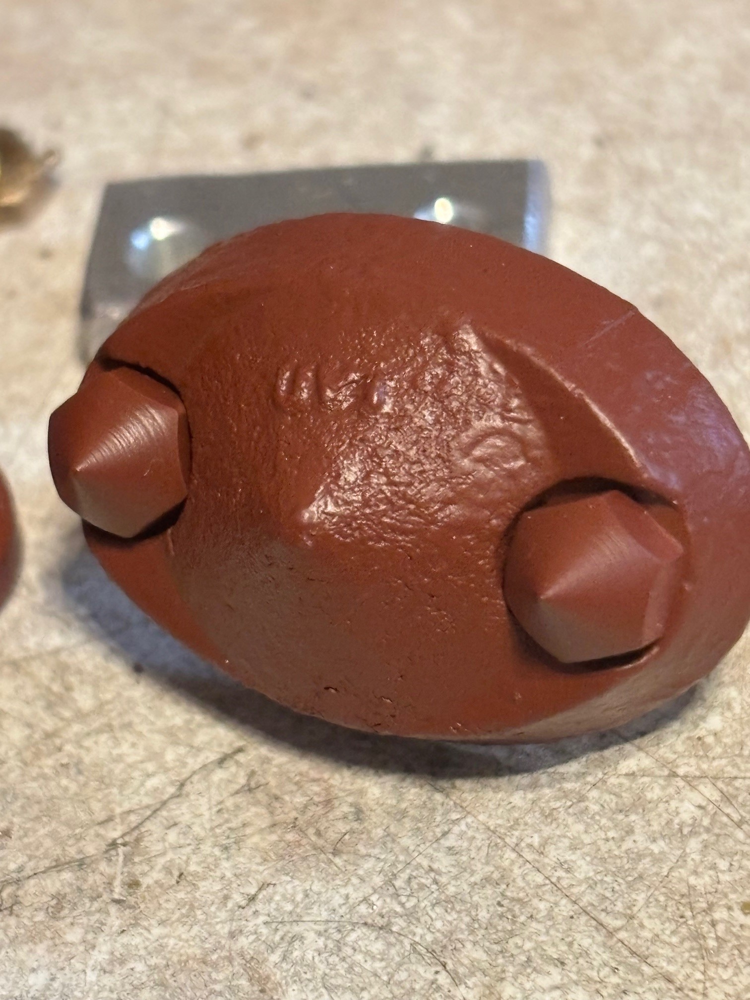

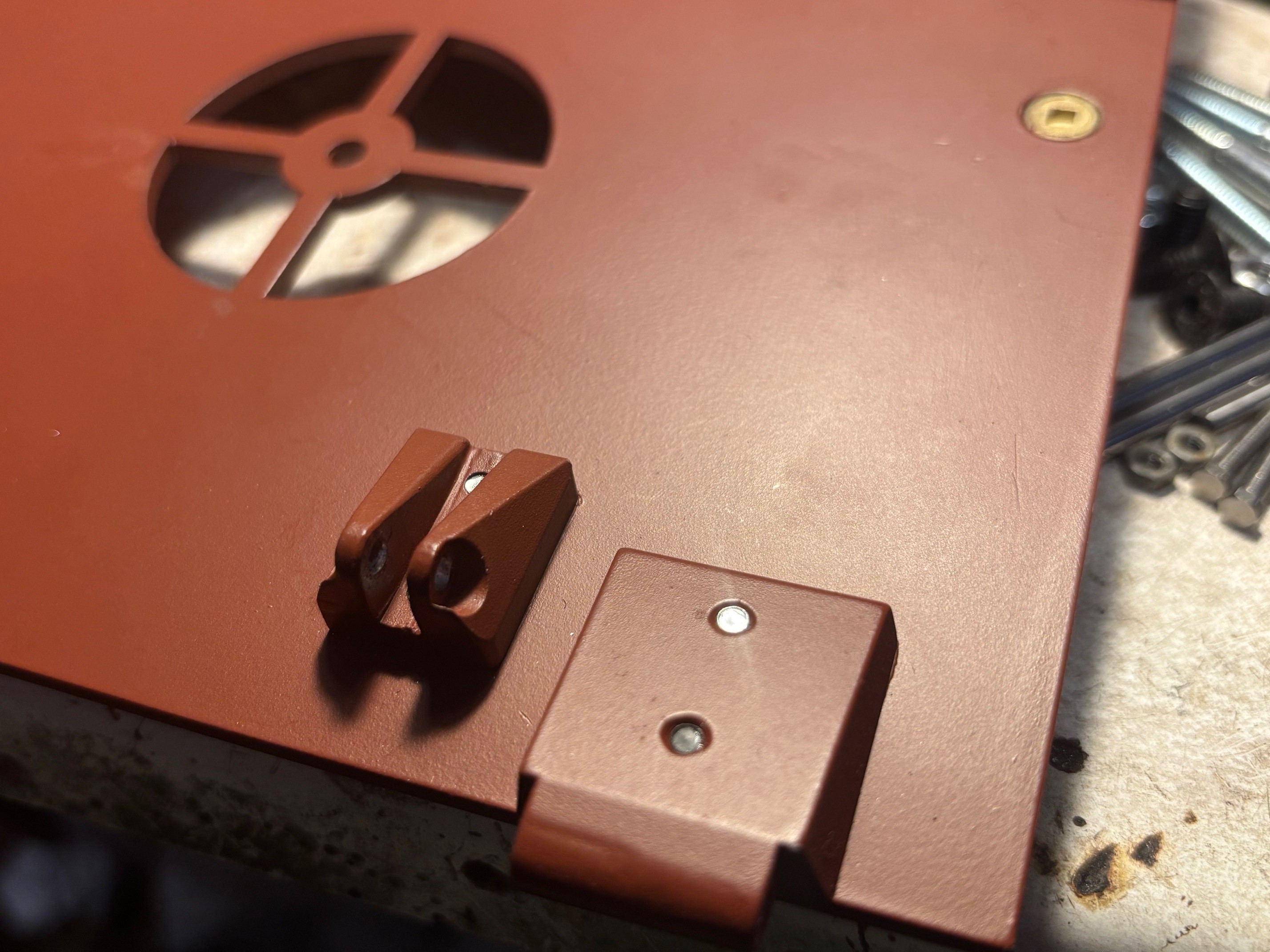

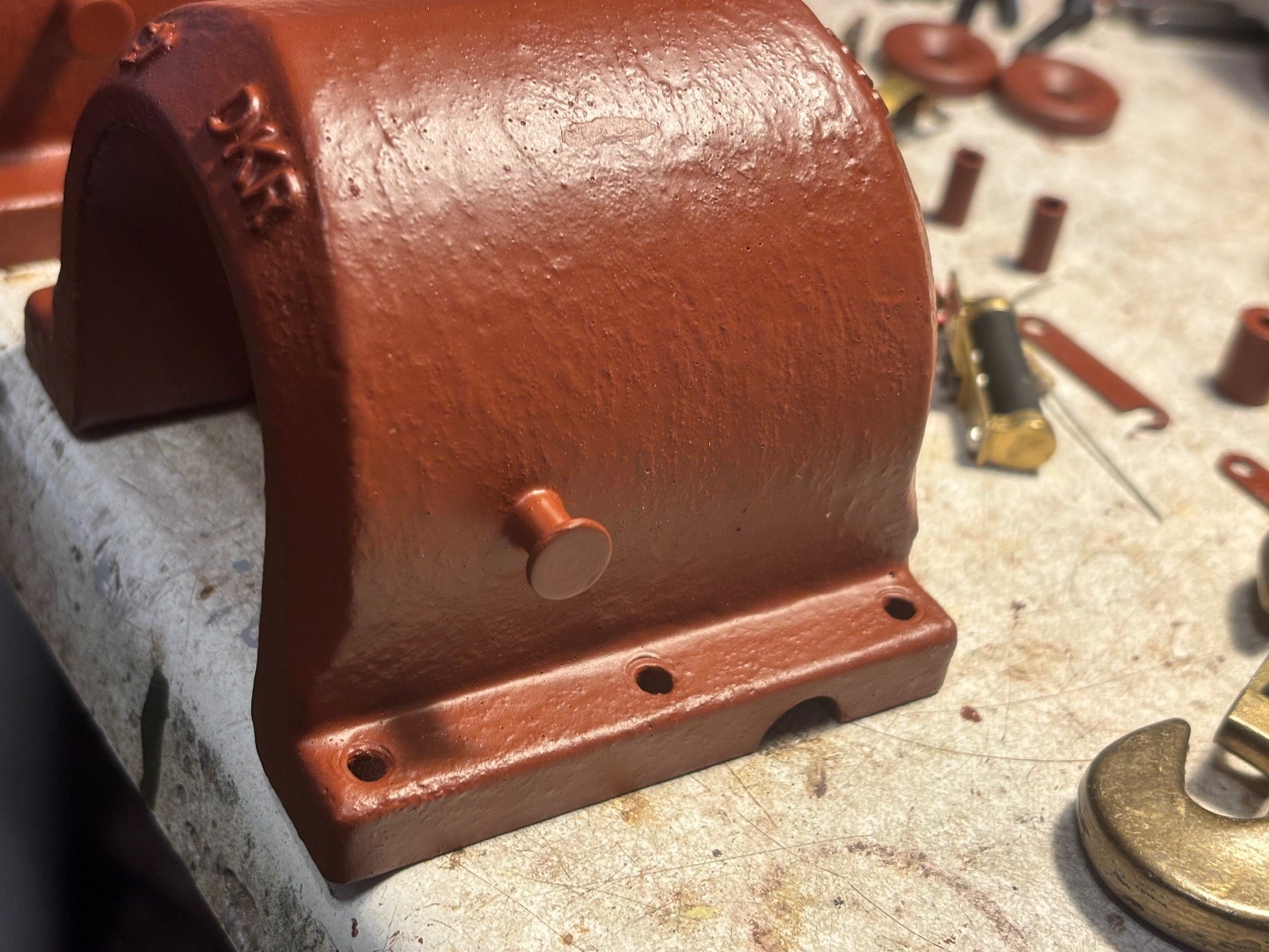

Here comes some small update. I made some parts of the back side of the Sturmtiger.
The starter plate with the starter, the armoured covers of the exhausts and all their casting numbers and the casting surfaces are done.
Regards Martin

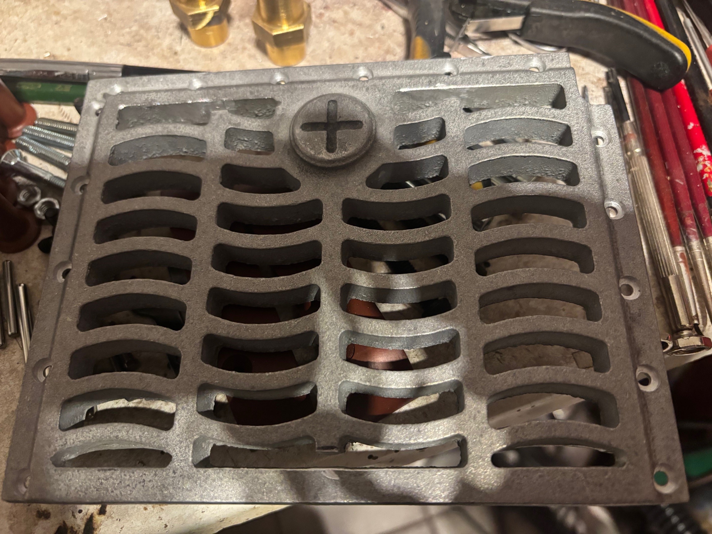

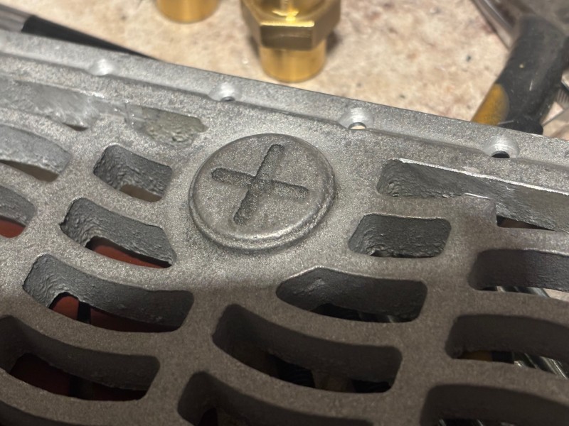

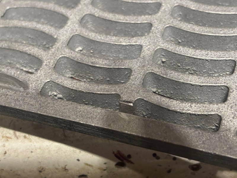

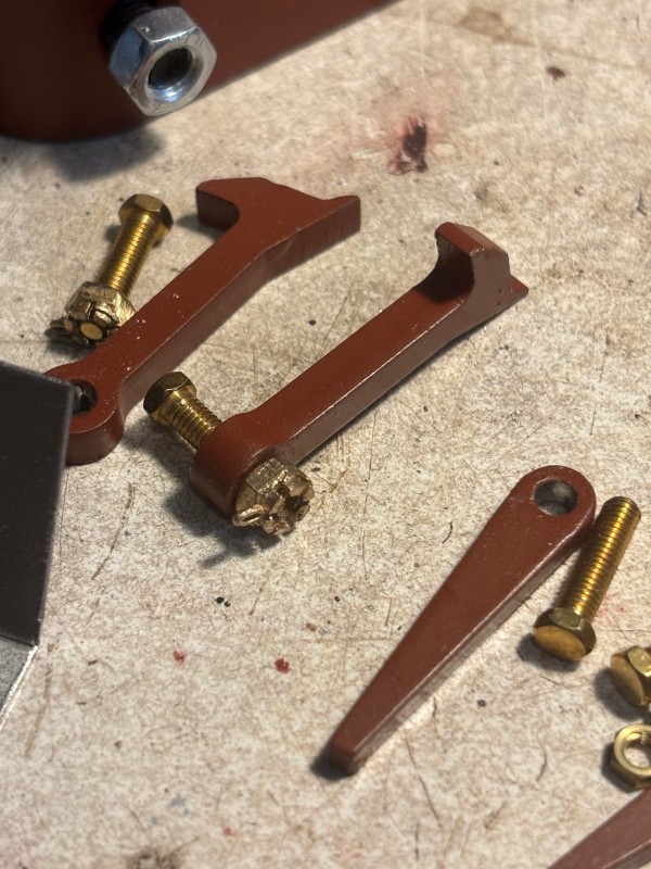

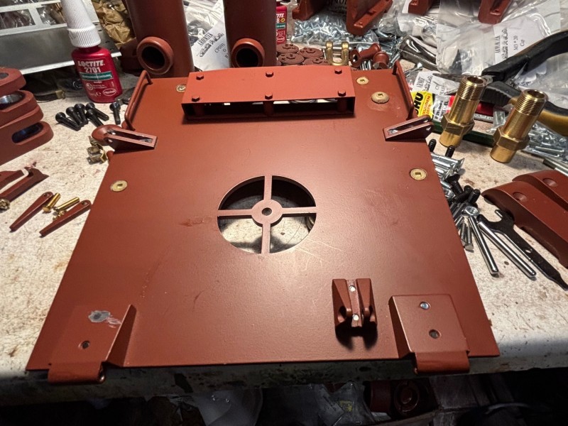

Here are some more photos from the last built from the motor plate and all the gratings above.
Regards Martin
