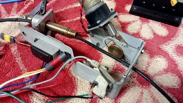

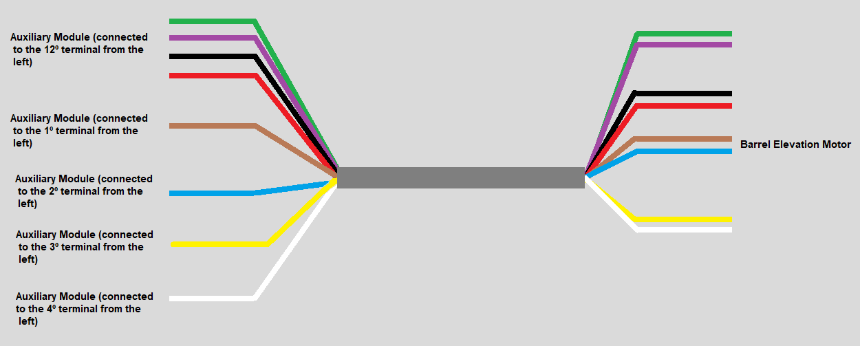

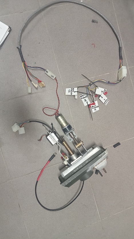

I have reached a point in the recovery of my Centurion where I cannot move forward. I connot figure out were the electronics that connect to the tower components fit and I do not have the instructions for this. also the cables were damaged when I bought it. I managed to figure out where the barrel elevation motor connects but I am completely lost to the rest. Can someone please help me? I´m attaching a diagram and photos of the mess I have ahead.
Thanks you very much.
Posts: 5119
Has liked: 1475 times
Been liked: 1674 times
Re: Problem with the electronics of my Centurion (I need urgent help)
The Blue/Brown pair go to the elevation motor as you have it.
The White/Yellow pair are a relic from the 12 gauge blank firer and aren't used in the Centurion.
The Green/Purple and Black/Red pairs go to the limit switches. I'll see if I can find a wiring loom with them attached but don't have anything to hand at present.

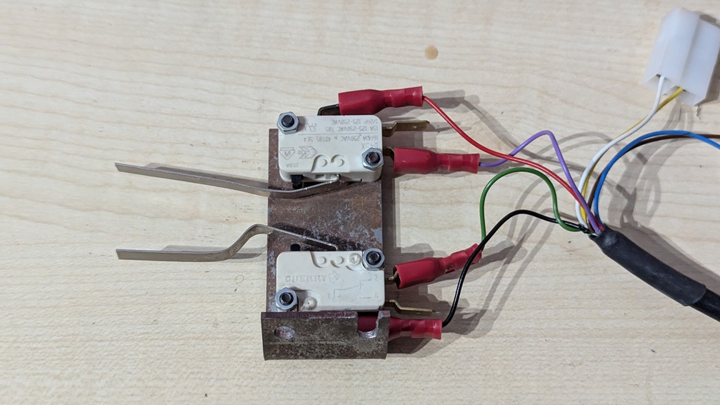

Finally found one with the right colours :D .
At some point they started using a multicore with all black cabling :roll:
This is a from a Panzer III, so the lower switch is next to the mounting flange.
The upper switch has the red wire connected to the common terminal and the purple wire on the Normally Closed (NC) terminal.
The lower switch has the black wire on the common terminal and the green wire on the NC terminal.

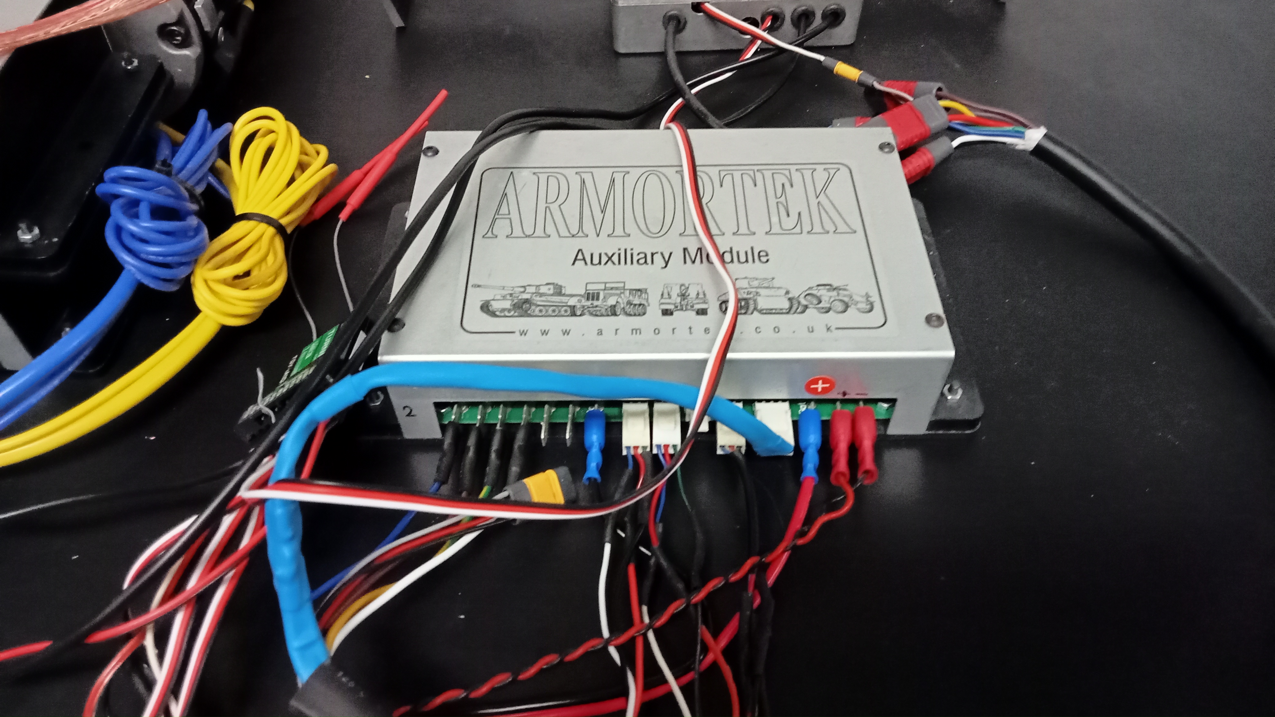

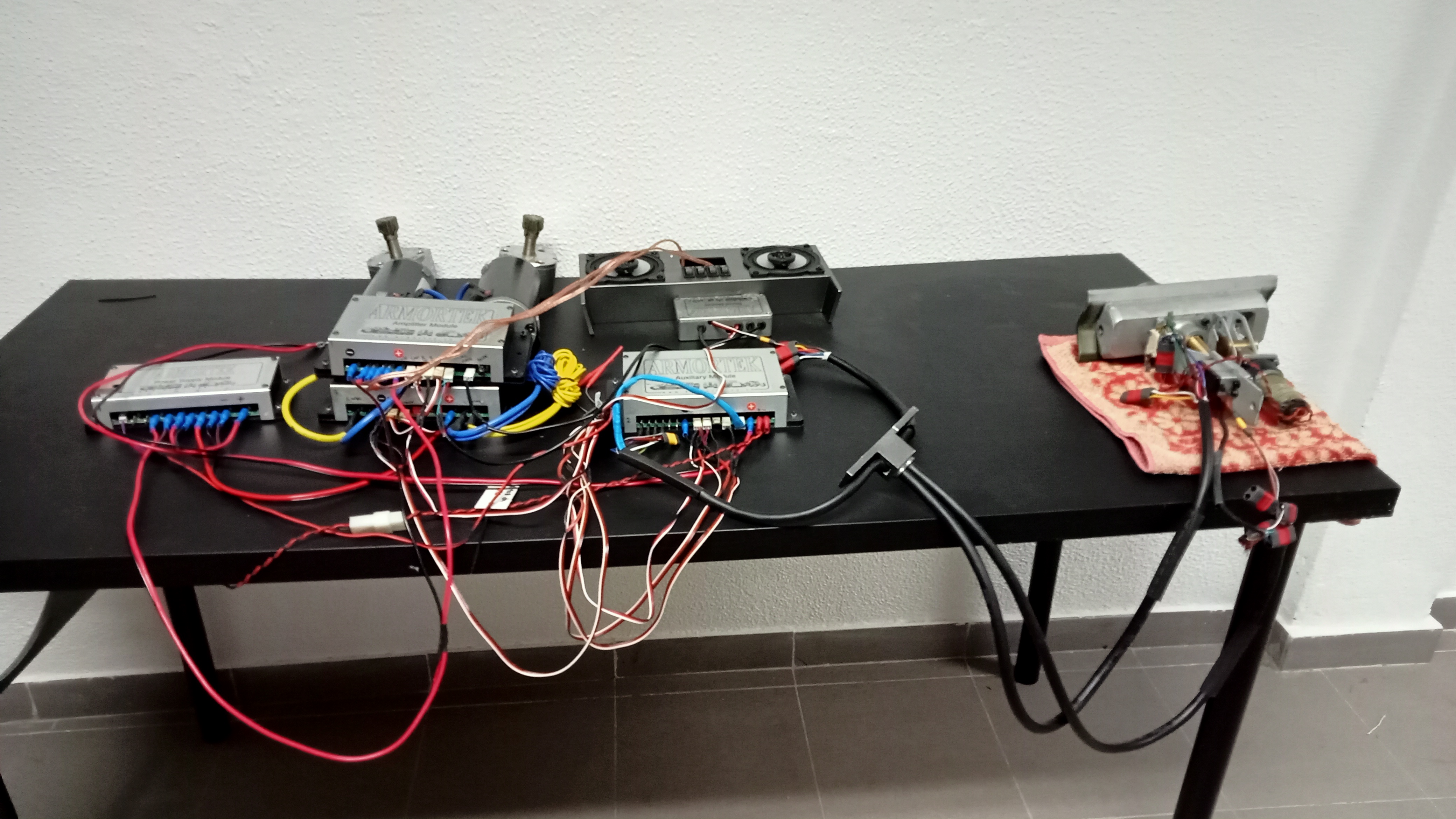

Well, I think I've reached a point of no return and I'm really going to need assistance. I've already redid all the wiring twice and I can't get past from here. The movement of the wheels, the movement of rotating the turret and the movement of gun elevation works perfectly
I cannot have any sound (I hear the initial three beeps but it doesn't go from there) and I don't have recoil or flash (but the servo recoils when I restart the modules to its initial position).
I think the problem probably is on the recoil and amplifier module.
I already did as instructed and pressed the small button on the sound module, but without any changes. Do anyone know who can repair these modules or in a more extreme situation, is there a way to replace all this electronics, is there an alternative on the market?
Thank you very much

Hi
The saga of the faulty modules continues. I have already sent them to Armortek, and they have already returned them with two new modules that the company said would replace the faulty ones, but the problem persists. I now have sound in the channel 5 (that was fixed), but when I activate channel 6 to fire, I have no movement of the recoil servo, no sound or flash. In addition, I now have a new problem, the gun elevation motor only works in one direction (downward).
Could anyone please help me check if I have the connections made correctly? I made a small diagram of how I did the installation. I appreciate the help, I must be missing something.
