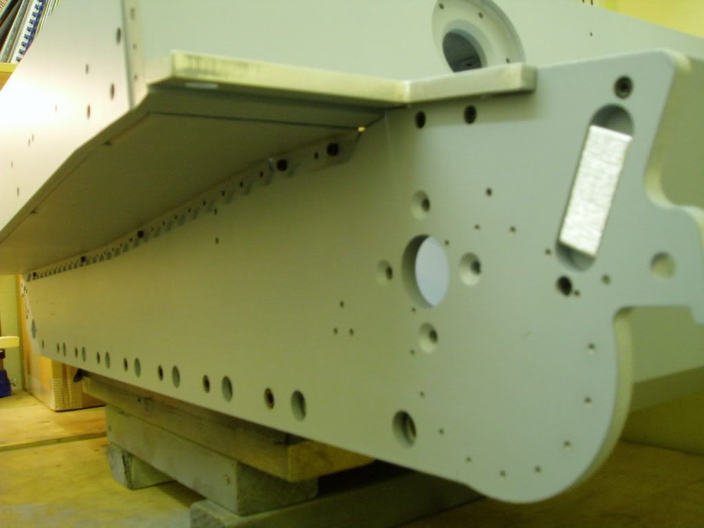

Just started the build of my late tiger so thought i would post a couple of photos.
Hopefully i will remember to take more as the build progresses

Looks great, Keep the pics coming. Cant wait to start mine.

Excellent! Looks super. Thanks for posting the pictures. Like Jim, I can't wait to start mine. Just as your Panther was, your Tiger will be great reference for the rest of us.

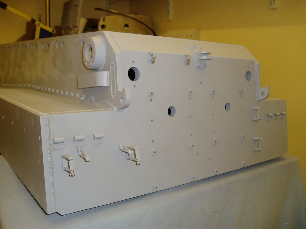

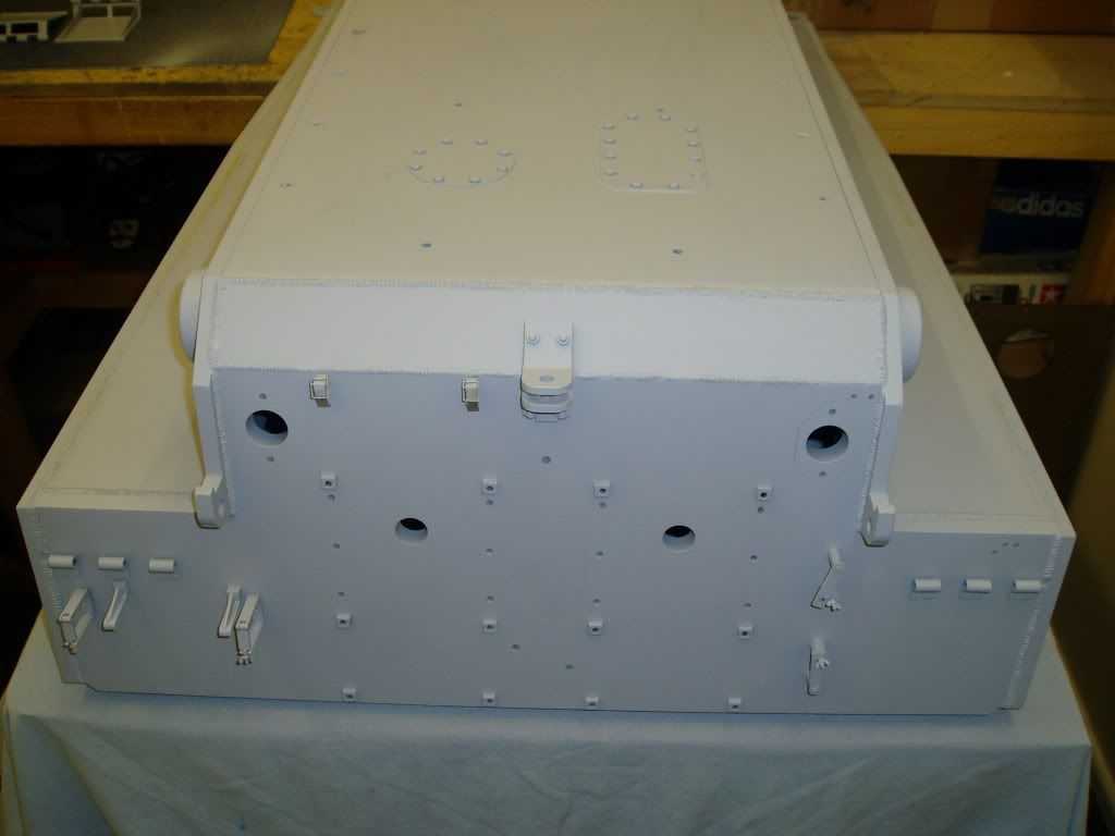

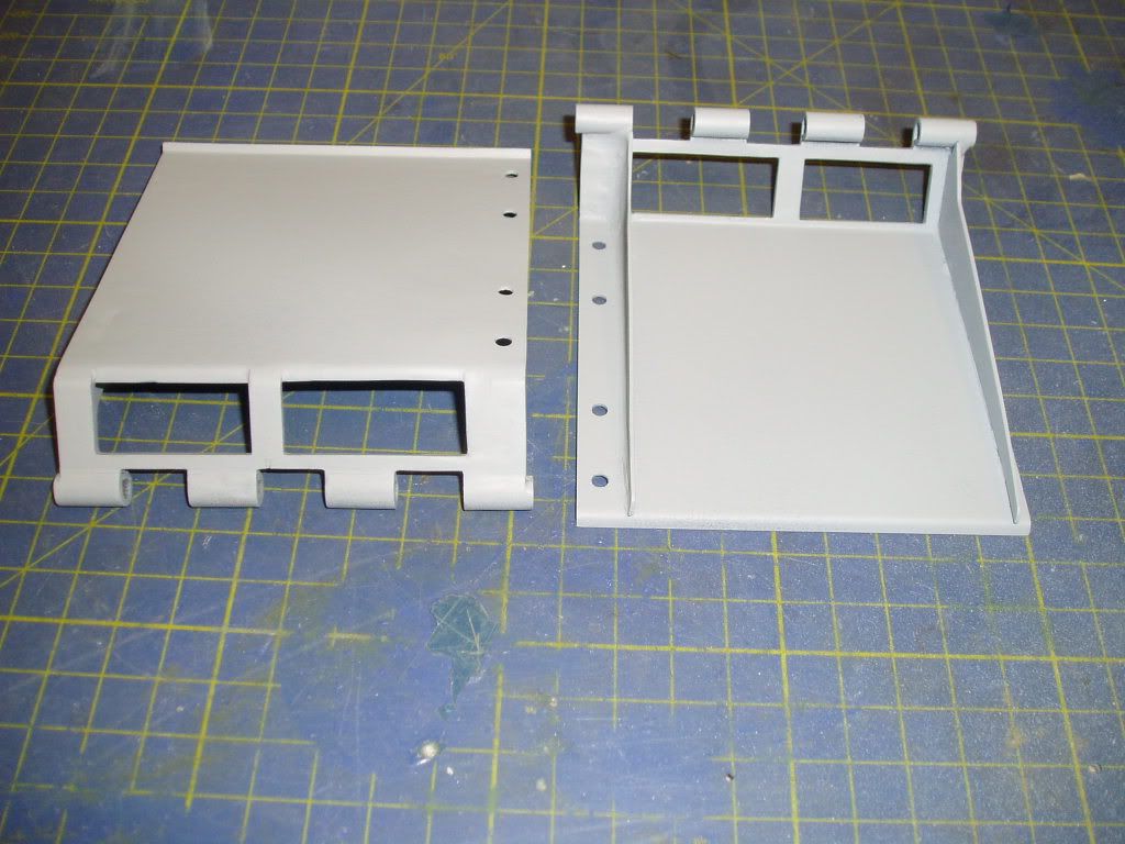

I have not posted any updates on my Tiger for a while due to being fully occupied on a training course at work, Well thats now completed and its back to full production :D .
Heres a couple of shots of the rear plate with variouse mods and additions added plus a shot of my modified rear mud gaurds.
Hope you like

Your Tiger is looking outstanding. I have a question - is the hitch on the back a Armortek part? I have a very early kit and it have a very plain hitch. I and have been looking for a hitch like the one you have pictured. I know Vince us to make them but not anymore. Did you make it yourself?

Are the small bolted plates on the bottom of the hull included or did you make those? Likewise the hitch? Great looking details!

Excellent Steve! I was looking forward to your next post. Everything looks GREAT! I had the same question as everyone else on the hitch. Is that the supplied one?

1, The tow hitch is the one supplied with the kit, all i did was add the lower section and blend it in with some filler. note the attachment bolts are put in the opposite way round to the instructions.
2,The rectangular plate on the bottom of the hull was made out of some sheet steel, the attachment bolt pattern is not quite correct as i decided to pick up some of the existing holes from the supplied round access panel.
The other major item that i changed was the mudguards and their mounts, these are supplied as early/mid versions and are not correct for a late Tiger. To change them i found some steel door hinges of the correct size at my local hardware store, cut them ot shape and brazed them to the supplied mudgaurd. I then cut new ribs and brazed these in position. the fixed parts of the hinges are again from the same door hinges, cut to shape and bolted to the rear plate.

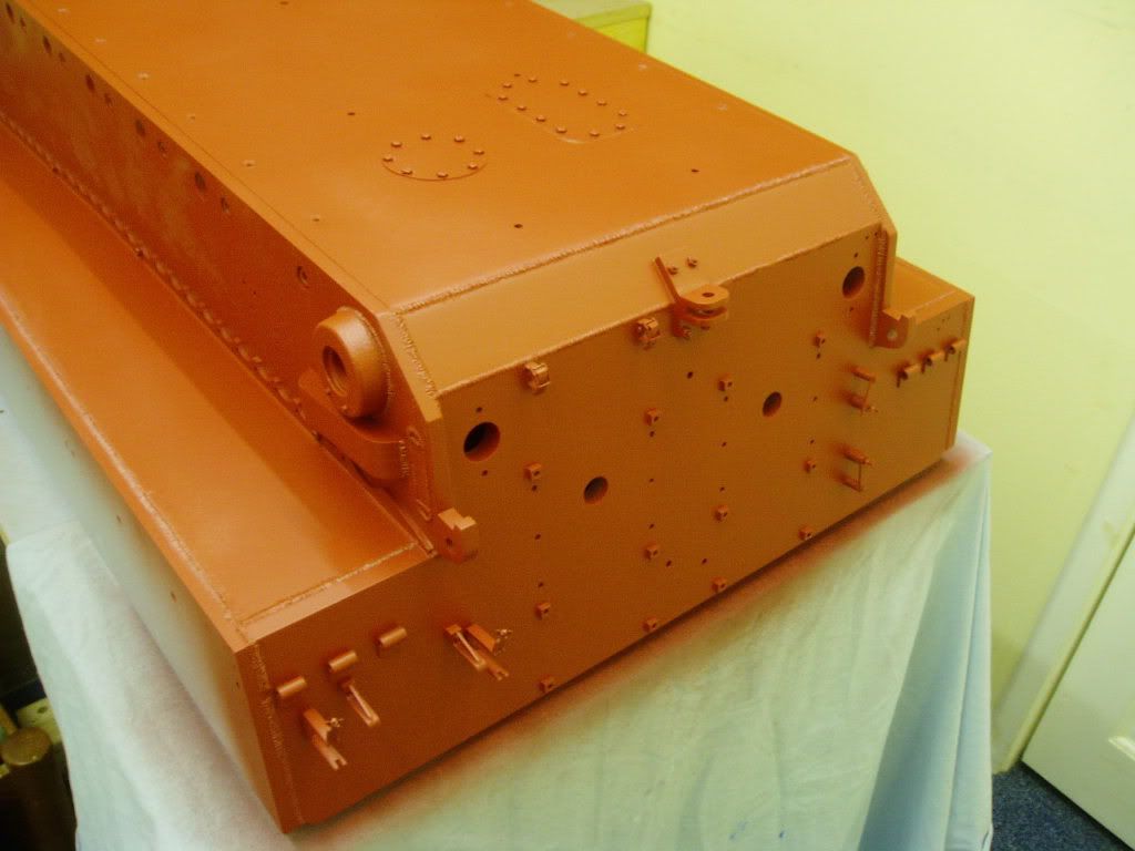

Next job is the zimmerit :shock:

And nice move to change that round plate to the for Late Tigers accurate square one.
One minor thing...
The rear mudguards was not mirrored but made the same due to simplify production. So the holes were the same on both sides.
An easy but well visible change - go for it!

Kent i will see what i can do to change right gaurd, by the way thats a good photo of the rear plate which will help me with the zimmerit application.
