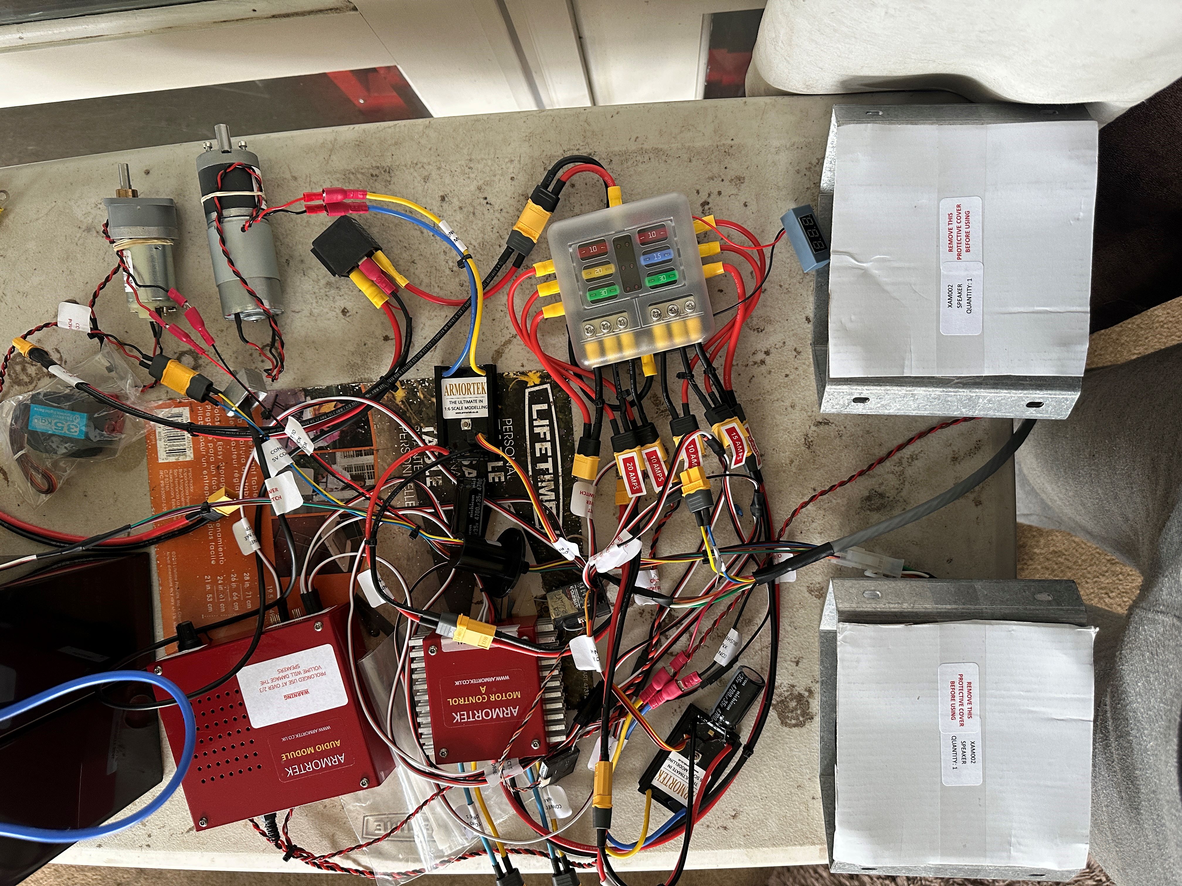

Hi
I am setting up the option pack on the bench before installing, could anyone please advise what connects into which Amps socket
I have already plugged Motor control A into the 30Amps as advised
1) Which socket should be turret and elevation, which is on a Y connection
2) Sound module
3) 24v to 5v converter (recoil module)
4) Smoke
Many thanks

Re: New power option pack setup
In the Churchill instructions, the elevation and traverse goes to a 15A socket, the Audio Module goes to a 10A, the recoil goes to a 10A socket and the smoker goes to a 20A socket.
