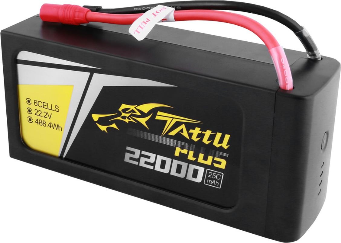

Has anybody tried a LiPo 6S accupack like the Tattu plus 6S1P 22'000mAh by GensAce? I'll try to upload a pic ... please forgive me as it's my first time on this forum ...
Best regards, Andre

Have a read through this Knowledge Base article that Stephen wrote - it will provide you with some good insight:Andre Meylan wrote: ↑Mon Aug 19, 2024 6:17 pmHi there,
Best regards, Andre
Armotrk Forum - Knowledge Base - Batteries
Unless you are very confident in what you are doing I would not recommend LiPo at all.
As off this year our electronics are capable of running on fully charged 24V LiFePO4 batteries. That said, because of high regenerative current loads I recommend only charging to 90% - which will still give you a very long running time with LiFePO4.
If you have any other questions then post them here as I am sure this information is of use to the wider community.
Kian

Dear Kian,
thank you very much indeed for the link to the knowledge base article - a very wise description of handling LiPo's.
I use LiPo's since 20 years in RC helicopters, jets, cars and race boats, up to 12S and with C rates beyond 65C (in boats). So far, I haven't BBQ'ed my fingers or a model. But I will carefully evaluate when building my Leopard.
Can't wait to get it by tomorrow afternoon !!!
Best regards, Andre (from Switzerland)
