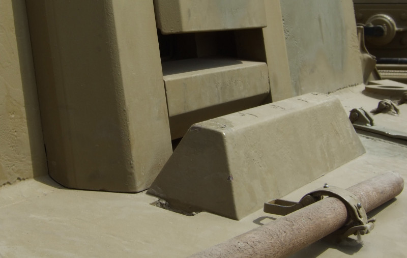

Hi Donald,
Try this image of 131 taken at the Tank Museum.... It clearly shows that the steeper face is to the rear.
Alastair
Alastair
Alastair

Re: Tiger 1 Driver Armour front shield question?
Hi Alastair
That would also match the Samurai tiger photos i have,clearly this is a mistake in the 2021 Late Tiger build manual,as i had mine round the wrong way,but have corrected it now
i also see other builders have this round the wrong way,if there is a wrong way?
Again i have checked Modelers guide to the Tiger Tank and it has the Armour round the shallow way to the Driver
i am really confused now.
thanks
Donald
thanks
Donald
It very much depends on the angle from which the picture was taken. These were taken at TankFest a few years ago:
Symmetrical:
Asymmetrical:
Symmetrical:
Asymmetrical:
Hi
In my opinion a side-on view gives the best indication. I decided to copy Tiger 131 as the F01 Wanne was produced quite soon afterwards. Remember that the item is not welded but affixed with five taper-head bolts. So it is conceivable that both options were fielded or the shield was switched round following its replacement or maintenance action.
Alastair
Alastair
Alastair
As shown in Adrian's two photos, that armor is located in a groove in the glacis. If one looks at the bottom photo it seems obvious that because of that locating groove it is physically impossible to fit it the other way round.
Well done, Vince... I did not spot that! Can't see for looking
. I should have remembered this as I have replicated the groove.
Alastair
Alastair
Alastair
