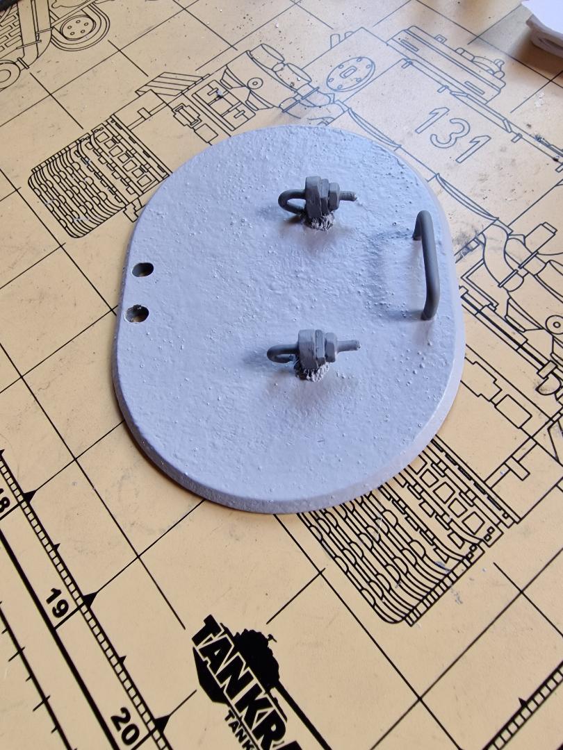

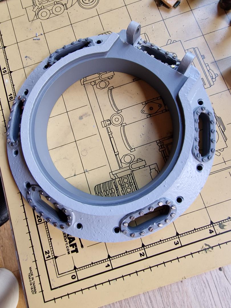

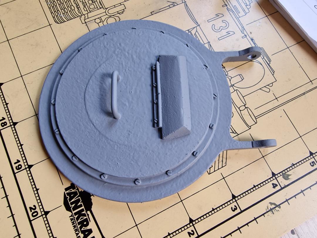

Been attempting some detailing on commanders cupola / hatch and loaders hatch. Access to hand tools and Dremel only so limited as to what I can achieve. Hopefully not too bad.

Nice details.
Just curiosity : The Tiger 1 line drawing underneath, is simply a large printed paper, or a PVC Cutting Mat?

Chang wrote:
Mon Aug 22, 2022 7:36 am
Nice details.
Lerh Chang
Hi,
its a large cutting mat. I got it from Bovington Tank Museum online shop.

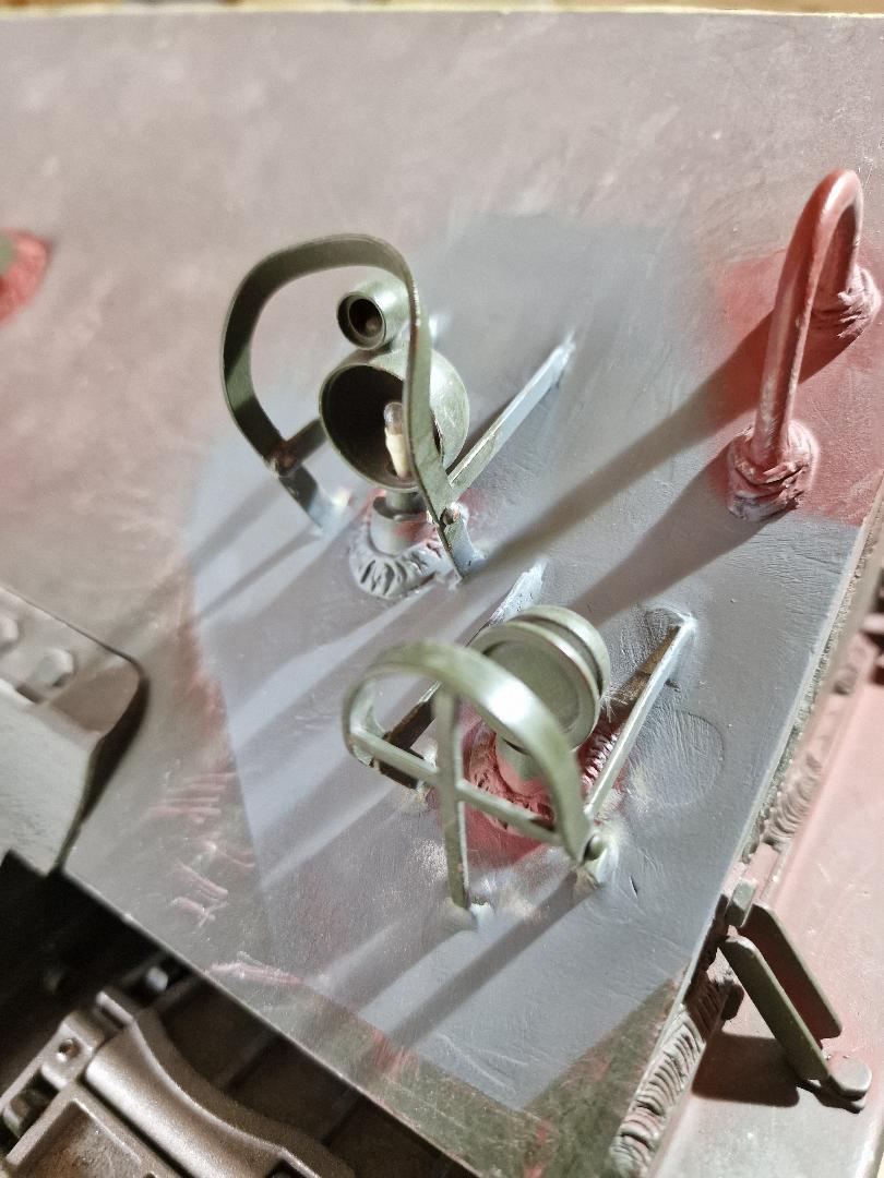

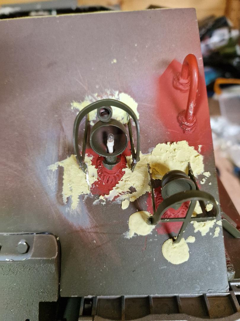

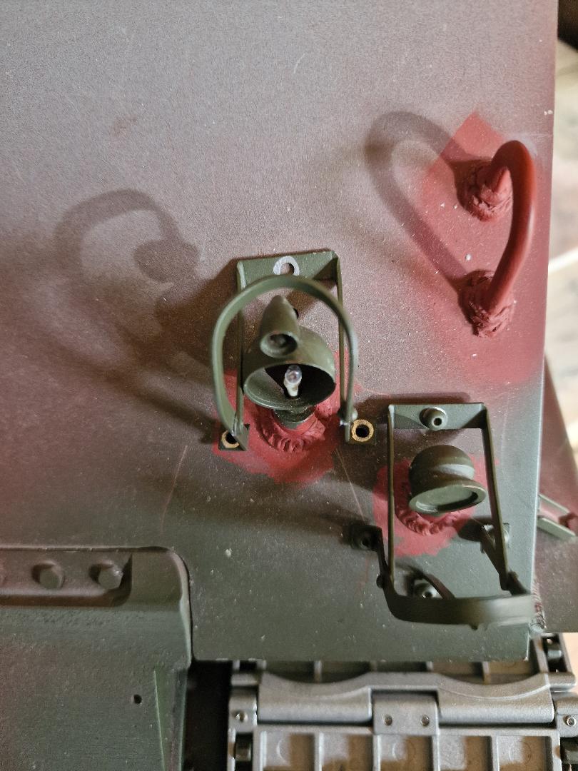

Been lagging a bit on the build, but back into it now. Decided I didn't like the front light guards attached with external fixings. So drilled into the plate to recess the bolts fixing the guards. I cut the back horizontal bar off, leaving a small amount on each leg to bend down into the drilled hole to add extra support. I then filled with milliput. Its been sanded down but still needs a bit of finishing.
Been lagging on build but started again now.
