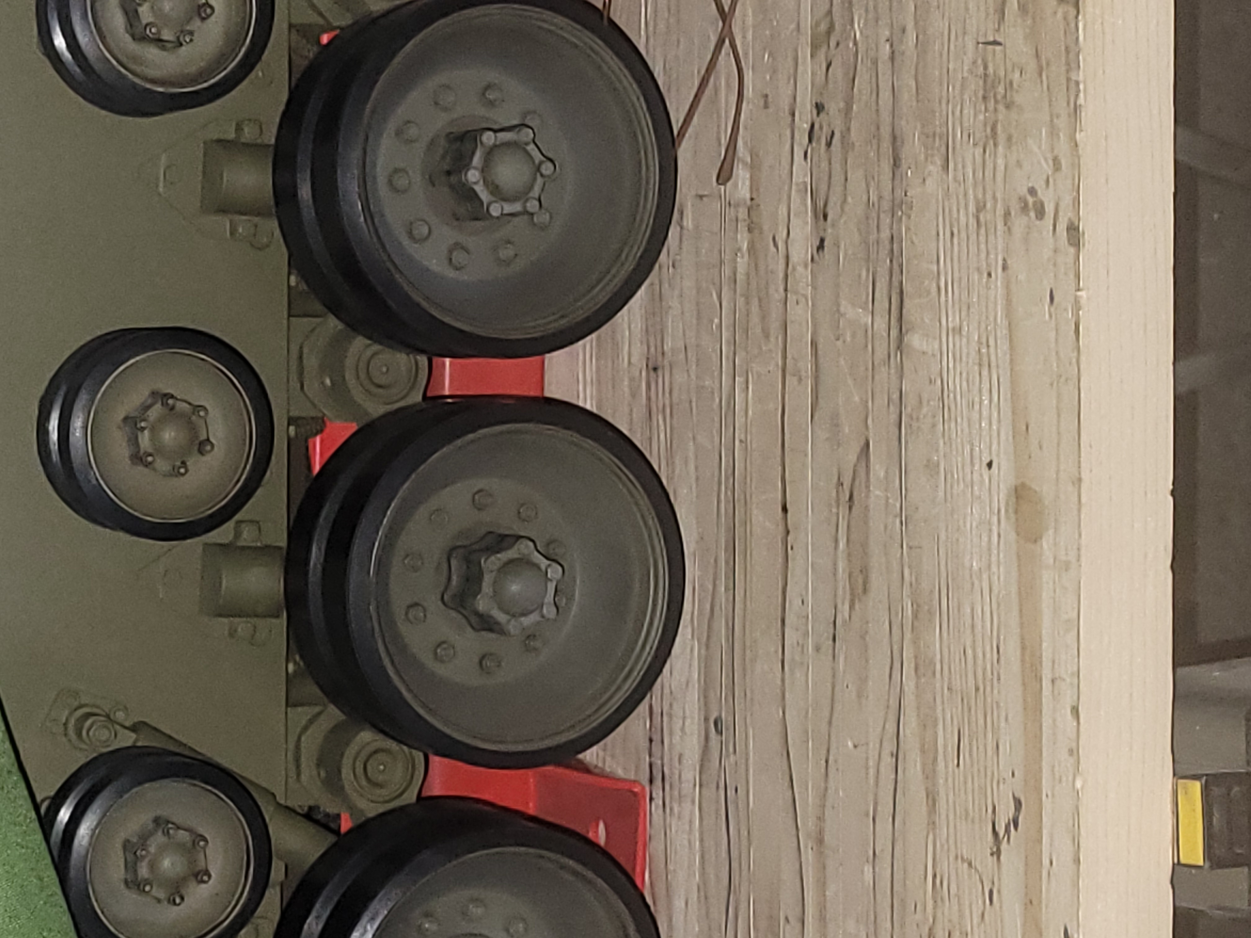

Go to duracoat firearm finishes site they have templates...stencil material for camo. I like the lab film it's a parafin wax material that stretches and adhere with a low low tack and it cuts easy or you pull it to shape. I fade the edges with my airbrush and then go with more paints to darken towards the center portion. All in all you are one the right track get some.cheap paint and practic practice. The wheels are my pershing and the Crucifix I did for my father in law who is a preacher at a local church for his Christmas present. Most videos I saw were from you tube and card board and old GI Joe figures I practiced on....weathering I use the Tamiya weathering powders you can get them on Amazon I got all the colors they had.
